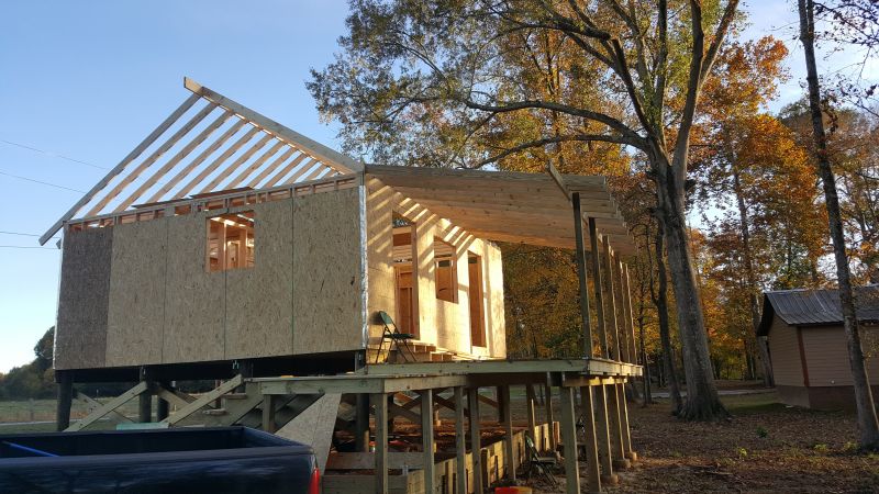

Its been a slow process but we finally got started building a few weeks ago.
Small lot on creek feeding into Tennessee River.
Building 20x24 on 16 pilings. About 5' above grade. Land slopes down from there as you approach the creek. 10' covered porch on 24' side of cabin, facing the creek.
General layout will be a 10x10 bedroom and 7x12 bath/utility on one side with the creek side being open kitchen / sitting area with creek view.
10x10 sleeping loft above bedroom/sitting area.

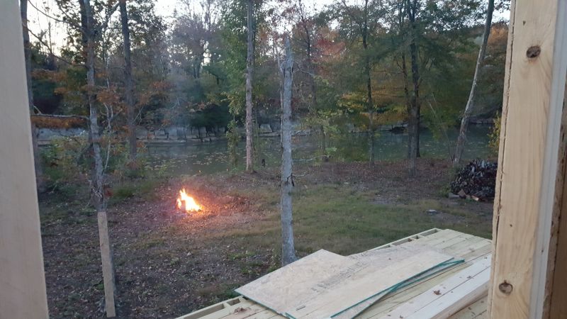

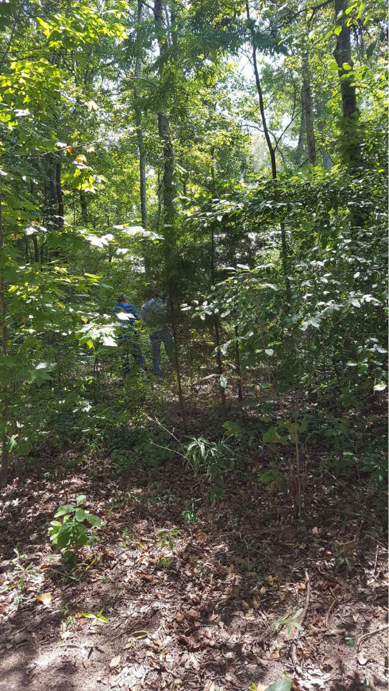

Very overgrown when we started cleaning up this past spring, but cleared now with water and electricity meters in. We are a little further along than the last pic shows, but I'm working toward the day that the camp fire view from the porch is the norm, instead of the exception.
As we found it
As we found it

Glimpse of the goal
Glimpse of the goal
fiftyfifty
# Posted: 15 Nov 2018 06:18pm
Wow, nice! What is that other building in the background?
MikeOnBear
# Posted: 17 Nov 2018 08:11pm

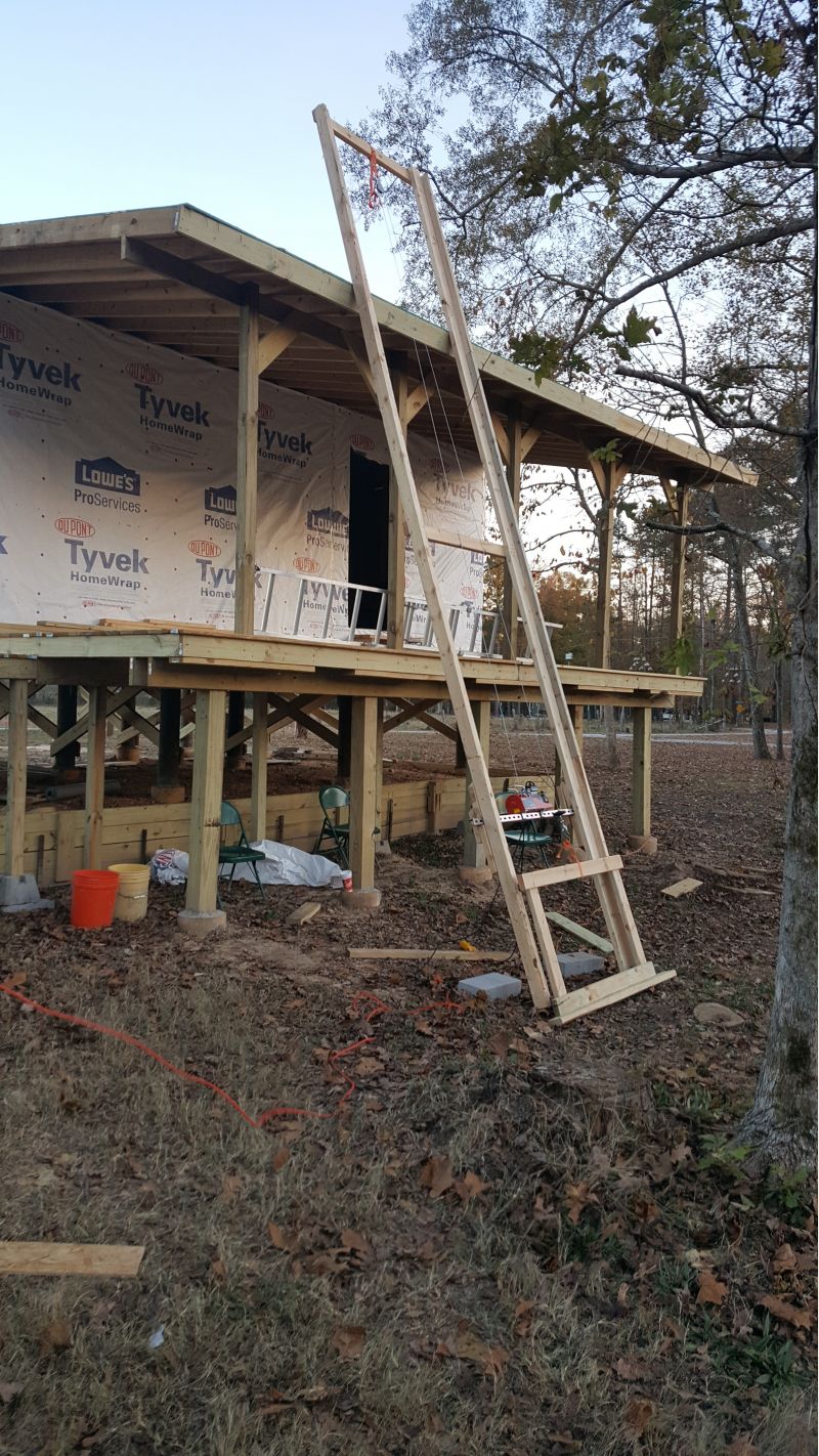

Fifty, sorry for the late reply. Been putting decking on the roof.
That is my neighbor. Lots are just under 1/2 acre each. Only about 10-12 lots in the neighborhood though.
MikeOnBear
# Posted: 23 Nov 2018 10:08pm
Made a little more progress.
Finished decking the roof and got the underlayment on.

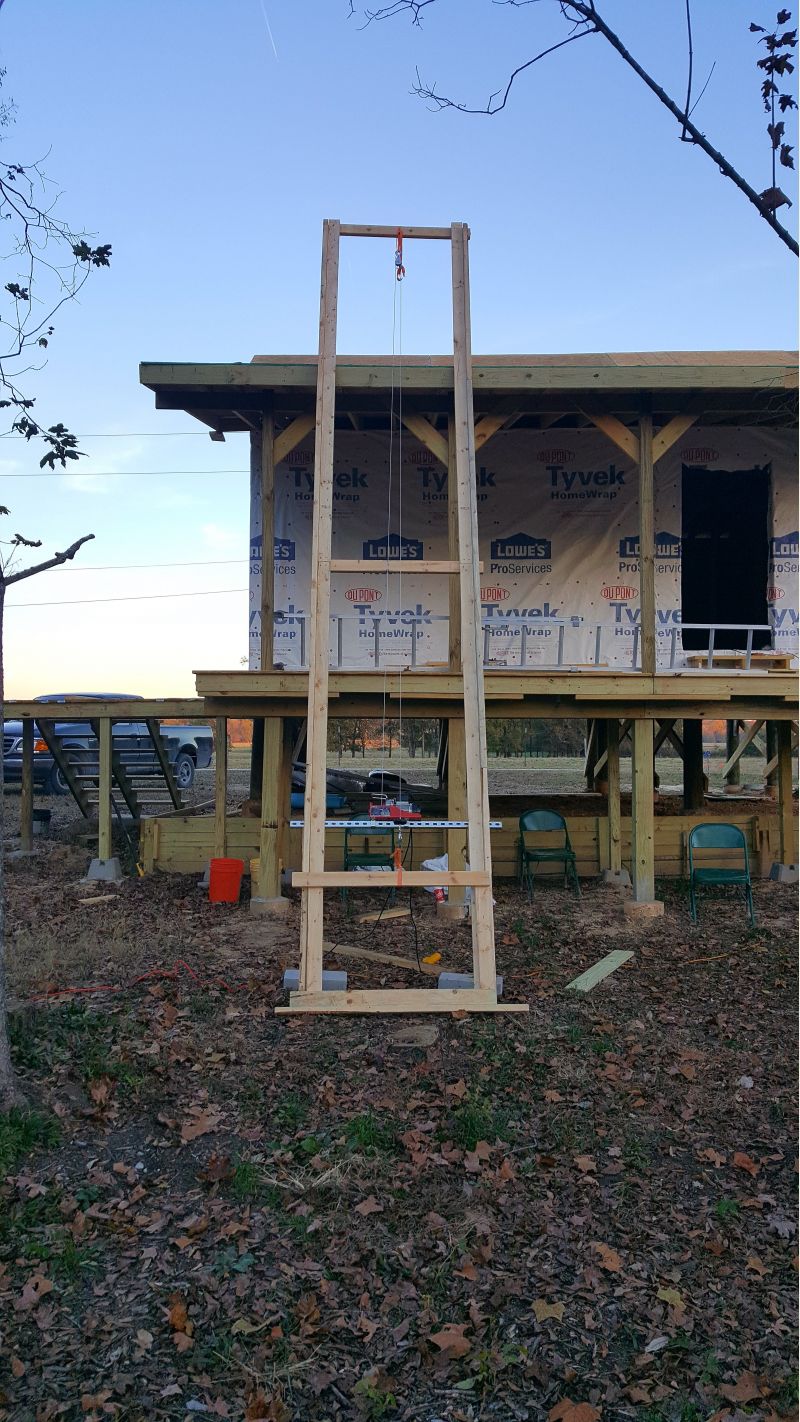

Googled "how to deck roof alone" and found a video of a guy who had built from 2x4's a ramp structure and cart. Loaded to decking on the cart and used an electric hoist to raise it to the roof. I'm pushing 50 and my dad is 74. Made decking the roof as easy as it could be. That's the device leaning on the porch in the 1st 2 pics.
side view of ramp
side view of ramp
front view of ramp
front view of ramp

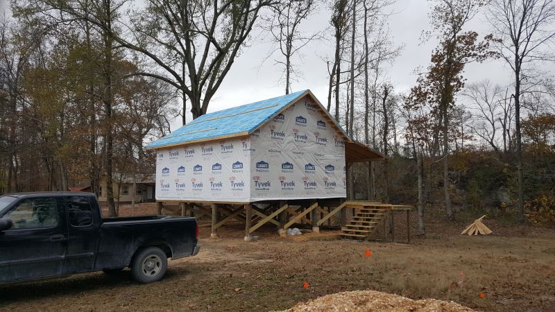

view from road
view from road

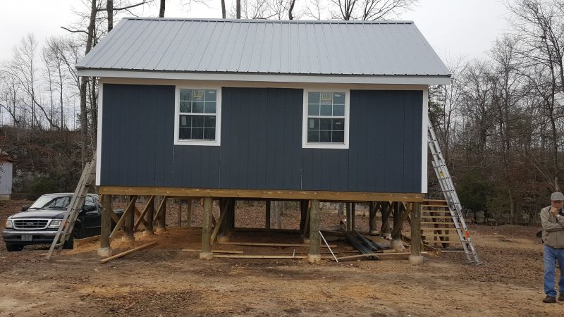

# Posted: 6 Mar 2019 01:17pm
So progress has been a little slow. I'm pushing 50 and my dad is 74. We have been the primary builders. Done about 90% of the work so far.

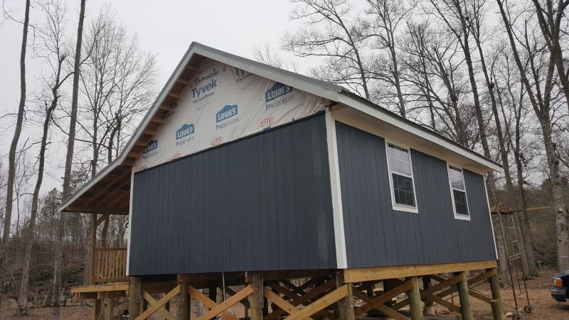

Finally have the siding on, waiting to get closed cell sprayed in the rafters, then I can do plumbing, interior walls, and finish my electrical.

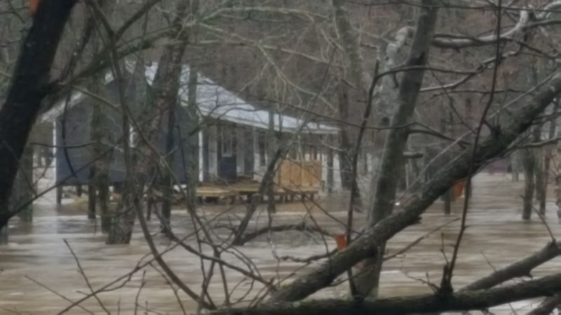

We did get a little water from the recent rains, but luckily we were still a couple of feet above water level. Was told this was the highest it has been since '73.

North end
North end
South End, but now sided

fiftyfifty
# Posted: 7 Mar 2019 08:08am
Nice work. Very clever with the hoist. I love that flood picture, pretty dramatic.
MikeOnBear
# Posted: 9 Mar 2019 05:26pm
Thanks. One of my neighbors said I should patent it. Told him you can't patent what you find on youtube
Got to admit, i was sweating that out. I believe that turned out to be the high water level, but it was too close for comfort. That is FAR from the norm here. 12 of us on the road and 9 got water inside, The other 2 who didn't were pretty close though.
