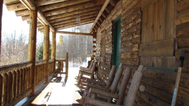

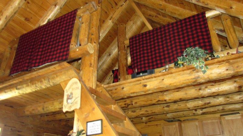

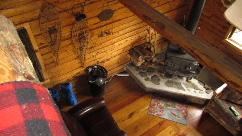

Here are a few pictures of the cabin I am purchasing. It is going to need some TLC, but seems pretty well built. I close in a few weeks and will decorate it for someone who spends a lot of time alone reading. My husband and I are both planning on quiet weekends walking in the woods and fields, reading, napping. I inherited a few throw rugs from my mom and some lamps, and have lots of extra bedding kicking around, so my only real purchase is going to be a Jotul woodburning stove. The one in there works well, but is not up to code and my feeling is that I do not want to be a cabin tragedy and die in my sleep.

That wood floor is stunning, and so is the ceiling. If and when you do insulate, I would for sure do it on the outside and not cover up that gorgeous wood.

Yes, I am thinking for insulation I will insulate the floor (as suggested here) and insulate the roof as best I can and then use rugs and maybe some carpets hung on the wall.

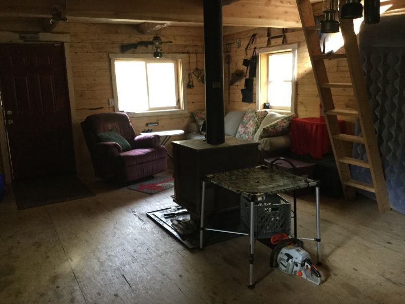

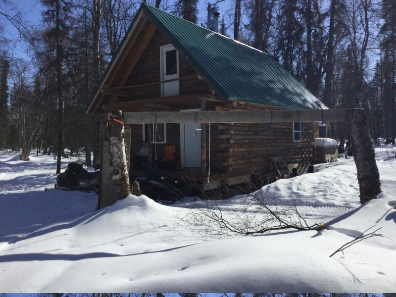

Hello Janemarie , welcome. I also have a log cabin. 16’ x 24’ with 4’ decks. 3 sided 6” logs . We , my beautiful wife and me , wanted a full upstairs so we built it with 10’ walls .

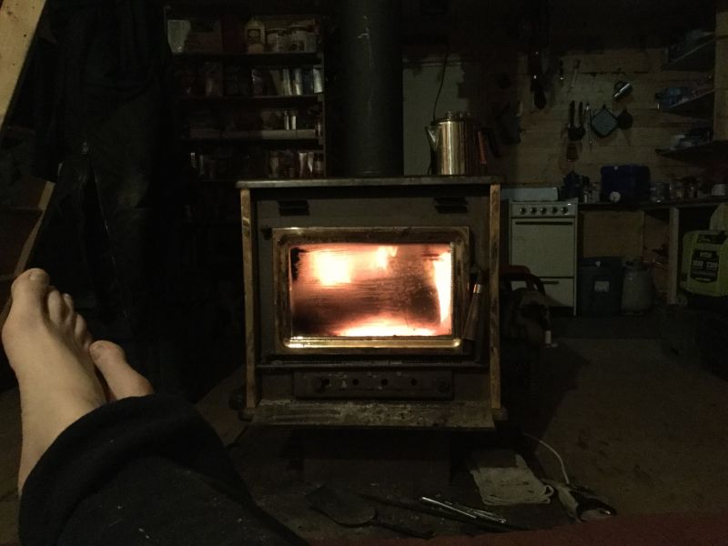

If the floors are not insulated, spray foam is best . Use as much insulation in the lid as possible. Just my opinion, the woodstove you have is beautiful. Just not practical. I have seen this stove before and they are nice if you want to open it up to watch the fire. But you need to be able to load it up for the night and still be warm in the morning. That requires a stove with a deep fire box. Our stove also has a glass window. I really like this because it puts out a nice light at night that keeps the cabin illuminated with a nice warm glow or when we want to turn on the local tv we can open the door and watch the fire dance. Again a deep fire box will keep embers from rolling out. Blaze King are probably the most popular wood stove in Ak . Although mine is not that brand . New stoves are much better at reducing smoke and particulate matter and increasing efficiency. You do need dry wood ! We also have double wall stainless stove pipe. Won’t rust although we do loose the radiant heat. We have no problem warming up the cabin from -20 to 80 in less than an hour. A well insulated lid is essential.
Can you post pictures of your foundation. Probably the most important part besides roof.
Will be glad to help all I can. I will post a couple pictures of our cabin but you can see more on my thread. Cabin life is good life!

Insulating your roof will be very difficult with all those beams and I doubt you'll want to rip down the interior ceiling boards to do it. The best method would be to insulate from the exterior when you get around to redoing the roof.
This article shows how to add the exterior foam insulation above the sheathing (Drawing on page 62).
http://conference2016.eeba.org/Data/Sites/2/media/presentations/Holladay-Getting-Cath edral-Ceilings-Right.pdf
