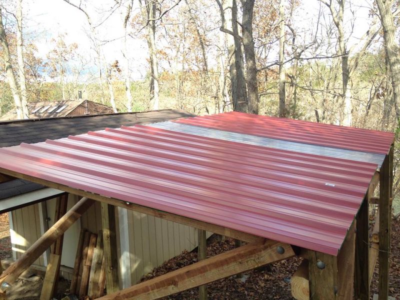

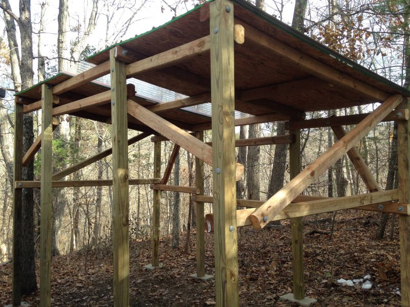

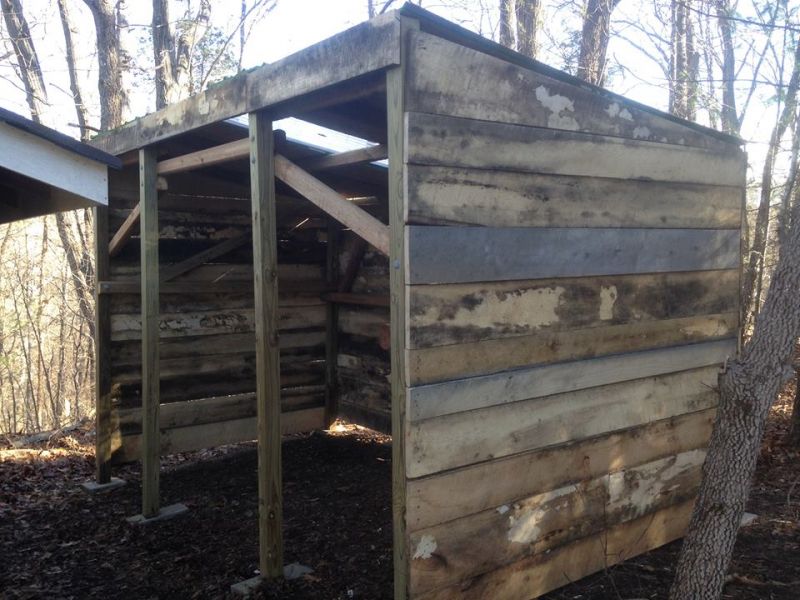

I decided to build a new wood shed at my cabin. The old one was probably 35+ years old and had some structural issues.

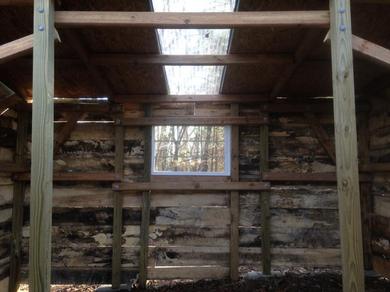

I built the frame from 4x4 and landscaping timbers, and then used barn wood from a local saw mill. Put a metal roof on it, which I got from Lowes. The barn wood was so hard, I needed to pre-drill all the nail holes. Window and skylight let plenty of light in... so we can see the critters.
Turned out pretty well I think. It'll do for another 30 years.
frame
frame
roof
roof
window-sky-light
window-sky-light
front
front

I'm planning to do a small one myself this year, until I can figure out how much wood we go through and need to keep on hand. I was going to do some tinted polycarbonate roofing like your middle panel, hoping it will get a bit of sun to help dry, too.

The transparent strip down the middle is an excellent idea. Thanks

I have to be honest about the strip down the middle. I installed it in order to make the metal roof "work".
When I decided on the size of the wood shed, I *assumed* that I would be able to buy metal sheeting that was 4x8. This is not the case. As a result, I put plywood down for the roof, and then put the metal strips over it, overlapping slightly so that I would not have to cut the metal. The clear material in the middle ended up fitting nicely, but it was not part of the original plan.
It all worked out... but I should have known what type of roofing material was available, and in what sizes first.
Nate, I found that the middle panel is quite flimsy... not sure I would do the whole roof in that material.
Good luck... let's see the pictures as you progress.
