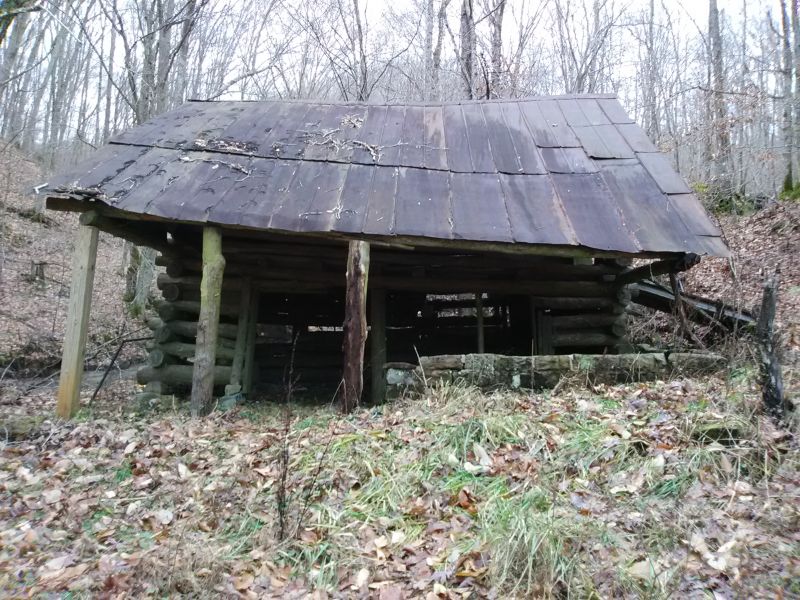

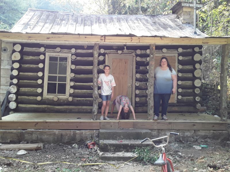

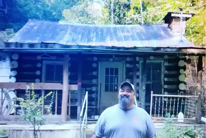

I am planning on doing this as a off grid in West Virginia. House has been in family for generations. Sitting empty for over a decade on 90 acres. I have been doing research but I know there is always something forgotten. Any advise before beginning. Thanks![IMG_20181019_134759..jpg IMG_20181019_134759..jpg](https://www.small-cabin.com/forum/shared_files/uploaded/8856/123641_1.jpg) IMG_20181019_134759..jpg

Oh, that is going to be fun. When was the first picture taken and when was the last? Have you found a source for replacement logs or do you plan to cut them yourself?

The one on the left looks quite salvageable. The one on the right - fence off and call ruins IMHO. Sometimes things cannot be efficiently saved. There may be sentimental reasons for spending a lot of cash to resurrect an old building, but usually does not make economic sense.
We had an older place that we agonized over for years and finally decided on a replacement - made far better sense to us. But because we are stubborn, we continue to fix up the "old" place. It is much easier having another place to call base while we fix the older place. Now we have two places to maintain.
The cabin with you (?) in the pic looks quite savable and with a lot of TLC, will be a great project. Beautiful property! Good luck!

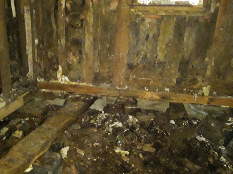

Hi all thanks for replying. Old barn on left can be saved. The cabin is a major renovation. The entire inside was rotten. The logs outside were good except 1. I cut replacement off property. Here is how bad interior looks.![20191012_095230.jpg 20191012_095230.jpg](https://www.small-cabin.com/forum/shared_files/uploaded/8856/129346_1.jpg) 20191012_095230.jpg

Logs come from the 70 acres cabin sits on. The pictures taken in February 2019. 1st building is cabin 3rd pic is of original barn

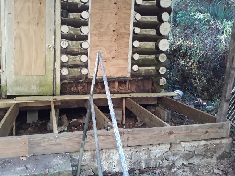

Replaced 1st log on front of house. Cut tree and notched. Fixed porch and leveled front. Now I can reach interior to start leveling rest of building. Contracted with local mill to use my logs to cut lumber for replacement supports and beams. So far so good. Will not redo chinking till building completely level.![20191003_165701.jpg 20191003_165701.jpg](https://www.small-cabin.com/forum/shared_files/uploaded/8856/129523_1.jpg) 20191003_165701.jpg

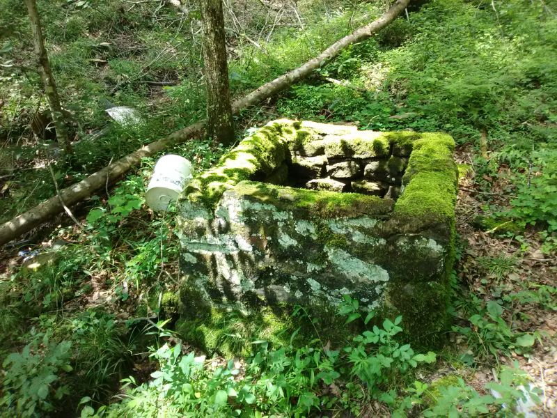

Water source not yet examined. I found original well 300 ft uphill from cabin. Looks like I will need to pump out. Lid is missing. Let it refill then have water tested. No livestock or people within miles to pollute, so hoping I'm lucky.
Duckgun351
# Posted: 23 Oct 2019 03:22
Here is picture

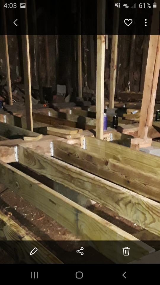

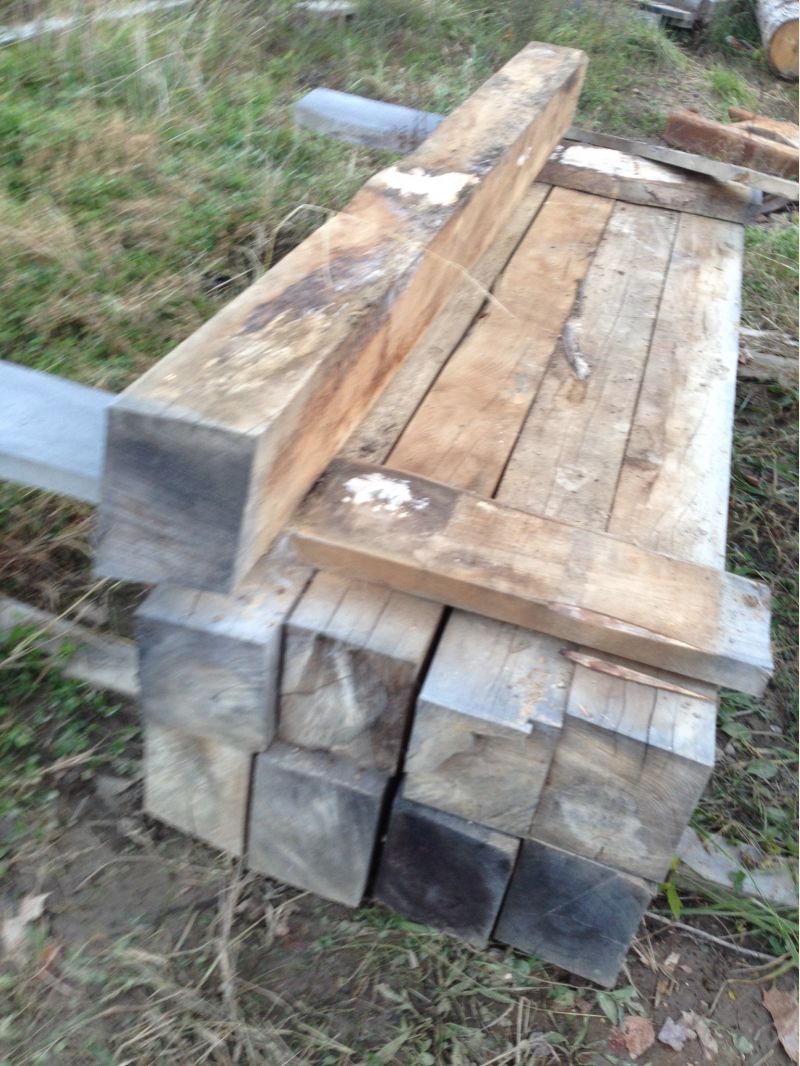

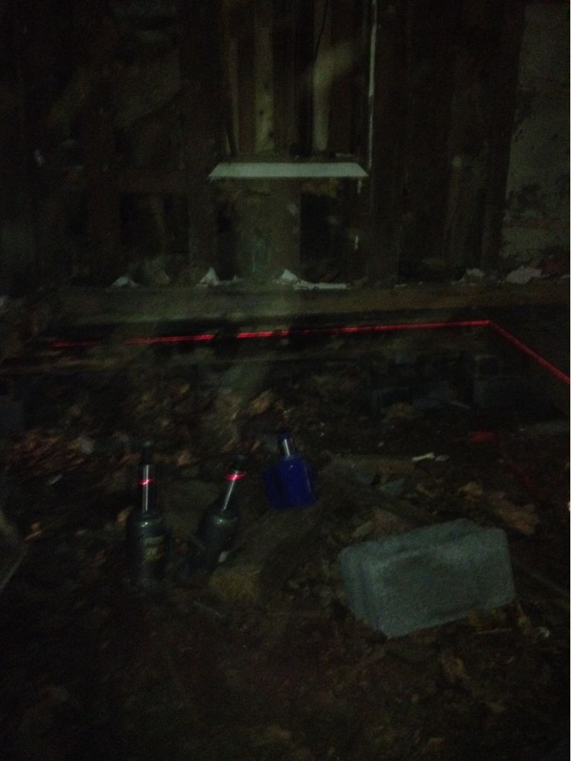

Had local mill make 9x7 out of some oak. Once I got laser level floor was rotten but still farely straight. Jacking up lowest spot was only 2inch. So I am slowly jacking up and replacing supports with these and block. So far so good. Sorry picture dark still no electricity.![IMG_25241.jpg IMG_25241.jpg](https://www.small-cabin.com/forum/shared_files/uploaded/8856/129904_1.jpg) IMG_25241.jpg
| ![IMG_3559.jpg IMG_3559.jpg](https://www.small-cabin.com/forum/shared_files/uploaded/8856/129904_2.jpg) IMG_3559.jpg

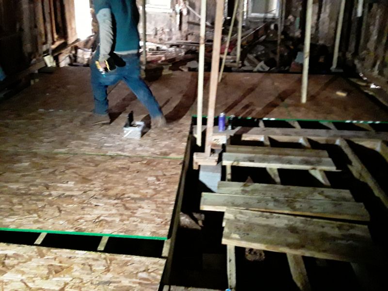

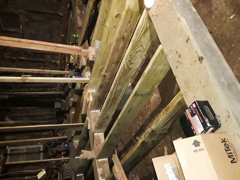

# Posted: 8 Dec 2019 06:58

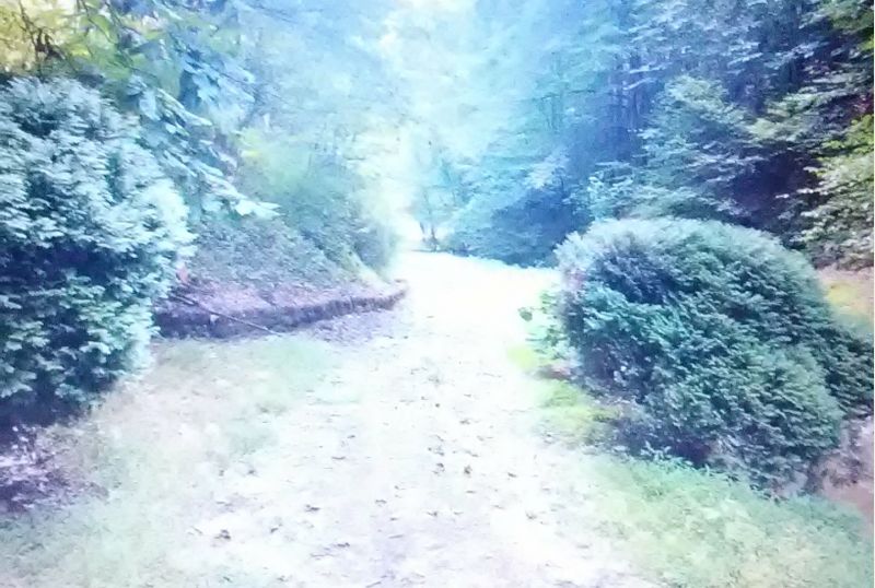

Here is update. Cabin leveling went well. 12 20ton jacks did job. 9x7 oak logs as main supports. Treated 2x8 floor joists. And bunches of time gutting and trying to find square ( lol) was nothing square. Floor going down. Last I enclosed picture of property. Cabin is located down in valley.![20191109_154718.jpg 20191109_154718.jpg](https://www.small-cabin.com/forum/shared_files/uploaded/8856/130724_1.jpg) 20191109_154718.jpg
| ![20191116_175342.jpg 20191116_175342.jpg](https://www.small-cabin.com/forum/shared_files/uploaded/8856/130724_2.jpg) 20191116_175342.jpg
| ![20191117_135109.jpg 20191117_135109.jpg](https://www.small-cabin.com/forum/shared_files/uploaded/8856/130724_3.jpg) 20191117_135109.jpg
| ![20191129_083112.jpg 20191129_083112.jpg](https://www.small-cabin.com/forum/shared_files/uploaded/8856/130724_4.jpg) 20191129_083112.jpg

Here's property

Hi Duckgun, can you go into a little more detail on how you did the leveling? Specifically the interior ones that you can't access from outside the perimeter of the cabin. Thanks!
Duckgun351
# Posted: 8 Dec 2019 22:41
I used 12 bottle jacks and a laser level. As I was laying outside 9x7s I added and leveled a 9x7 to inside where wanted support. Basically making a T then just continued around matching up.

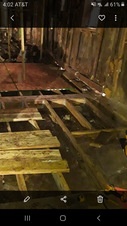

Duckgun351
# Posted: 9 Dec 2019 04:07
I blew pictures up a little. Basically original floor supports were logs. The 9x7 follows the original plan. Then instead of going with notched over,I used treated 2x8![Screenshot_20191209.jpg Screenshot_20191209.jpg](https://www.small-cabin.com/forum/shared_files/uploaded/8856/130740_1.jpg) Screenshot_20191209.jpg
| ![Screenshot_20191209.jpg Screenshot_20191209.jpg](https://www.small-cabin.com/forum/shared_files/uploaded/8856/130740_2.jpg) Screenshot_20191209.jpg
# Posted: 9 Dec 2019 09:51
You may want to consider putting a vapor barrier down if you can. Looks like you’re getting it done though. I’m sure you and yours will have lots of memories. Because you were willing to give this old cabin a shot. Good on you man ! Merry Christmas to you all.
Duckgun351
# Posted: 9 Dec 2019 11:17
Vapor barrier will be under osb. Before screwed down. . It already on site. Thermo ply under the osb and plastic on ground. Also thermo ply will be installed back side of logs before finishing.
