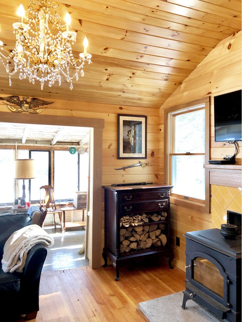

I picked up an old bureau at the habitat for humanity restore.
Removed a few draws, re-enforced it with some steel and 3/4 plywood. Scrubbed, cleaned it up, used a little paint inside and rubbed it down with some mahogany finish restorer.
I put wood stove / fire supplies in the top two draws (matches, fire starters, gloves etc..)
The first section is for kindling and smaller pieces of wood while the bottom holds about a days worth of fuel.

What a cool way to hide the indoor woodpile. Nice and organized to. This was a great idea and it turned out really nice. Awesome job.

Thank you for this idea....I have a few old taller dressers I was going to get rid of....not now.

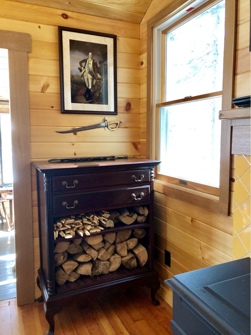

The existing interior was pretty fragile so
I ran angle iron under the existing shelves and laid 3/4 plywood on top of the old shelves for added support to hold the weight and abuse of the logs being loaded and unloaded.
