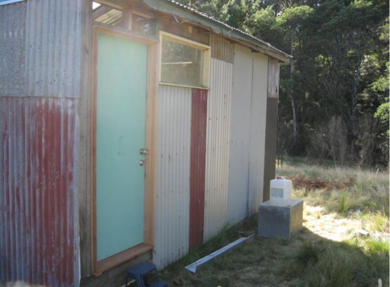

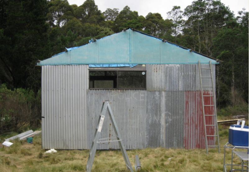

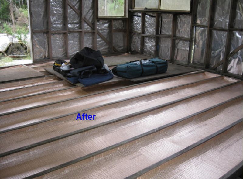

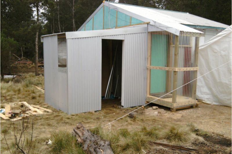

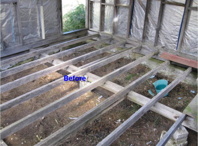

Weve been travelling up to the land these last 3 weekends in an effort to get the cabin closed in to lock up stage before winter strikes (May).
The corregated iron cladding is a bit ugly but since it was 75% completed we decided to stick with it. Will give it a coat of paint to tidy it up.
So far have managed to close in the east wall which was just open framing, the west gable and installed under floor insulation. This coming weekend we are hoping to get the east gable completed, barge flashing, lay flooring, install window flashing, construct door frames and hang the front and back doors. A big ask but will see how we go.
west gable
west gable
floor framing before insulation
floor framing after insulation

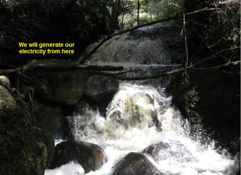

Wow, the creek should be great for producing hydro electric. Cabin looks like a lot of work but its coming along! I take it the area is pretty remote? Looks like a very interesting place! Good luck and keep the pictures coming.

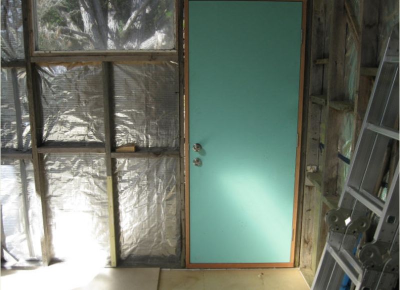

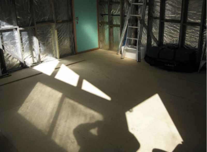

We managed to get almost 2 full days work up at the block on the weekend. You know, its amazing how much planning has to go into each trip to ensure you have enough hardware supplies, tools etc. Its like carting young children around again which is now only a distant memory :)
The focus this weekend was to move towards lockup of the building. We spent Saturday laying the remaining portions of the floor. We used specially formulated flooring material available in Australia - a chipboard which can withstand open rain conditions for 60days. It comes in 3600 x 800 sheets which are very heavy. We have glued and nailed at each joist (spiral galv deck nails).
Next day, having a nice clean floor to walk on, we focused on doors. Two exterior door frames were constructed, doors hung and braced. THen we discovered the wall framing where the doors were to go needed adjustment. The adjustment and later fitting of the completed frames took most of the afternoon. Once all in place and squared, locking hardware was installed. We have opted for a separate deadbolt arrangement so we have 2 locking points. Added to that the solid 45kg doors it should keep most honest people out.
I have discovered that I can usually get around 80% of what I plan to get done, actually done - if all goes well.

Looks great Neil! That floor really changes the place. Did you get your interior plan sorted out?
Is the lake suitable for swimming? It looks really refreshing.
NeilR
# Posted: 4 Apr 2011 10:23pm
G'day Mike,
yes, the floor makes a huge difference. You can even feel the temperature difference with the underfloor insulation.

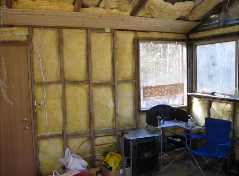

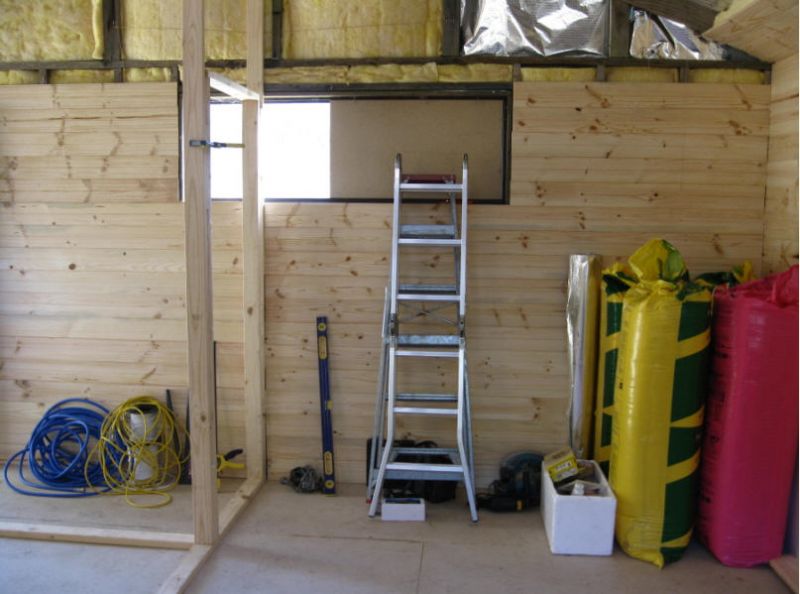

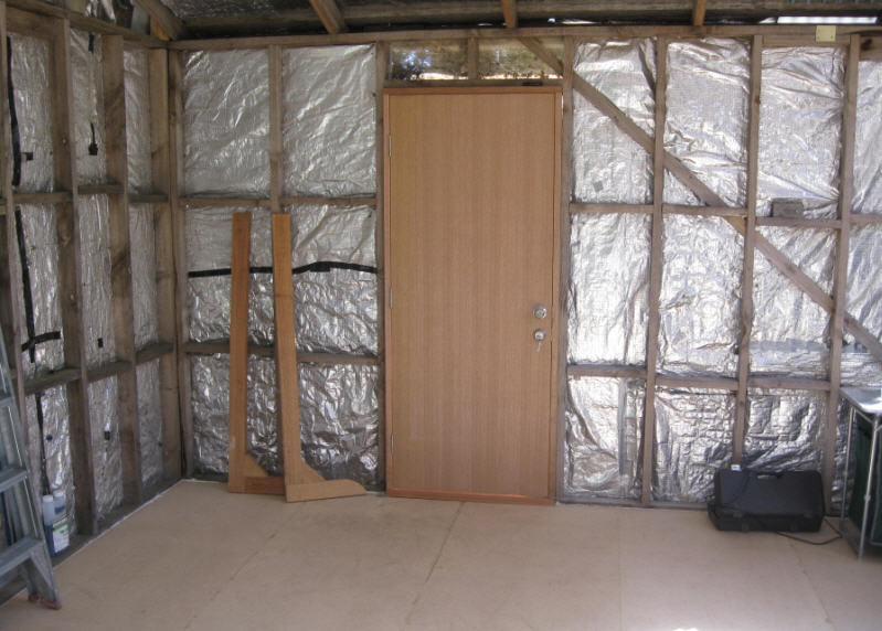

Since my last post we have had 2 further weekend visits to the block.
All wall insulation is complete. Rough plumbing is almost finished. Rough electrical is finished. Centre partition wall is started. This will provide much needed bracing in the east/west direction of the building. We have decided to put a wood stove into the cabin after discovering a complete spare in our garage. We have been living in our current house for nearly 7 years and always regarded the pile of woodstove "bits" in the corner as spare parts. It wasnt until I decided to have a good look at it that I realised there was a complete assembled unit there. Arguably in better condition to the one in our house. So, its off to the block with it and will solve our heating, cooking and hotwater problems in one go. I think further down the track I will build a solar hot water unit as a supplimentary system.
We started on the wall cladding. Using 140mmx12mm t&g pine. The compressor burned out over last weekend so lost use of the brad nail gun. This has now been replaced so its full steam ahead this coming weekend.

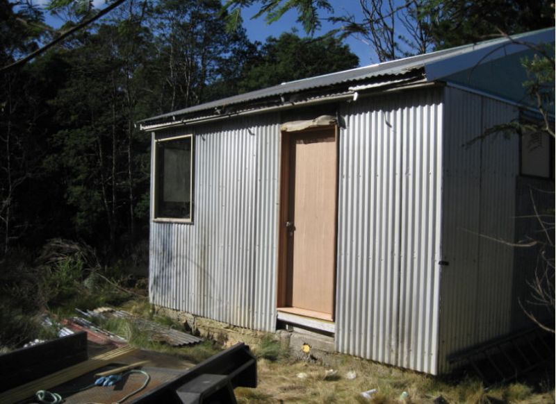

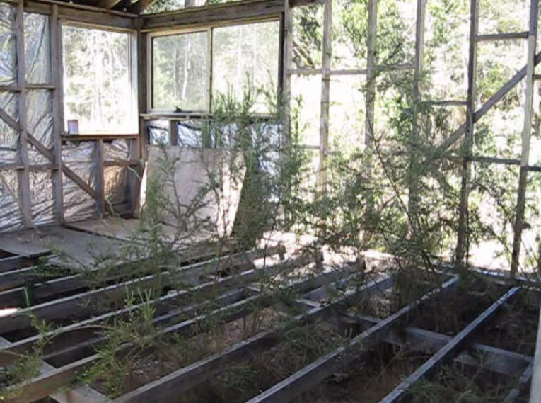

I found a very early picture of the cabin just before we purchased it which gives a good idea of what we had to start with.
More pics coming soon.
Is it worth repairing?

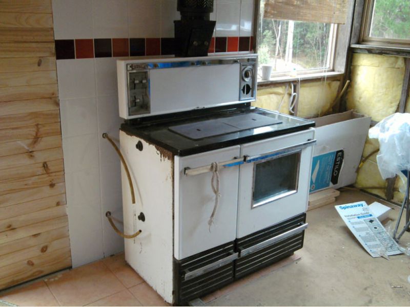

nice job.......did ya ever kill that snake...........
would like to a see a pic of that woodburner when ya get it installed, is it cast iron ????

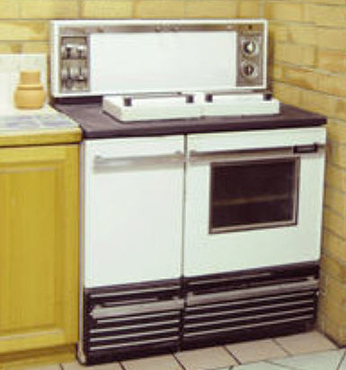

Pic of woodstove attached....its the one in our current house but identical to the one for cabin.

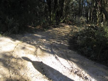

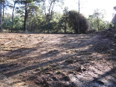

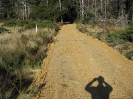

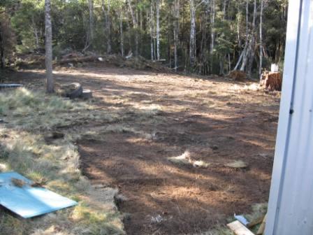

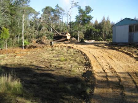

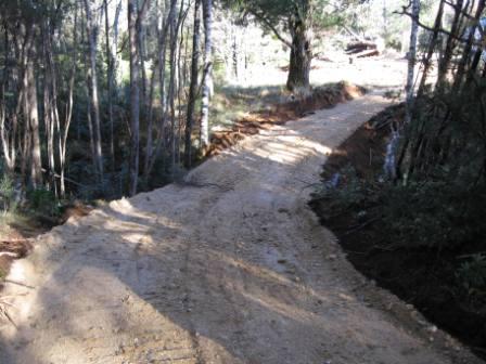

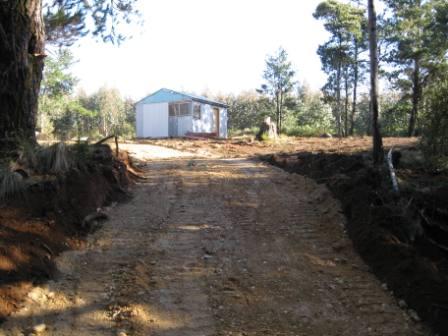

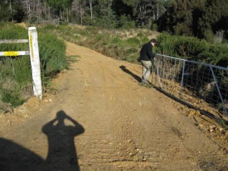

We have just had an excavator on site which was 6 weeks in the planning. Hes created road access and a long winding drive/track, cleared all the scrubby rubbish from around the cabin and made room for future garden/orchard, car and caravan parking, workshop and flat area for another small cabin my son intends to build. It took 11 truck loads of gravel at 12t per load to cover the drive.
We now have an old 22ft caravan to use for accommodation which will be more homely than a tent and cheaper than motels.
entrance from road
entrance from road
further in
further in
more track
more track
and again
and again
NeilR
# Posted: 19 Jun 2011 04:03am
and a couple more.....
coming up to cabin

workshop will go here

# Posted: 19 Jun 2011 07:16am
Quoting: NeilR
it's amazing what you can get done with the right machinery... :-)
looks great.....road is real nice as well. looks like you got down a real good gravel bed for your roadway.......
and maybe....he ran over the snake in the process..............LOL

NeilR
# Posted: 19 Jun 2011 04:48pm
Thanks guys. It costs the same to hire a 4 ton as it does a 25 ton (similar cost anyway) and you can get a LOT more done with the big machine and a good operator. Thats the direction I took.

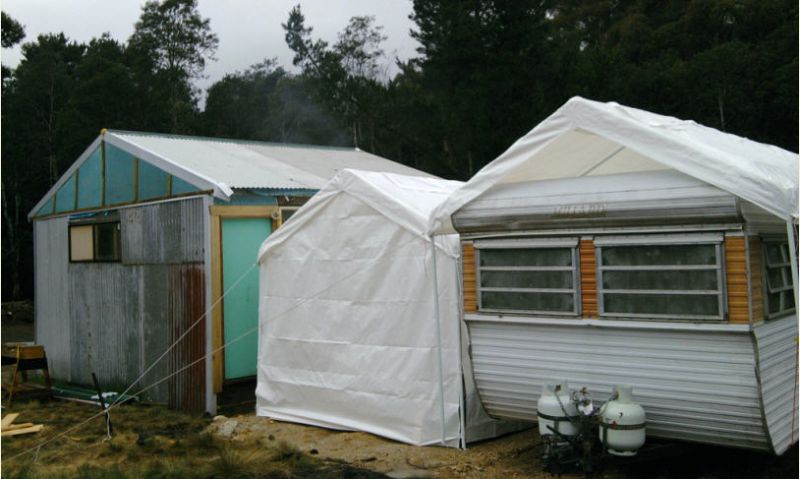

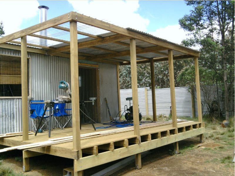

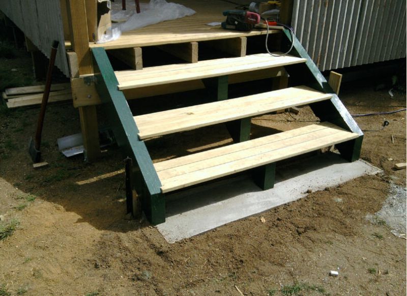

# Posted: 30 Dec 2011 11:22pm

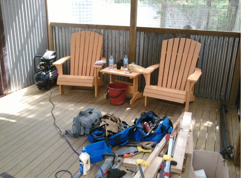

I cant believe its been over six months since I last made a post. Needless to say, its been a very busy year with real life getting in the way of weekend endeavours. However, I am pleased to report we have in fact made significant progress and now able to sleep on our little cabin. What follows is a collection of pictures showing various progress steps. Hope its of value to someone.

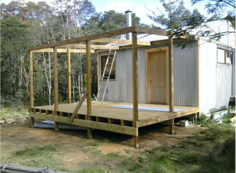

Added back porch
Added back porch
Caravan we used through winter
Combustion stove finally installed

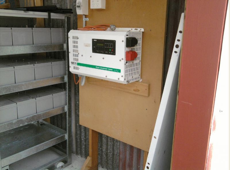

Added a utility room (inverter/batteries etc) plus laundry
NeilR

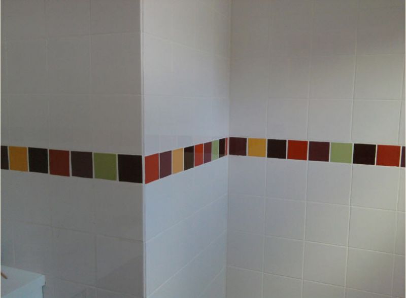

# Posted: 30 Dec 2011 11:33pm - Edited by: NeilR

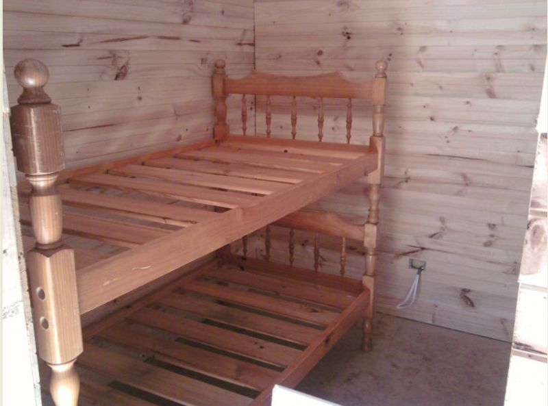

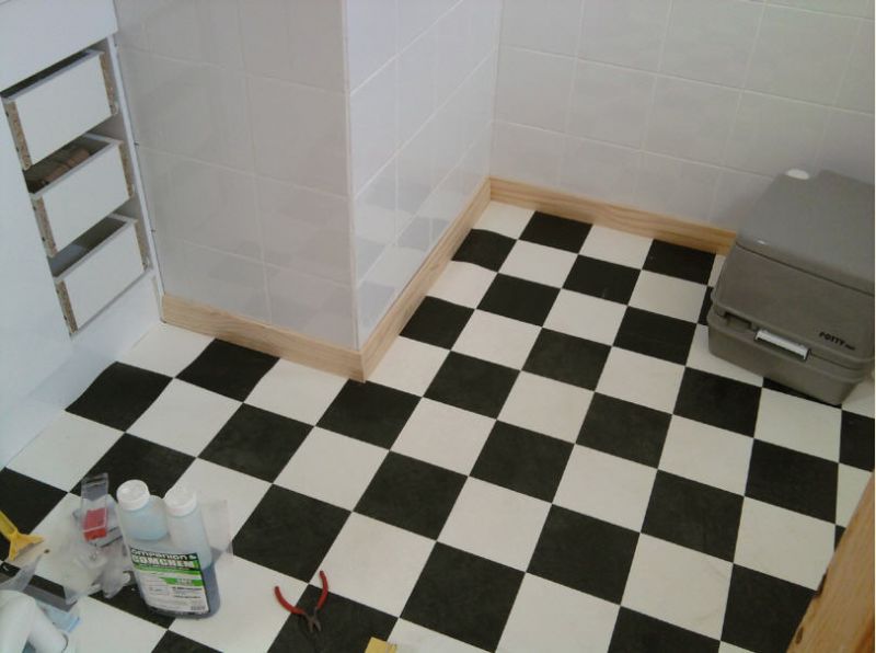

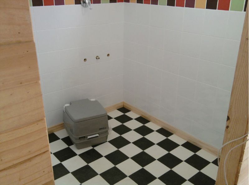

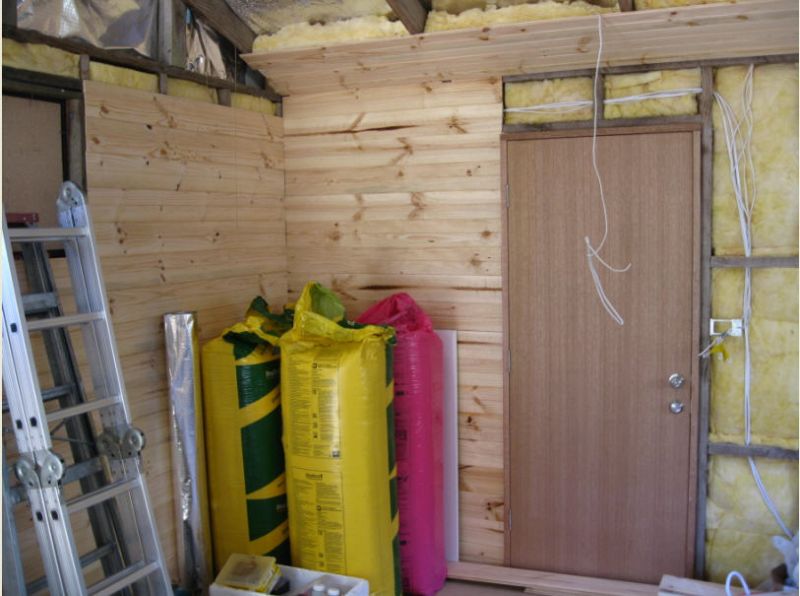

The "bedroom" kept getting smaller and smaller because of the "bathroom" getting bigger and bigger! Now we have a "bunk room". Tiling is a first ever attempt. Ignore porta potti. We have purchased a "Natures Head" composting toilet which will be installed soon.
Also coming soon is an old "claw foot" cast iron bath. I just need to wait for someone to visit who I can trick into helping me lift it inside. There will be a shower above the bath.
Plans are in progress to add a bedroom on as a lean-too room from the bunk room. Bunk room will revert to an office area and storage.

Bathroom
Bathroom
more bathroom
more bathroom

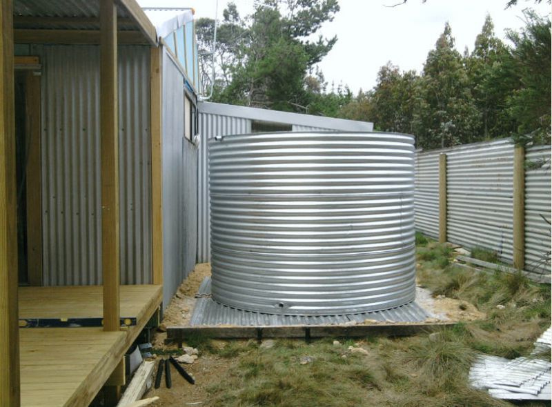

Addition of a deck has vastly increased effective usable area. Installed a 10,000ltr water tank so we are finally collecting fresh water.

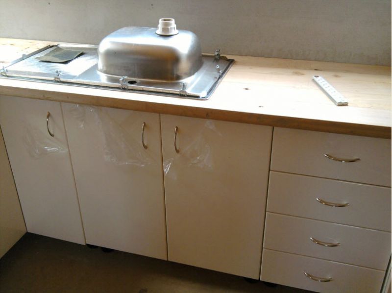

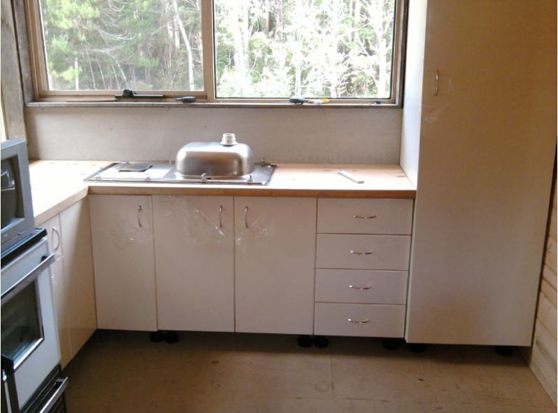

Had to resort to putting a flat pack kitchen in. It just wasnt economical to build from scratch. I resisted the temptation to buy the bench top and have made my own from 40mm thick macrocapa pine. Sink will be mounted correct side down :)
Inverter is a Trace Electronics (now Xantrex) 3.5KW 48VDC system. Batteries are 24 deep cycles in 6 banks of 4 (48vdc). Ooodles of capacity. So far, charging will be from a diesel generator but as mentioned in early posts, the intention is to go micro hydro from our creek.

Glad you're back. You have made great progress. I am curious about the water tank. It's huge. Do have a rainy season? Average rain fall per year? P.S. love the tile in bathroom.

The water tank is common place in rural areas. The tank is bordering on the "just enough" size for 2 people for fresh water. We will probably put a 2nd tank in at some stage to give us 20,000 ltrs but will monitor our usage for 12mths first. This is important for not only drinking water but fire fighting. We are fortunate to have a lake which we will hook a fire pump to at some stage - all the while hoping we will never need it but we must be realistic living in this "sunburned country" of ours.
We have 4 distinct seasons in Tasmania. One of the things we love about it. We get on average 1600mm of rain annually, state wide.
