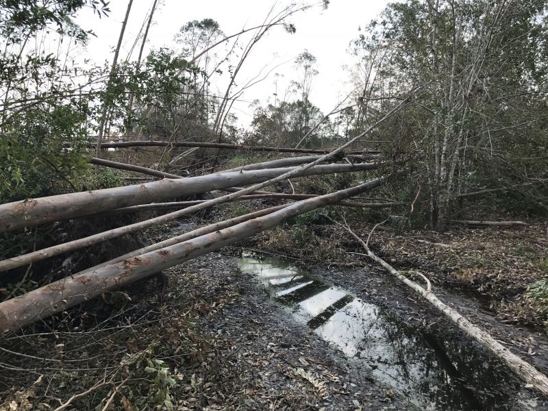

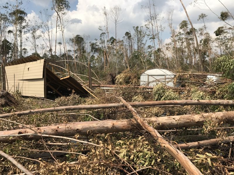

| stalal2525 Member
 | # Posted: 25 Apr 2019 09:08am Reply

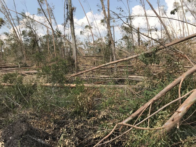

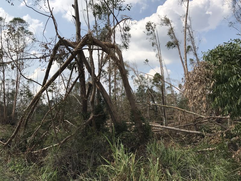

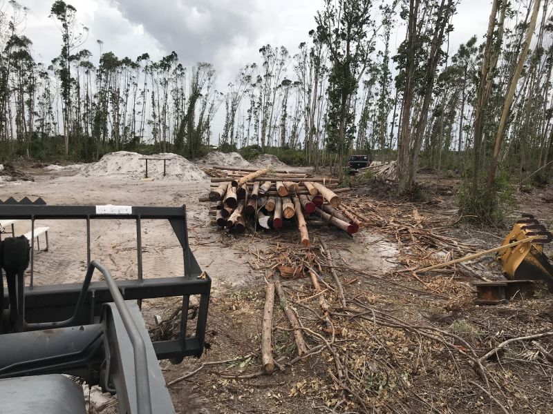

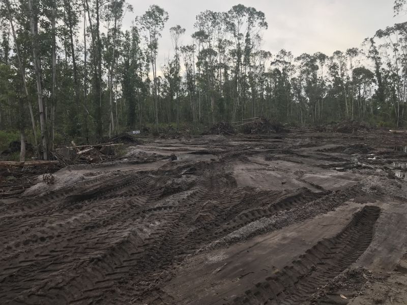

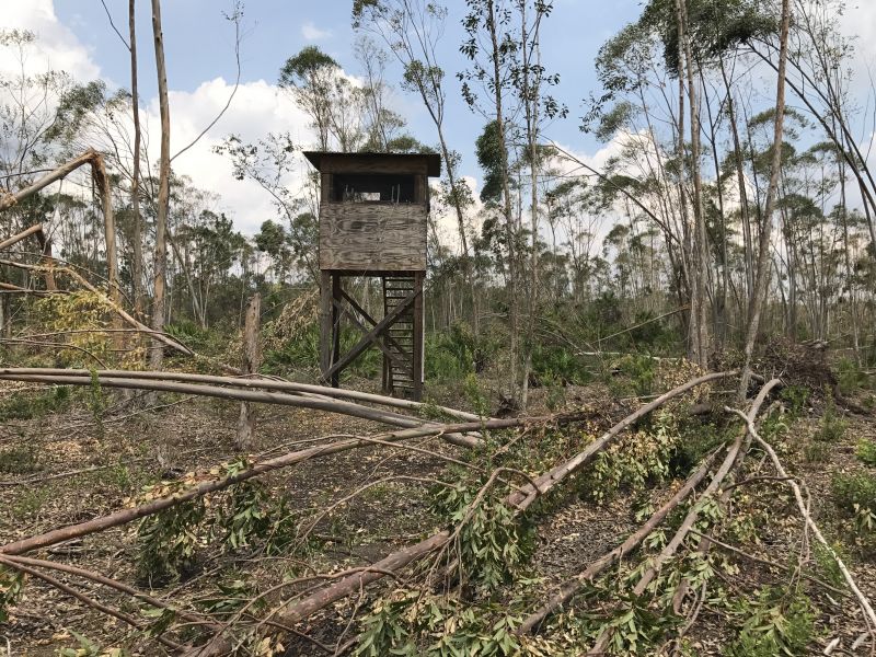

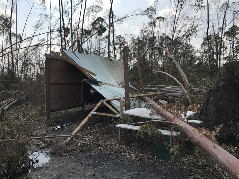

 Few more pictures of hurricane Irma damage to my plantation

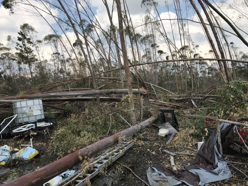

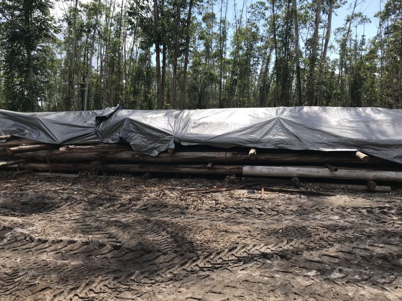

| stalal2525 Member

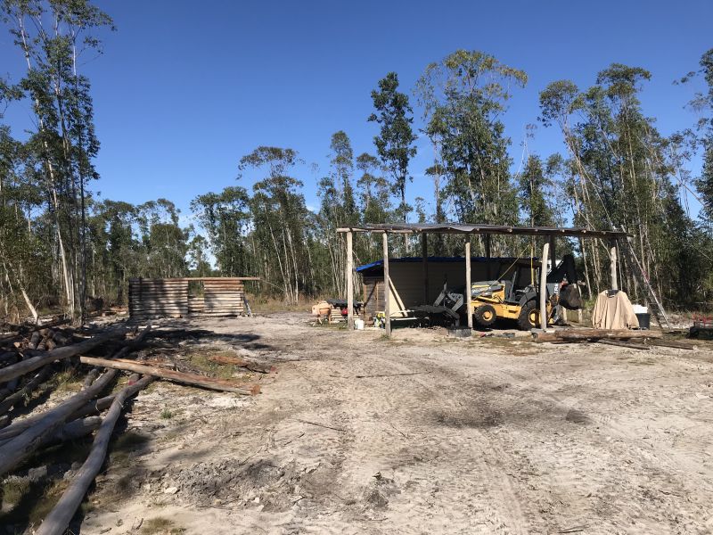

 | # Posted: 25 Apr 2019 11:49am Reply

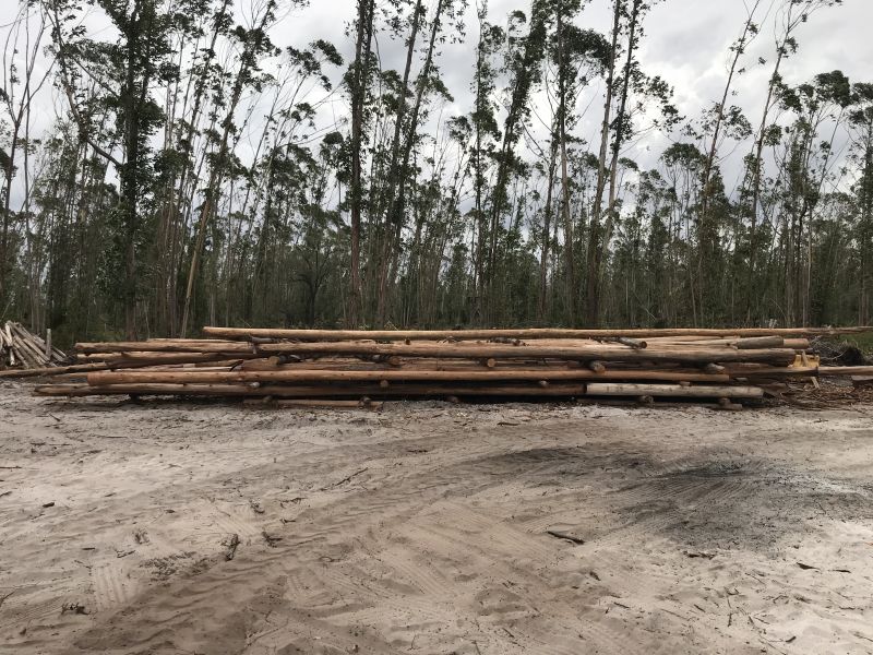

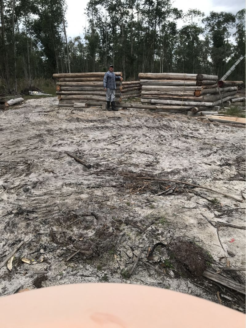

 These pictures were made in April 2018. Debarking of freshly cut eucalyptus trees is easy process, because there are so much moisture under bark. It pills very easy, but if it is hot outside in few hours it dries up and debarking becomes very long and annoying process. If tree was down for few days, it is best to wait few months until trunks dry up completely as bark comes off itself. The only problem at that point trunks are getting twisted and split a lot.
 |  Storing trunks to dry
 |  Raising up spot for cabin

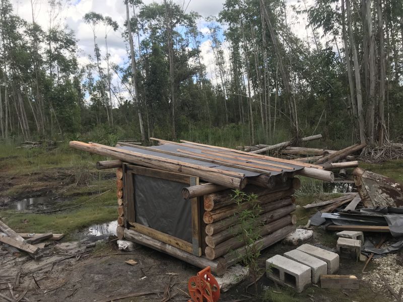

 I never built log cabin before so I had to research “how to†on internet, to choose building type. I decided to use butt and pass method as it is easiest and fastest way to build log cabin. I practice by building small “power houseâ€, where I placed 9000w gas generator and 4500w gas inverter/generator.

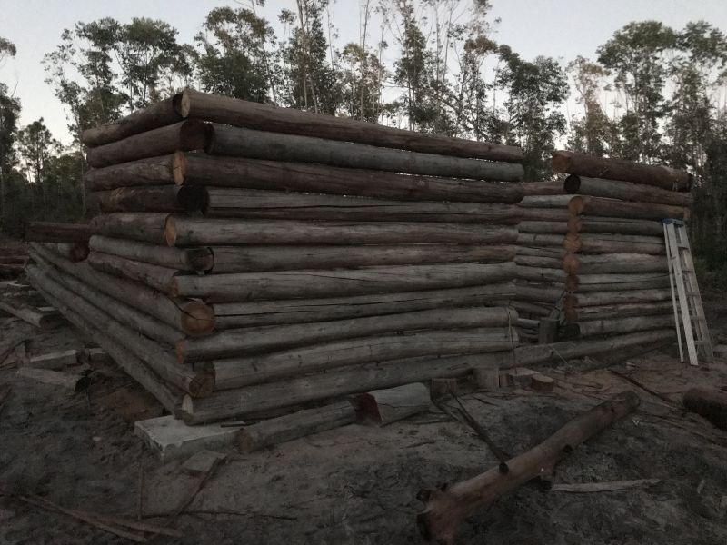

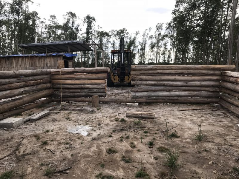

| stalal2525 Member

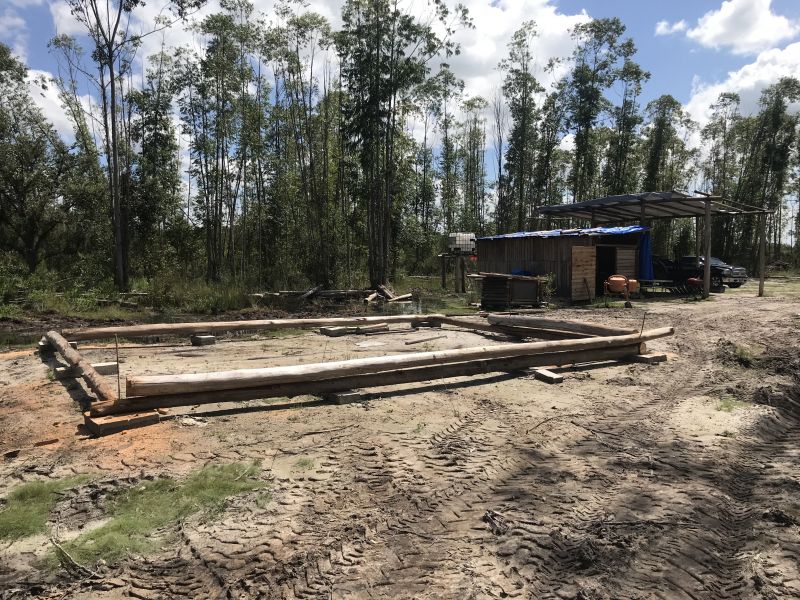

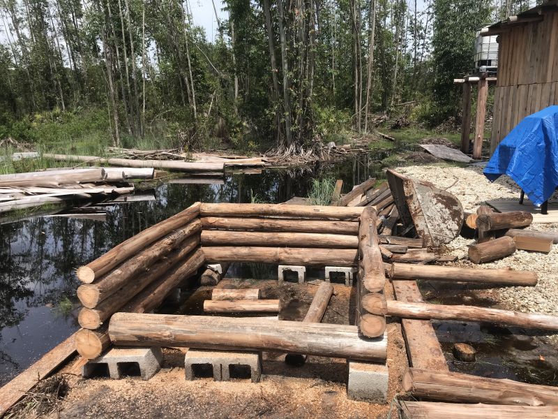

 | # Posted: 25 Apr 2019 12:29pm - Edited by: stalal2525 Reply

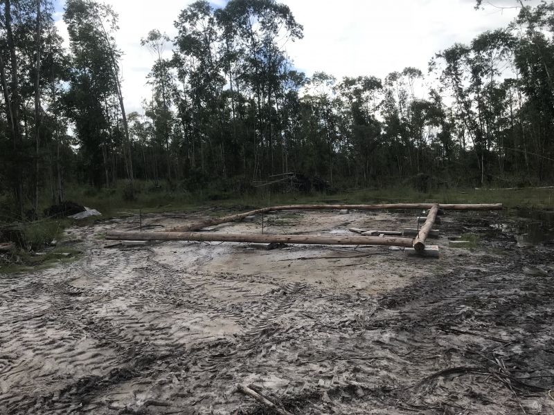

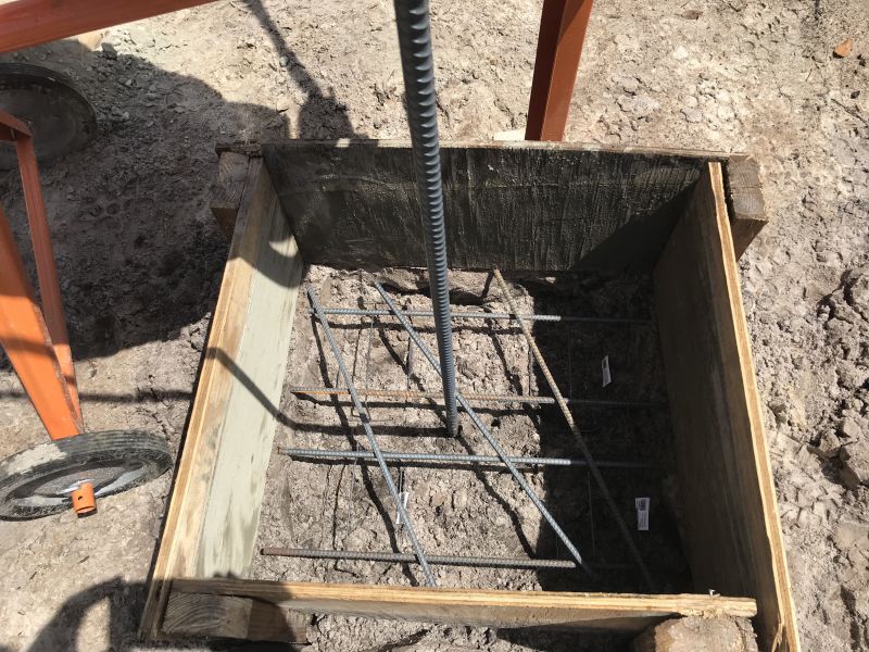

 I made 8 concrete pads reinforced with rebars to raise bottom logs above ground. During Florida rain season, between August and October there are lots of standing water everywhere, as water table comes up all the way to surface.  Corner pads have ¾ rebars come up from to anchor bottom logs to.
 September 16th 2018 first logs were placed on concrete pads.

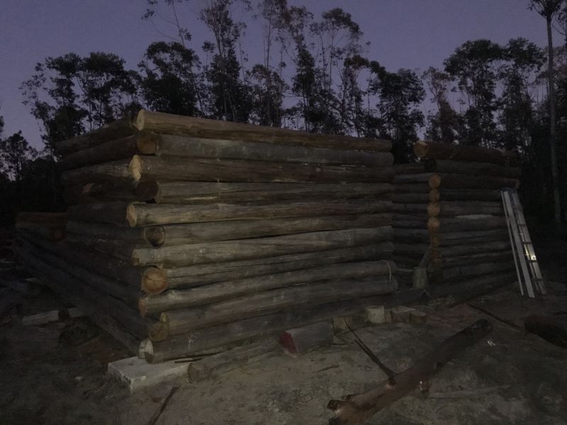

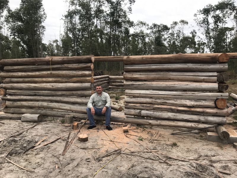

| stalal2525 Member
 | # Posted: 25 Apr 2019 05:17pm Reply

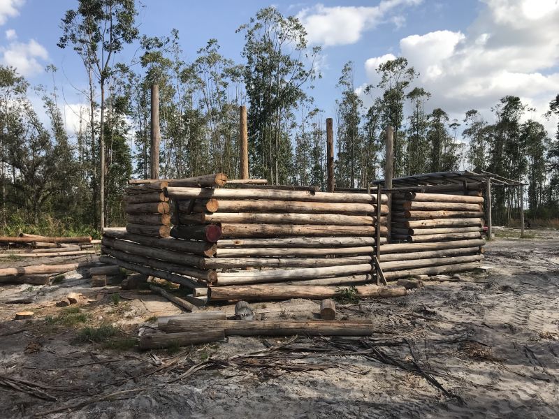

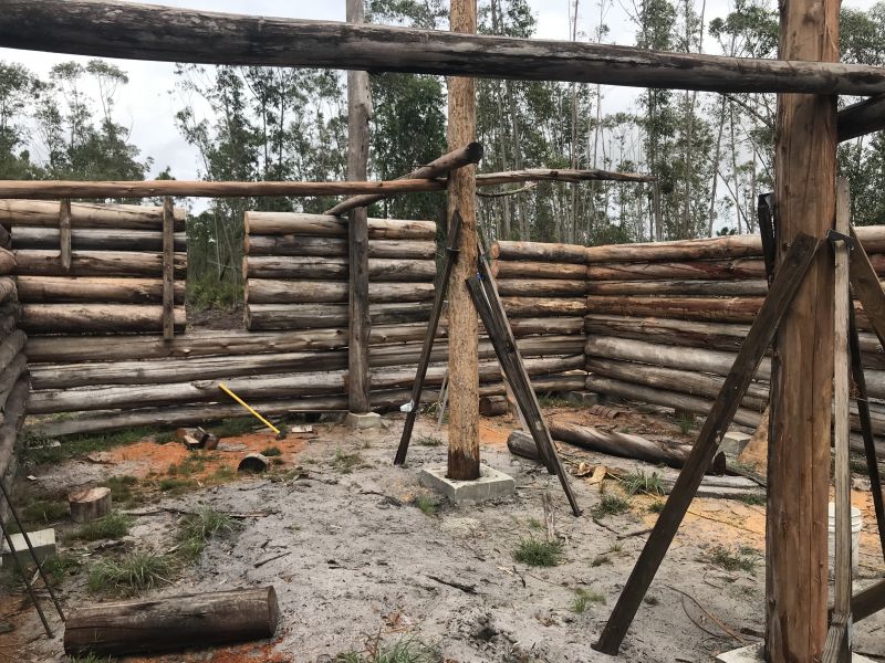

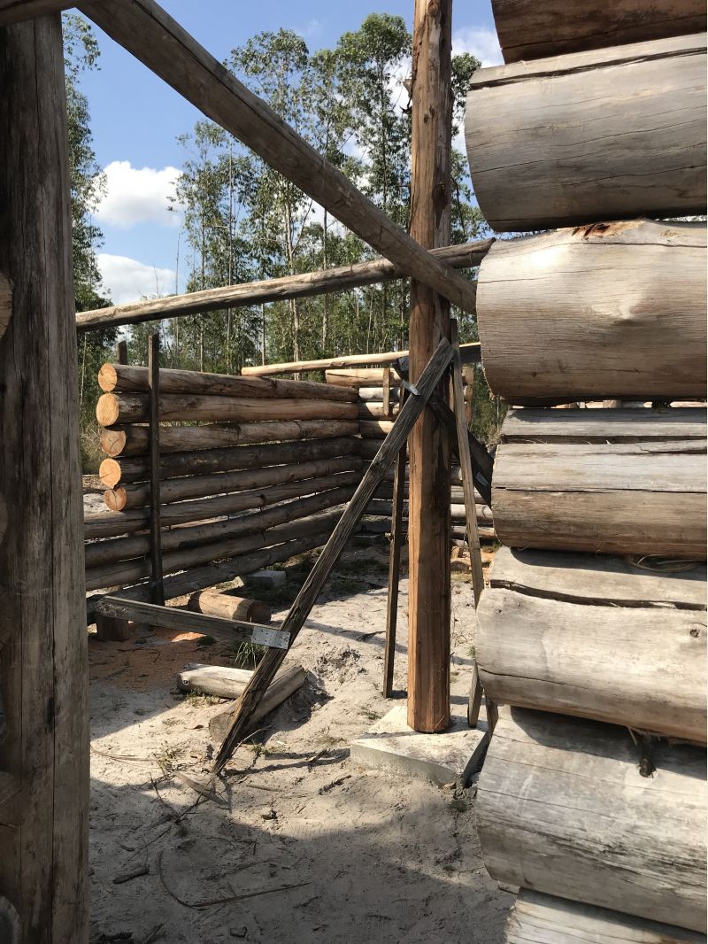

 I still have full time work during week so I can only build the cabin on weekends. This is one of the reasons progress of my project is quite slow. Plus I do hunt and go deep sea fishing once in a while.
 These pictures were taken in November 2018.

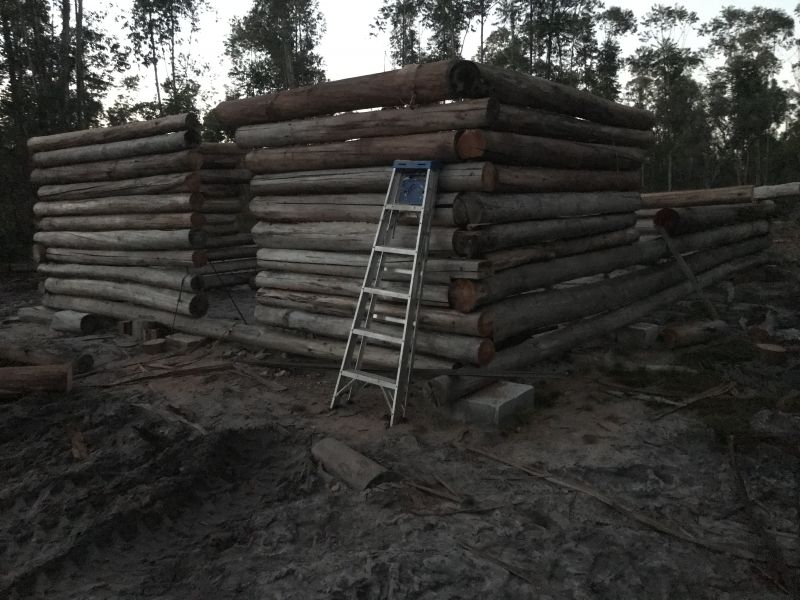

| stalal2525 Member
 | # Posted: 25 Apr 2019 05:21pm Reply
 December 2018

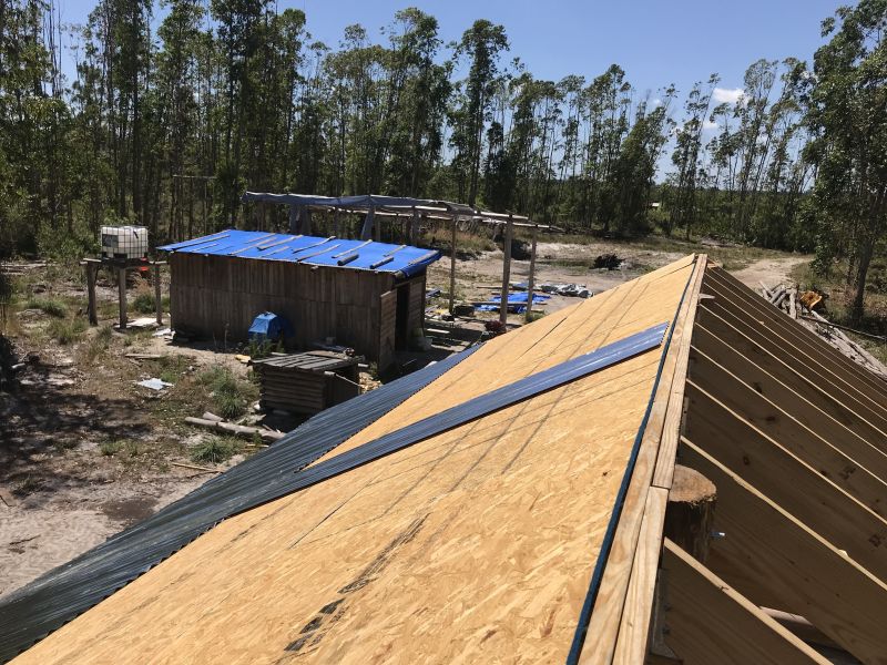

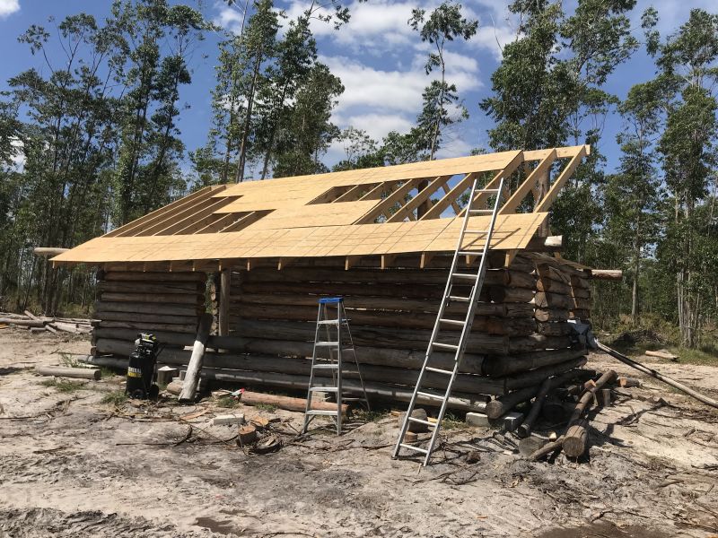

| stalal2525 Member
 | # Posted: 25 Apr 2019 06:46pm Reply

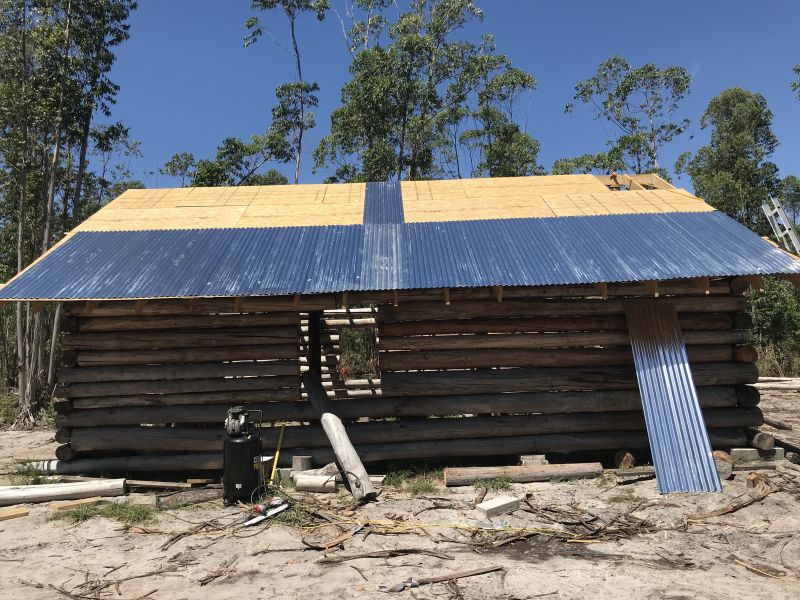

 My goal is to finish roof before raining season stars to keep logs dry. I do not plan to do much during hot summer months as it is very difficult to labor in extreme Florida hit for me. Next step will be building floor and then placing filler between logs.

 I dug 12 feet deep pond and used that dirt to raise ground for the cabin. There is sandy soil when you dig past 3 feet or so, and after 8 feet there is clay soil at our SW part of Florida.

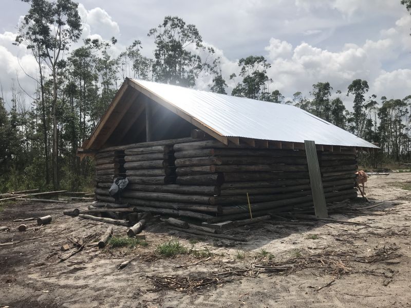

| stalal2525 Member

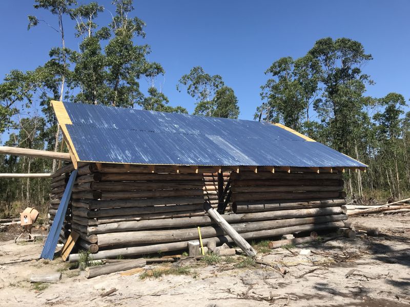

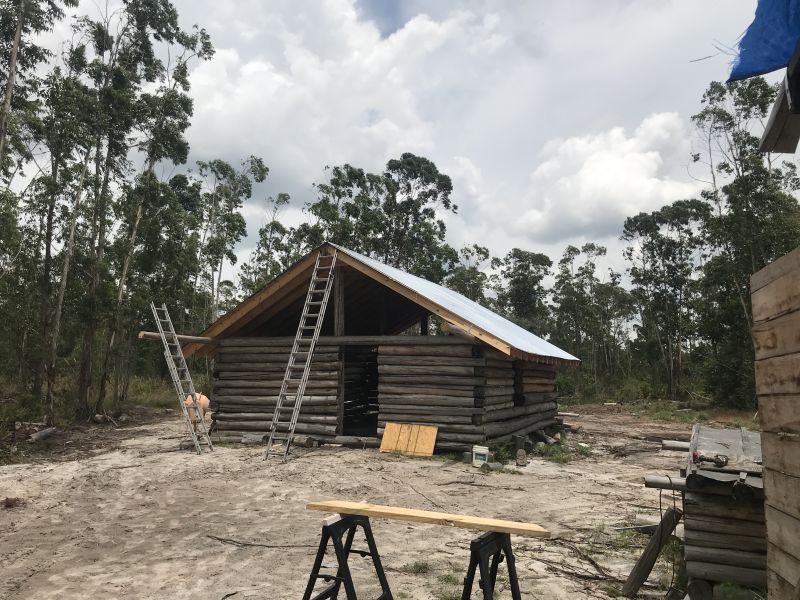

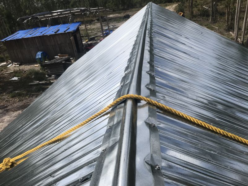

 | # Posted: 9 May 2019 02:05pm Reply
 Roof is almost done, just need to finish edges.

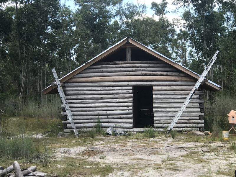

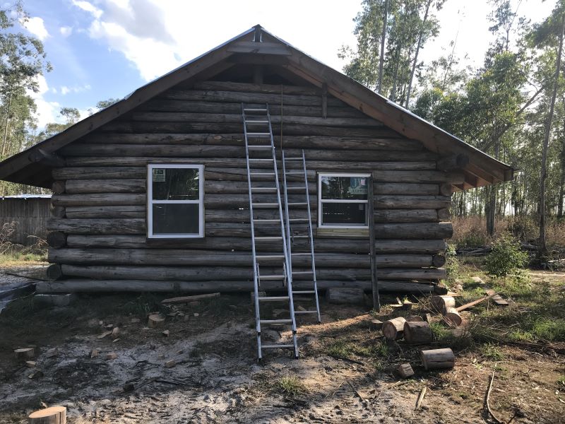

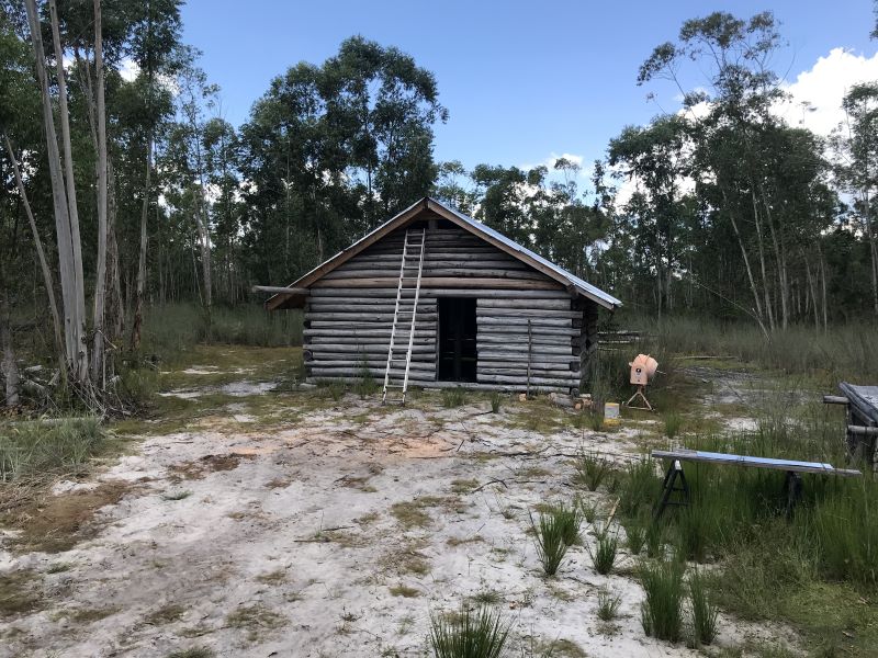

| stalal2525 Member

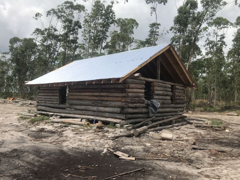

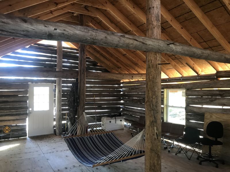

 | # Posted: 11 Apr 2020 04:43pm - Edited by: stalal2525 Reply

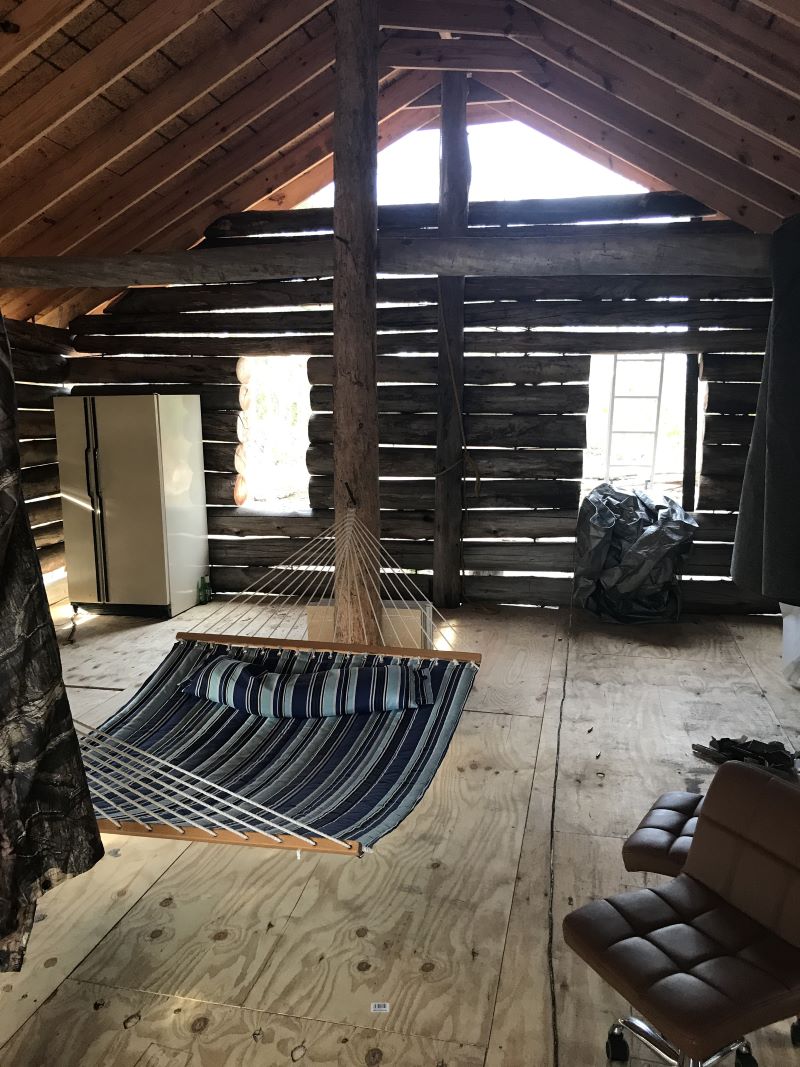

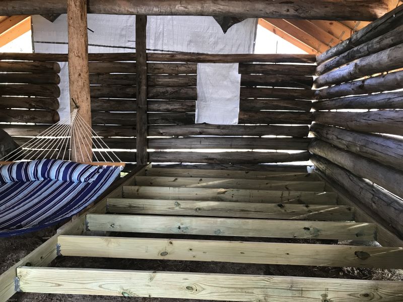

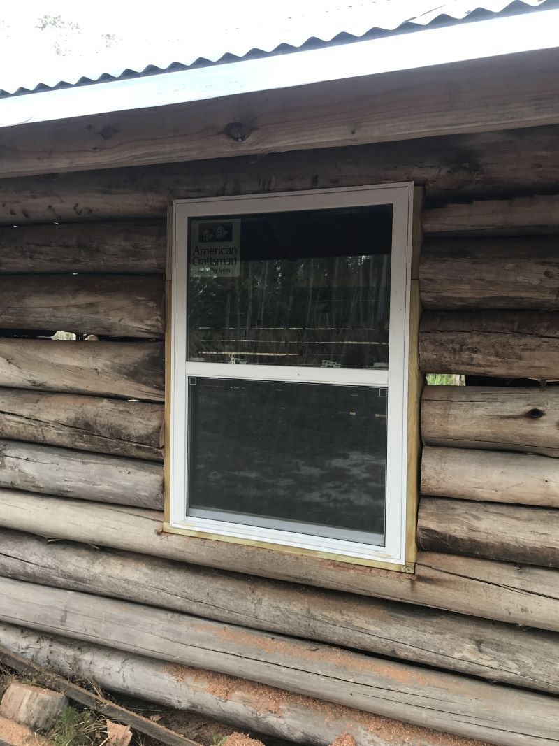

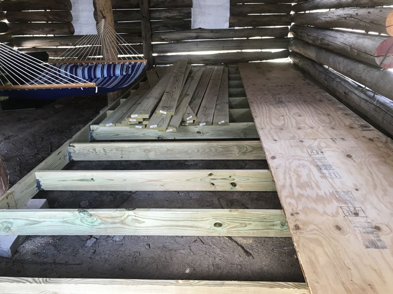

 It has been almost a year from my last update. I did not have much time to work on my log cabin as other stuff was a priority during last year, but I did work a little bit on the cabin. Here are more updated pictures.
 I finished roof, floor, installed front door and windows. Next step will be to fill up spaces between logs with cement mixed with lime.
 I did not stay over night in the cabin yet but I shoot few hogs from window of the cabin. It fills much safer inside the log cabin during hunt when 15- 20 big wild hogs come  to feed at night and you are sitting in the tent with rifle.

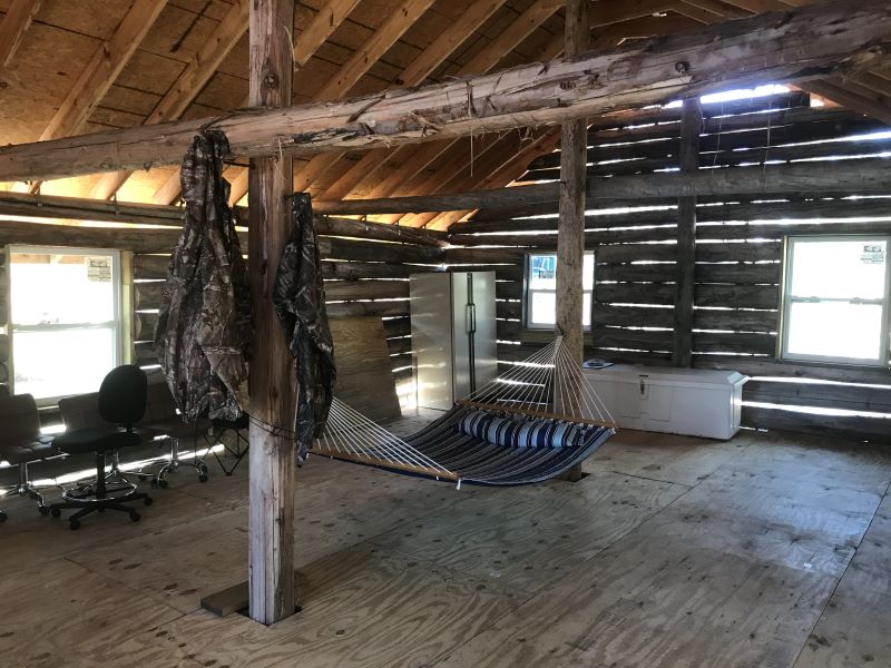

| stalal2525 Member
 | # Posted: 11 Apr 2020 05:10pm Reply
 Here are some more updated pictures from February 2020

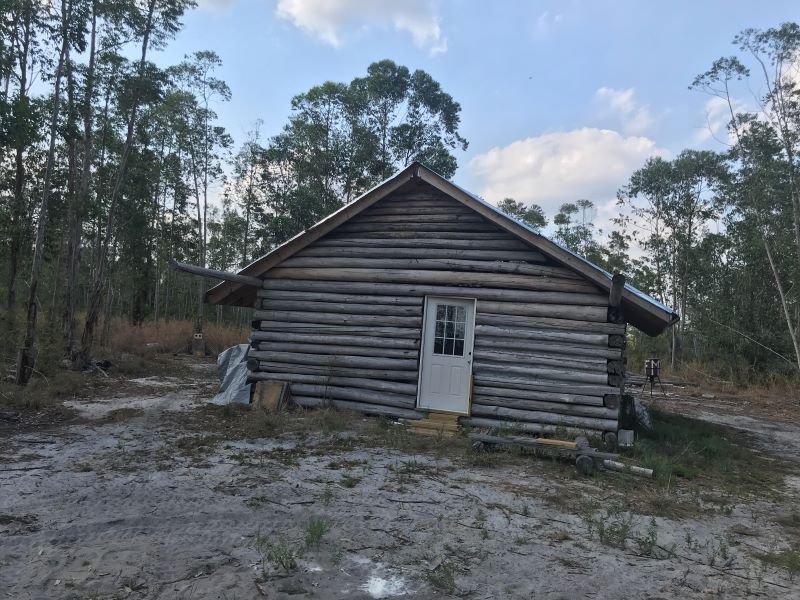

| stalal2525 Member
 | # Posted: 11 Apr 2020 05:17pm Reply
 Couple of more late pictures of March 2020
 I am building this cabin all by myself without of anyone help. It has been tough but it is coming together.
 What people do you think? Any comments at all?
