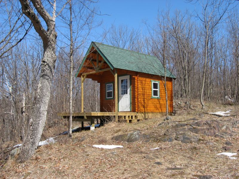

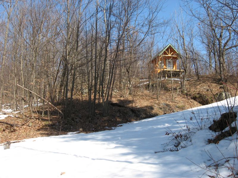

 I've been enjoying this site for a while now. Lots of great ideas and projects! Thought I should drop in, say hello, and post a few pics of what I've been up to in the last couple of years. In 09, my wife and I got serious about putting a "bunkie"cabin on our lake lot. After checking out a number of different ways of building small cabins, I settled on interlocking corners with the "logs" being 2" thick pine t&g boards. Although there was a fair bit of effort in cutting the notches for the corners, the whole structure is easy for 1 guy to build (in my barn) and then transport to the lot, and re-erect on site. I made the base earlier in the spring,  - digging holes for sonotubes(lots of fun!), beams and joists. It was good to have this initial work done prior to erecting the cabin in the early summer. I  numbered the "logs" when dismantling the cabin in the barn at home, and this made the job a lot easier when putting it all back together up at the lake. Had er up in just shy of 2 weeks... and wife,kids and I have been enjoying it since in spring to fall. Would like to check out a small wood stove, possibly to extend the seasons a bit! I made it just under the 108 sq. ft. allowed, and it has a partial sleeping loft with not bad clearance due to the 12:12(hard to work on!) roof pitch. My wife, kids and I feel blessed to have this little spot to enjoy God's creation. I have found this  website to be very addicting! thanks.

 nice looking camp, i like the log look............great view as well.

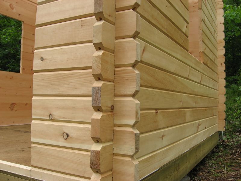

 Looks great!  We are in range fire country with no fire department.  So far we have been building with Hardi board siding for fire protection but we are tired of the same old look and are talking about doing something different for one of the structures.
 Do you have a closer view of how the 'logs' connect?

 Quoting: MikeOnBike Do you have a closer view of how the 'logs' connect?
 i like to see a close up of the logs as well.............

 Very nice! Can you tell us the outside dimensions?

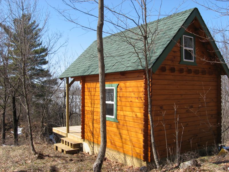

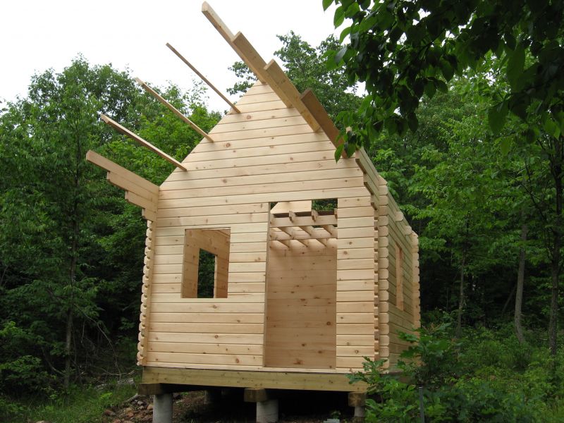

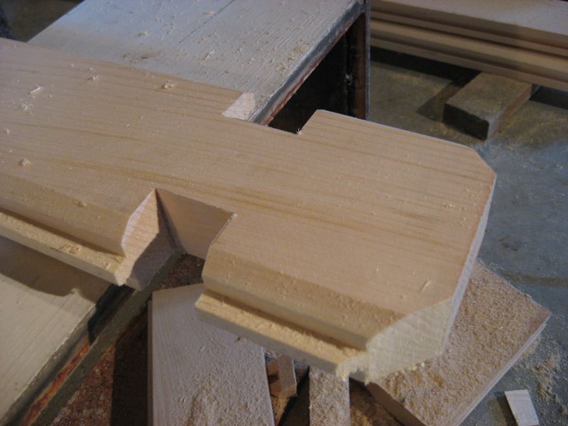

 Thanks for the comments. Here are a few more pics to show the construction. The size is 10' x 10'-8". It was fairly simple to re-erect on the base.  The last picture shows the progress for the first day up there. I went with the 2" thick "log" construction for a few reasons.., a finished wall on the inside, more interior floor space, and the log look on outside, plus the strength of the interlocking corners. Drawbacks might be that you only have a 2" thick wall, but it is solid wood and even in the fall it's pretty warm inside. The nice thing about it was being able to handle each piece yourself due to less weight, size etc. I'm hoping to get around to other projects up there soon, such as a storage shed and firewood shed. Already had the out-house in place!... one of the more important structures!

 thanks for the pic's FINE JOB on the build...........

 Nice detailed work, Outdoor guy...the cabin really suits the surroundings.Really like the crossbeams in the porch...been thinking about something like that for mine as well...

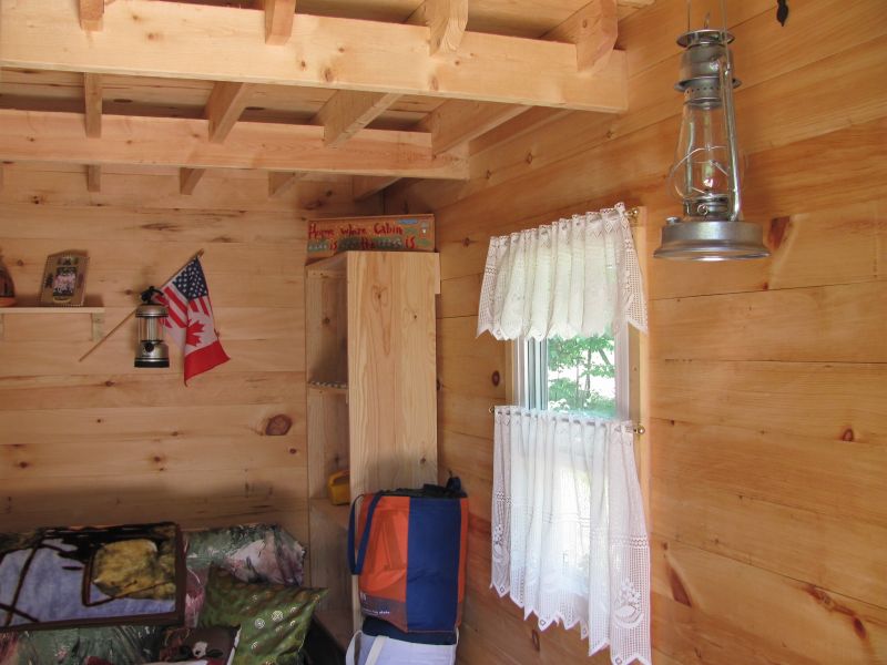

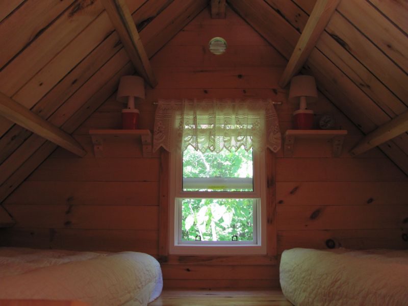

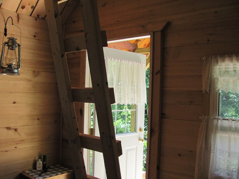

 Thought I'd post a few pics of the interior. Our two girls (twins!) have fun sleeping up in the loft, My wife and I use the pull-out futon on the main floor, our son gets the fold-up cot, and the dog has the mat at the door! It does get rather cosy... but so far there's been no complaints! In the morning the cot gets folded away, the futon gets turned back into the couch, and the ladder is moveable so we can get a fair amount of space again for the day. When we were thinking about building the cabin, one of our girls painted the sign you see in the interior photo..."Home is where the Cabin is". That about sums up the way we feel about being up there!
 Sorry to the Ontario cabiner's... we are located in central Ontario...we have to travel through "the Big Smoke" (Toronto) to get up there, but it's worth it.

 Very pretty cabin, outdoorguy.  I love the look of the interior wood.  Your view looks spectacular!!

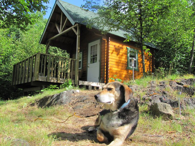

 |  Cabin with guard dog

 outdoorguy
 Wow! And wonderful. This is what it is all about.
 Thanx for the new postings.

 groingo -  nice place there! That looks like a great little stove. I've been looking for a small one, possibly removeable, too extend the seasons up there. We have been happy with the construction of the cabin. I don't get tired of looking at the wood on the interior. The time was mainly spent cutting out the notches in the t&g "logs",used a template for the corners/notches to keep them all identical then disassembled and rebuilt it on our lot.

 I think your cabin is very innovative. I love the interlocking logs. I noticed your roof (12:12) is the same as ours on a 12X14 base. I was straddling the peak yesterday putting the ridge-cap on. Since it sets on 6X6's about 3 feet high, it was a little scary "on the top" so I kind of get your comment (hard to work on). You should be very proud of her!     Old Old Buddy

 Thanks for the comments. The 12:12 pitch sure helps in getting a little more headroom in the loft. It's also great for shedding rain and snow.... although I also found out that it's great for shedding portable drills, hammers and other assorted things!
