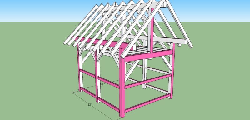

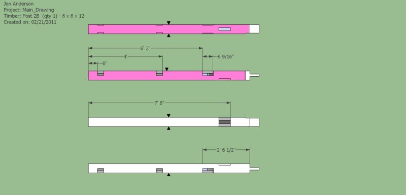

Posted my plan and all the shop drawings for 10' x 12' timber frame shed at the following url:
http://peelinglogs.blogspot.com/2011/03/timber-frame-plan10-x-12-shed.html
I have the file in SketchUp (used TF rubies to produce the shop drawings), if you want it, email me at fredrickpwanker@gmail.com.
Plan
Plan
Shop Drawing - Post
Shop Drawing - Post

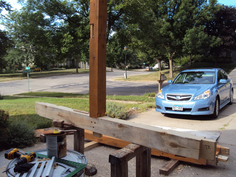

I finished cutting the timbers; started assembly.
Test Fitting King-Post to Tie Beam

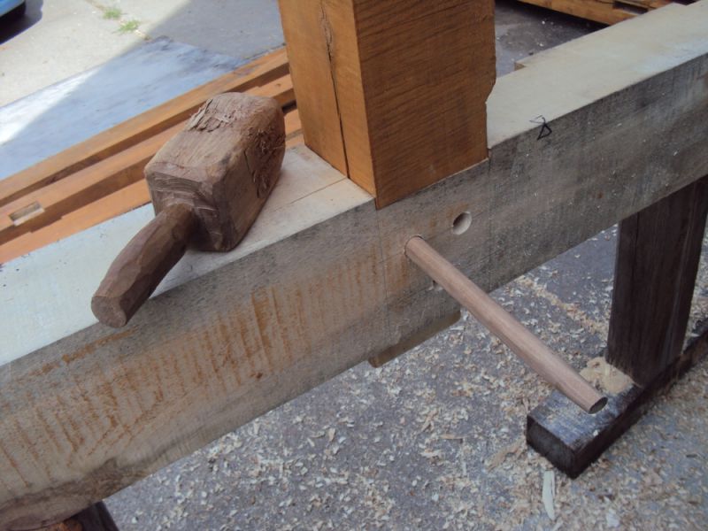

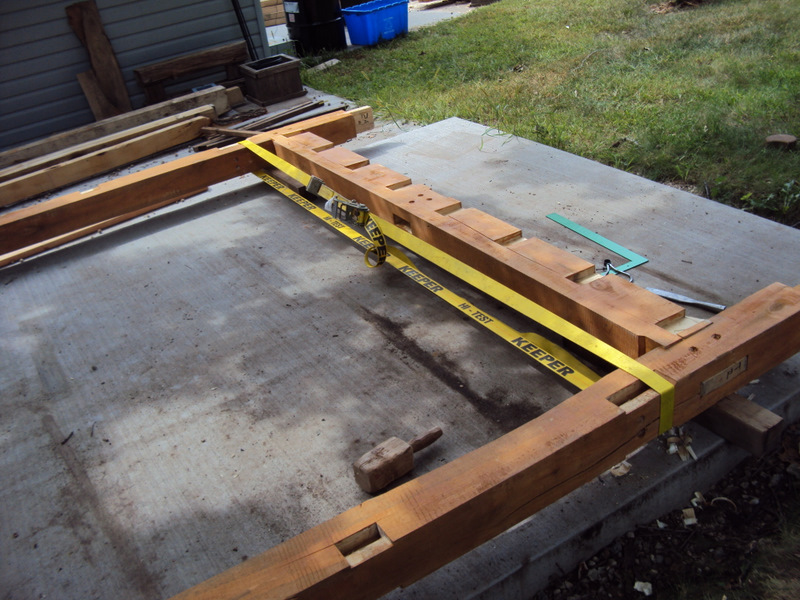

Assembling the First Bent (center)

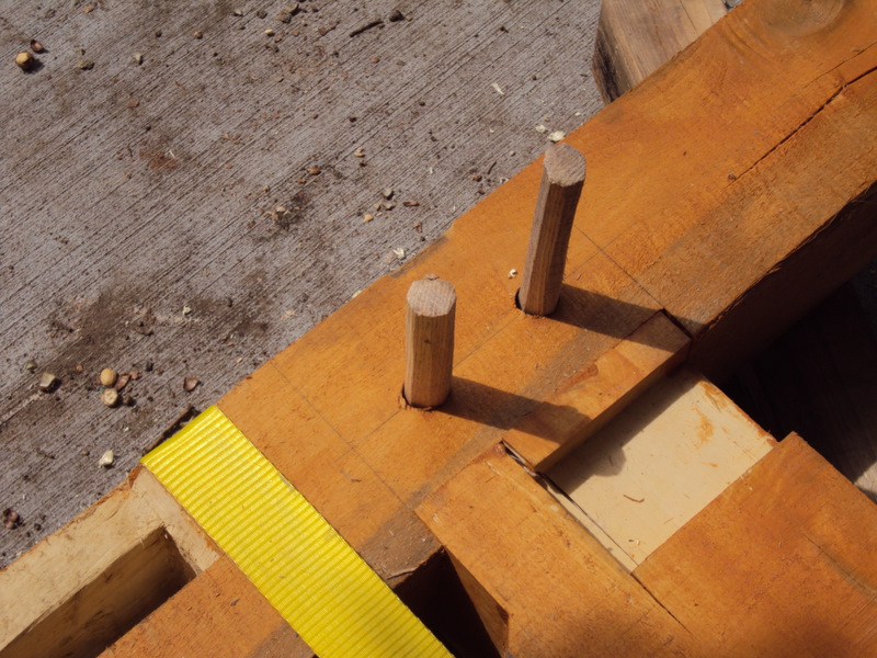

Pounded Some Pegs
Pounded Some Pegs

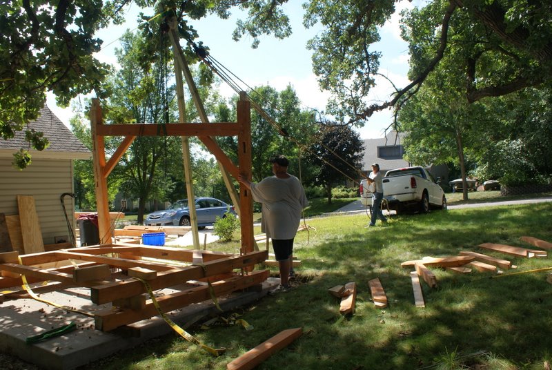

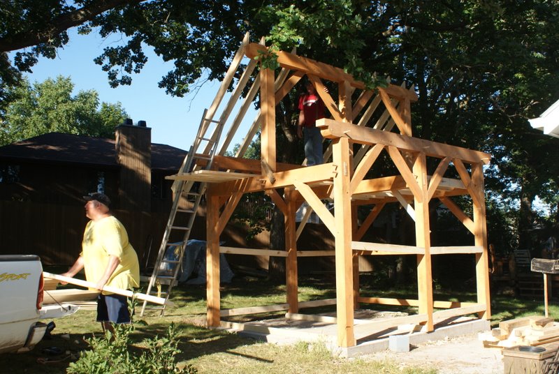

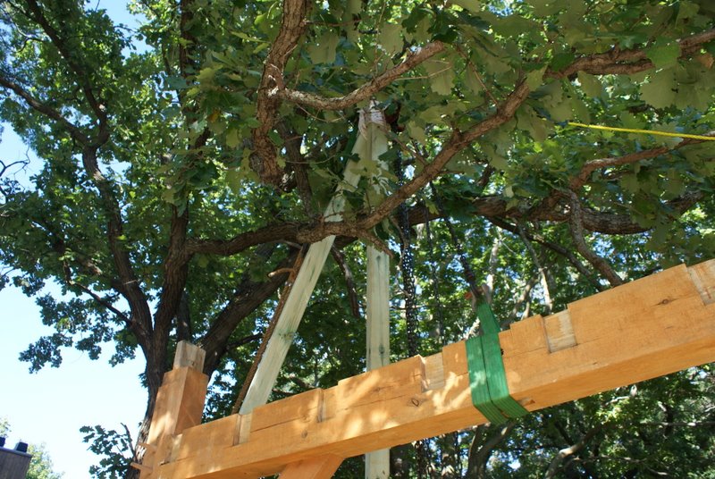

Raising the frame.
Raising the first bent
Lifting a plate
Lifting a plate

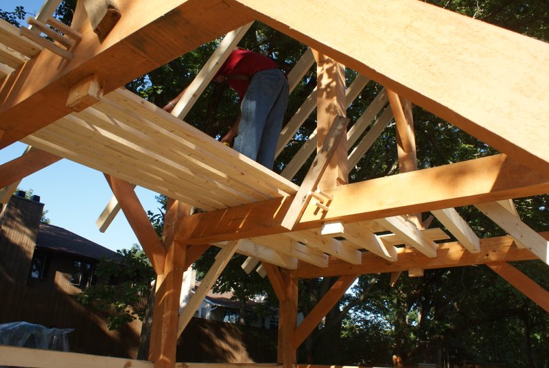

Installing rafters
Installing rafters
Loft joists
Loft joists

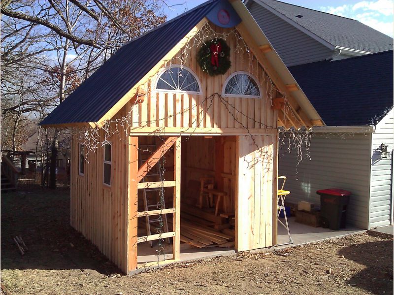

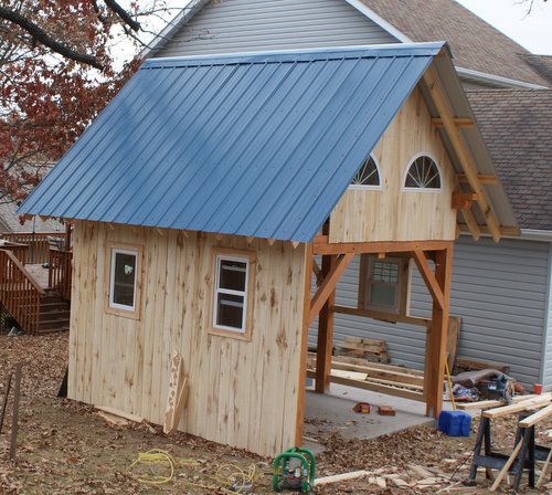

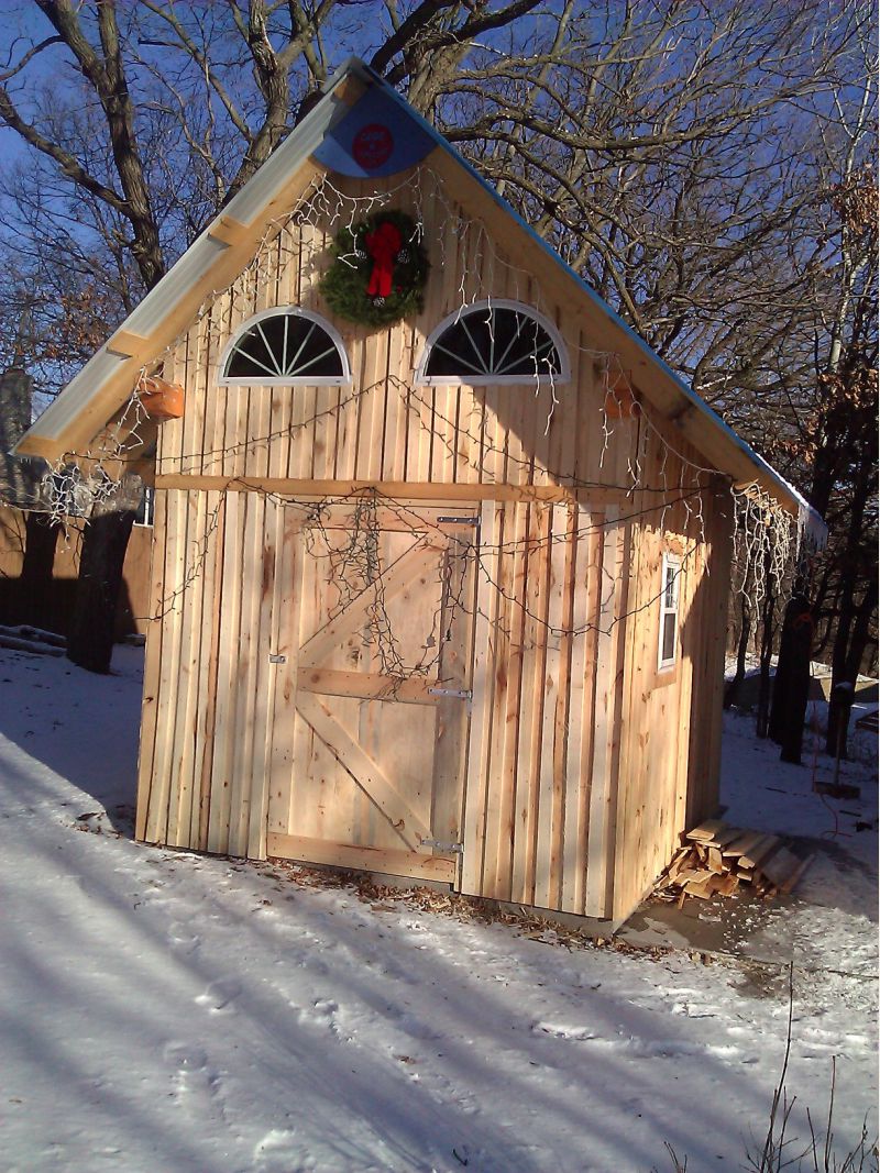

A little progress on the shed.
Board & Batten Siding
Front Windows
Front Windows
fpw
# Posted: 11 Jan 2012 10:31am - Edited by: fpw

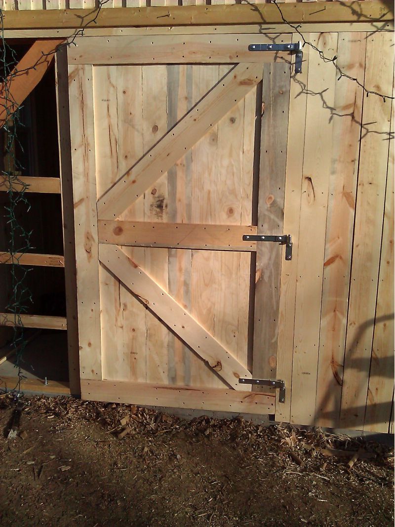

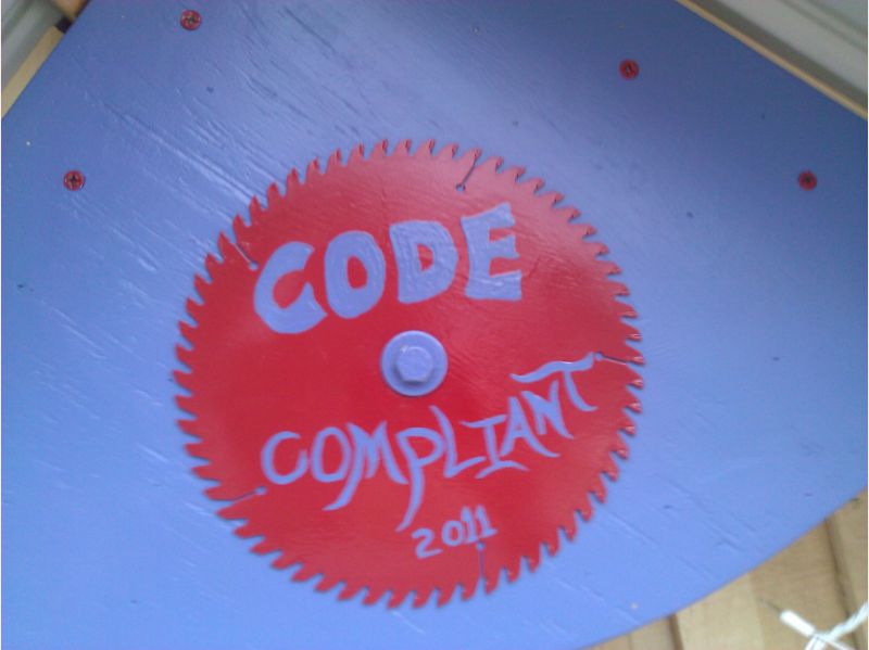

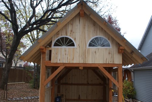

Finished up the shed. Put a saw blade on the peak with the letters code compliant as a present for who ever called the building inspector on me.
ErinsMom
# Posted: 11 Jan 2012 07:07pm
Love the windows and the door.
turkeyhunter
# Posted: 11 Jan 2012 08:07pm
nice job---like the sawblade as well--i bet it was you neighbor that turned you in-- they are bad about that.

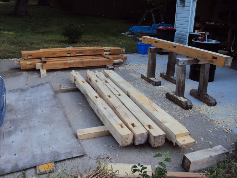

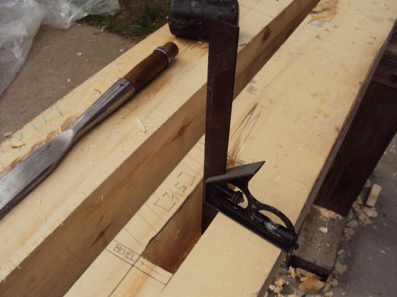

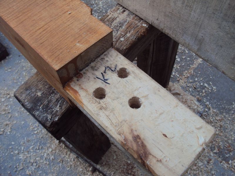

My current cabin is an ersatz timber frame (we cheated by using bolts with a minimum of mortises). For the floor of the loft in the cabin we will be experimenting with lap or haunched lap joints and maybe a dovetail. I will post pics. Can you post some picks of how you cut the mortises and tenons?
Our next job will be a small barn using real timber frame. I love the lifting sheave bipod. My main worry is getting the beams up so this will help.
fpw
# Posted: 14 Jan 2012 11:55am - Edited by: fpw

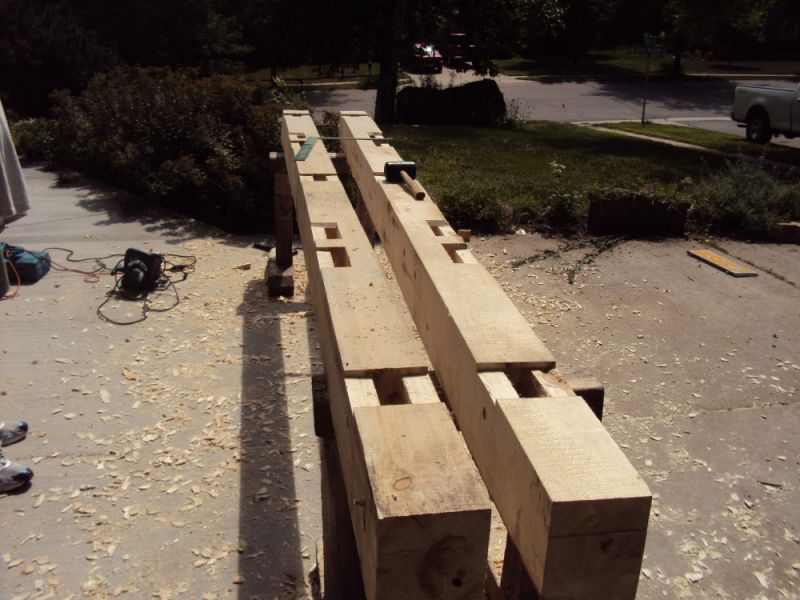

Cutting a through mortise
http://peelinglogs.blogspot.com/2011/02/timber-frame-cutting-through-mortise.html
Cutting knee brace
http://peelinglogs.blogspot.com/2011/08/timber-framecutting-brace.html
Rigging and Raising the Frame (really is easier than you might think):
http://peelinglogs.blogspot.com/2011/10/timber-framerigging-raising-frame.html
Also the ARMY lifting and rigging manual is of use:
http://www.petrospec-technologies.com/Herkommer/knots/FM5-125.pdf

Mortise
Mortise
Plates
Plates
Test Fit
Test Fit
Tenon (after drilling holes for drawboring)
