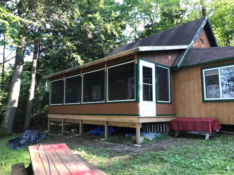

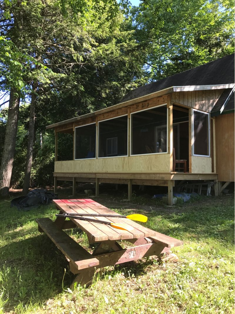

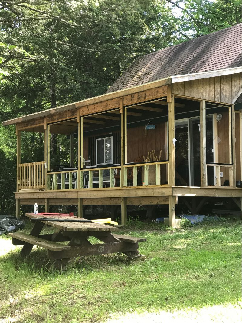

It's a late Spring in Maine this year. The mosquitos and black flies are really bad. So, I screened in our porch.
Thelar
# Posted: 10 Jul 2019 02:52pm - Edited by: Thelar
Still need to build some stairs.

# Posted: 10 Jul 2019 06:35pm
Oh that porch looks wonderful.
moneypitfeeder
# Posted: 10 Jul 2019 07:47pm
That looks great! you will be so much more comfortable enjoying nature (without being bit!). Your work looks really good and like it was always meant to be screened-in! Are you doing stairs tied into the porch and with footers or standalone?
Thelar
# Posted: 11 Jul 2019 03:00pm
Thanks fiftyfifty.
I will tie them into the porch.

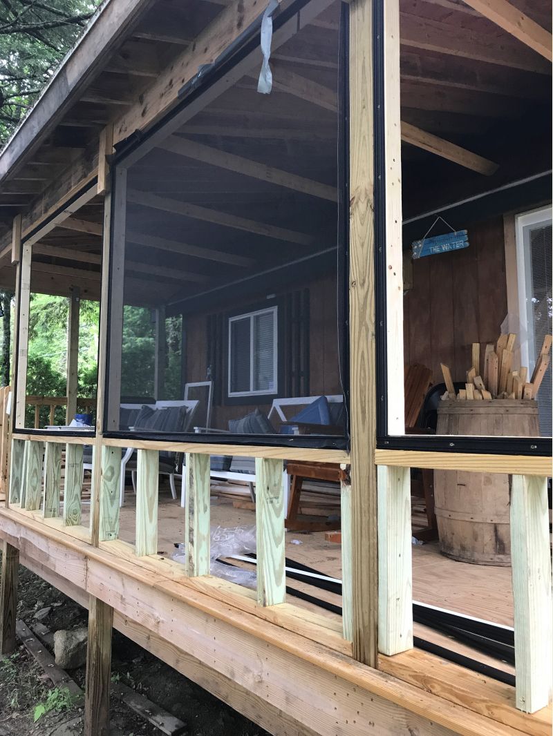

# Posted: 13 Jul 2019 07:51am

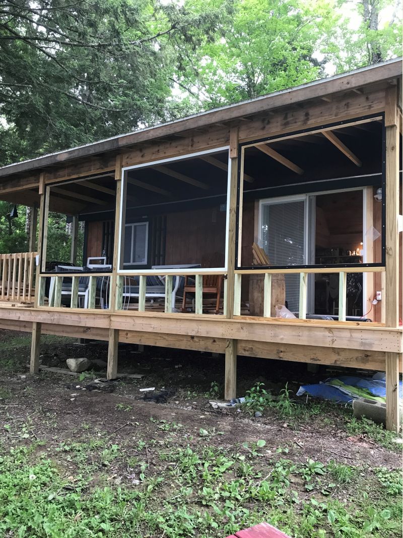

How did you seal up your floor or was it a plywood floor to start with, or deck boards a bit apart. We have a screened porch at our camp . Was origionaly a deck , the skeeters come up through. It has stopped the black flies and deer flies. Nice looking porch, good spot to sit and tell lies. old 243
Thelar
# Posted: 16 Jul 2019 10:33am
Hi old243,
We used plywood for that very reason. We picture framed the perimeter with 5/4 decking and then 3/4 plywood for the floor. Here's a pic. It is a little hard to see.
