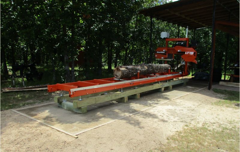

With 80 acres of never logged Oak and Hickory, and several upcoming projects, I now have a sawmill. I chose the Woodmizer LT15 manual sawmill, USA made with a solid reputation. I wanted a firm foundation but couldn't quite justify a steel reinforced concrete pad. So I constructed mine with a soil-cement system, 7.5' X 24' X 6". (w/ bedrock only 6" down, & very silty soil, I have an ideal situation) All supporting sills/sleepers are PT 6" X 6", anchored down & together. As shown, I'll be using one end of an existing shed roof as housing for the saw head when in storage. The photo shows a nasty piece of Cottonwood loaded on the mill, not good for much but perfect for practice. Now time to play lumberjack, reminds me of a Monty Python song.

Good looking mill. I have a portable mill as well. How are you handling your logs? If you build a bunk to put several on , at mill height it might work. I have a fork lift, to move my lumber. Sticker it as you cut it, so you don,t handle it more than once. Don't let your slabwood accumulate, keep it out of the way. Cottonwood makes excellent trim and mouldings. Cut on the 4/4 , 8/4 scale. sticker well, keep under cover so it doesn't stain. If you have good hardwoods, concentrate on them. I found that there is a market , for lumber, but people want it kiln dried. My customers are usually hobby folks.I bought a Nyle 50 kiln shortly after I got my mill. Does about 1000BF, paid for it , many times over. You will get lots of customers , wanting wood kilned. It will be full all the time. For good information, go to the woodweb site, then to the sawing and drying forum. Good luck and have fun. with your mill. old243

Thanks Old243, I'm using a 50HP Ford tractor w/ FE loader & grapple. It works well for me, but does limit me to about 1200 lb. logs. I plan on adding a staging platform & possible ramp or crane maybe. 'Also have a 3-point hyd. grapple for skidding. I'll be investigating kilns. With my own natural gas supply, that would match well.
I expect 90% of my cutting will be white & red oaks, with a few hickory thrown in. (No pine or spruce on my acreage.) And I expect to primarily supply my own needs. But we'll see how it works out.

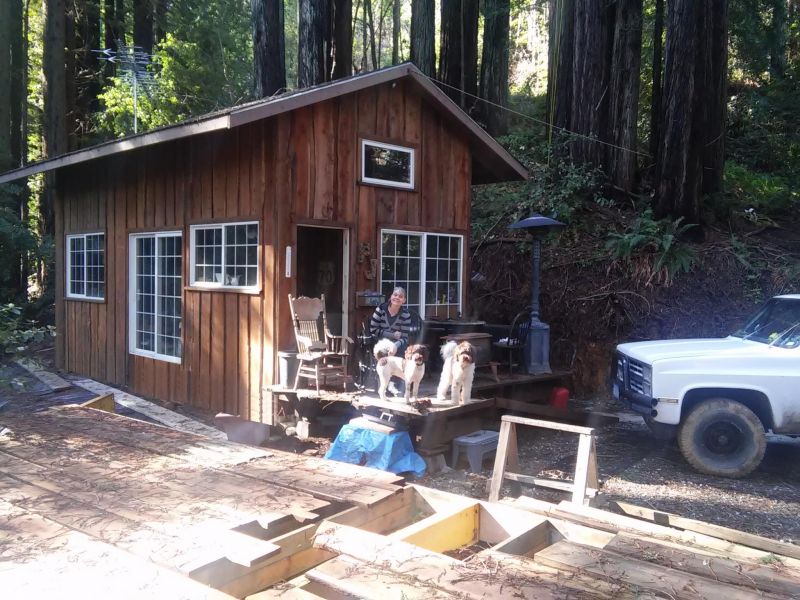

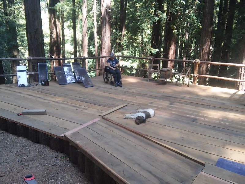

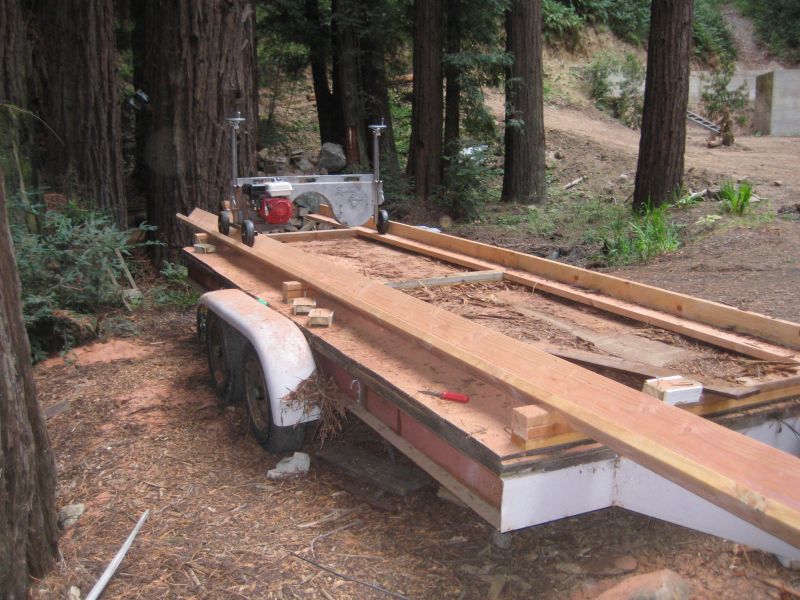

That's a nice looking mill with a large throat. I milled the lumber for the beams, siding and deck of my cabin with a small portable bandsaw mill. It was really too much for it but I got it done.
My neighbor had a Lucas mill, circular blade and chain for slabs. The nice feature that has was a rotating head, you could mill horizontal cuts, then flip the head 90 degrees and rip the sides.
Lot of hard work, I had people wanting milled redwood but I turned them down, rather save my strength and machinery for my own projects.![saw.jpg saw.jpg](https://www.small-cabin.com/forum/shared_files/uploaded/9219/127398_1.jpg) saw.jpg

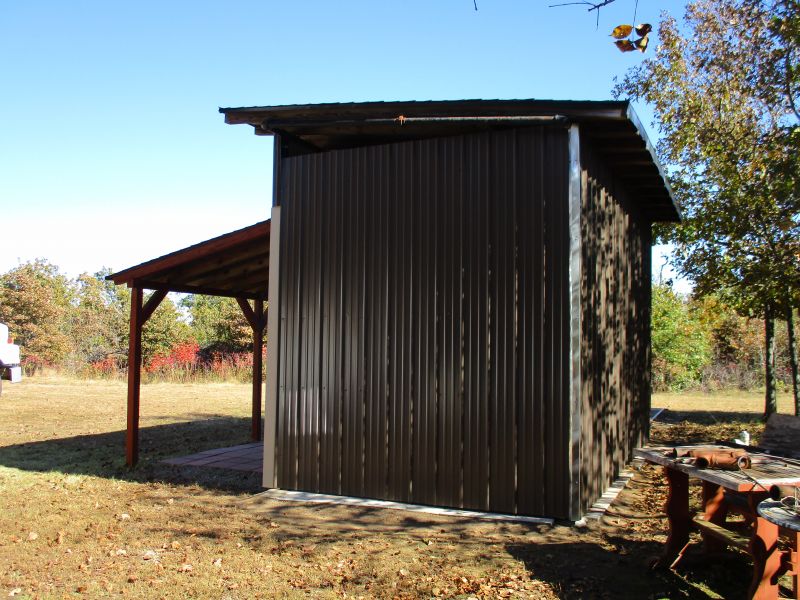

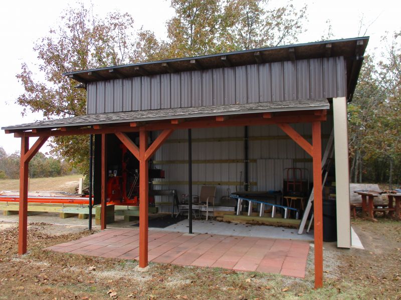

'Used roofing panels to finish-out the sawmill shed & then concrete on the floor. I was surprised at how well the 10 foot long steel sheets worked for the enclosure, with no maintenance or fire risk being priorities. So now, after a hard freeze, it's time to harvest some timber to feed the sawmill and prep materials for the new workshop.![Sawmill shed Sawmill shed](https://www.small-cabin.com/forum/shared_files/uploaded/9219/129851_1.jpg) Sawmill shed
