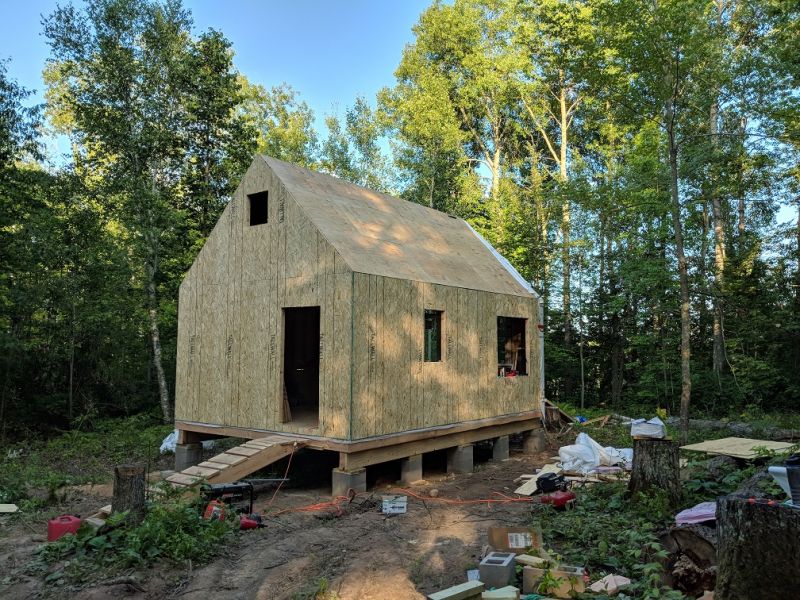

We got started on our cabin this weekend. Before Sunday, I had prepped the site, leveled block pillars, and built the 4lam 2x12 girders. On Sunday, it rained all day, so all we did was shuttle all the material back to the site. We started building Monday. Here's what we got done:
Monday: Built the floor box, put down the plywood subfloor, laid a layer of xps, added a sheet of plastic over all that, and put a layer of osb over that. We framed the walls, got the ridge board ready, and put up the first two rafters.
Tuesday: Finished framing the gable ends, finished all rafters, added the loft joists/rafter ties, and sheathed the walls.

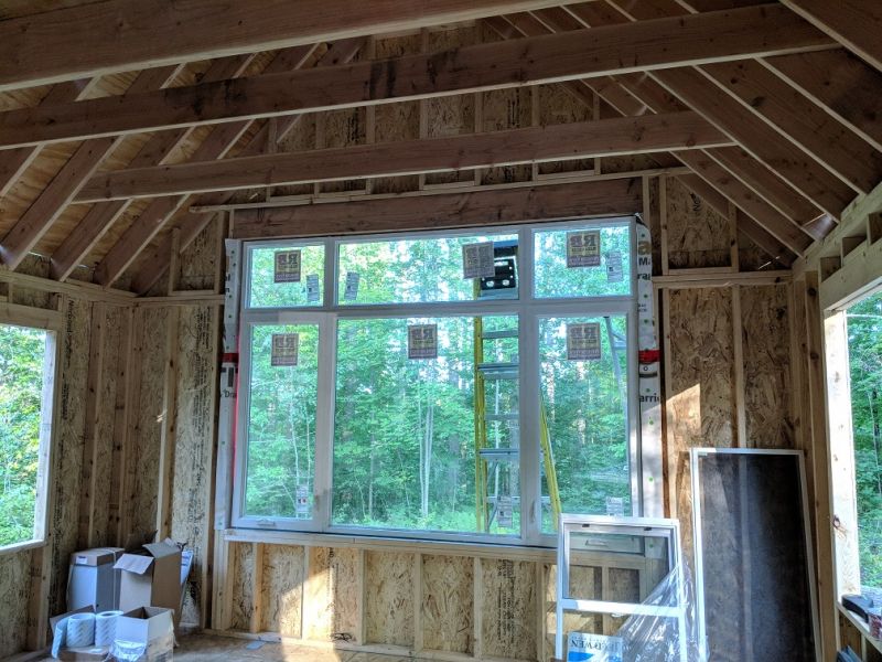

Wednesday: Finished sheathing the gable ends, sheathed the roof, housewrapped the walls with a draining housewrap, hung the huge 7x11 window in the end of the cabin, built a temporary ramp to the door, shuttled the rest of the material inside, and put a tarp over the roof until we can get back to it.

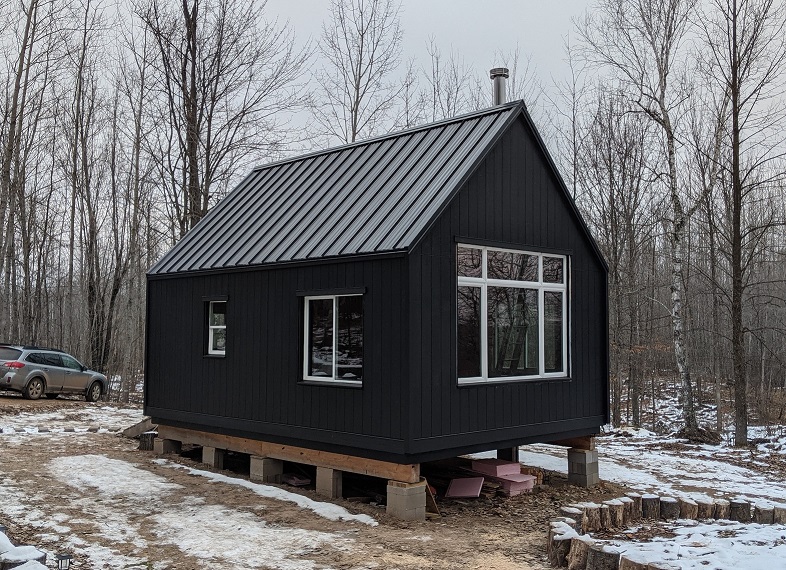

# Posted: 15 Dec 2020 12:19pm
It's been slow and steady on our cabin. Over this summer we built a shed, finished the insulation (all exterior foam) and exterior, graded the yard and driveway, and the roof is finally completed. It looks pretty sharp.
All my pics are on instagram under the hashtag #mygrousecamp

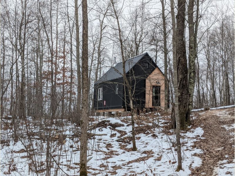

cjm So you just have blocks stacked on the surface of the ground or are they buried to some degree?
You recent pictures it looks like (particularly the front corner of the 2nd picture) that your beam is blocked up with wood. Was that intentionally from the get go or did something settle over time already?

Willie - we dug out the top soil down to gravel, filled with gravel and tamped it well, and stacked the concrete directly on the gravel. The wood you see was just to get the beams level in the first place. There is at least a thin piece of treated wood and/or a vapor barrier and shingle between the blocks and beam at each point because the beams are not treated. It definitely has not moved at all - granted, this is only the second winter. I'm pretty confident it will work for the long haul though... the water drains away from the cabin, the soil is gravel and dries quickly, and we have gutters on the roof. And if it did heave at all, the beams are 4lam 2x12s, so I think it would stay solid.
# Posted: 16 Dec 2020 08:16am
You could always put skirting around the eve ends of the cabin to stop the water splashing against the non PT beam.
