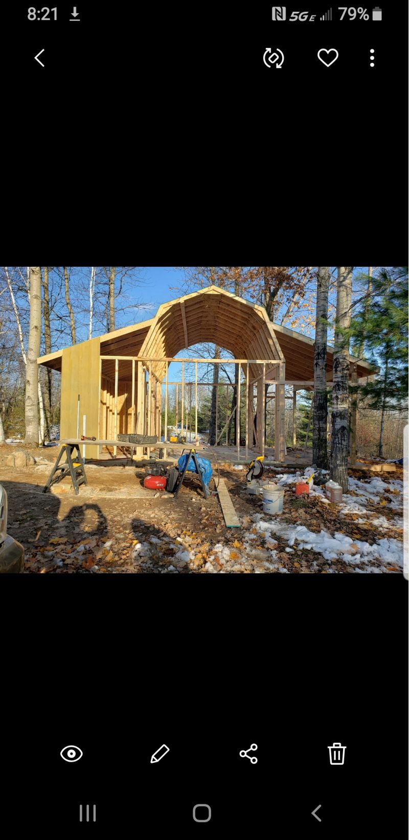

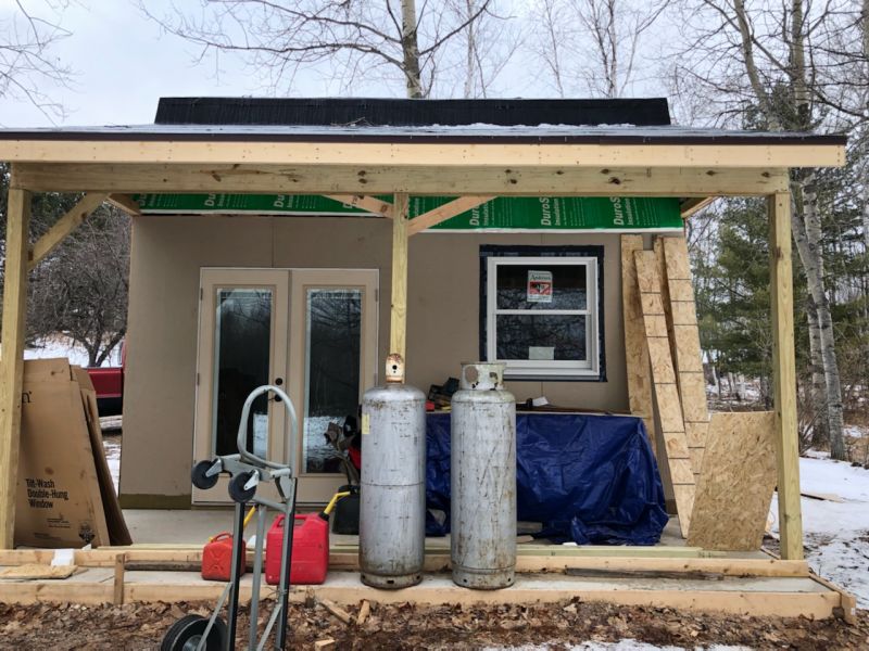

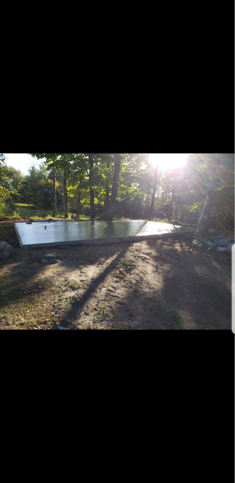

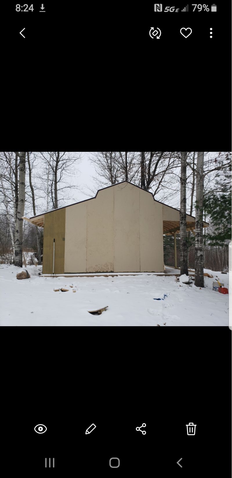

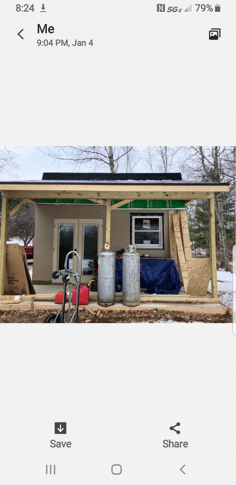

Here are some pictures of our 12 x16 it's been alot of work getting to this point. But definitely worth it! We excavated everything and only hired out the concrete pad pour which was done by a friend and his crew! I built the trusses at home and left them in two sections to haul up and complete them.![Screenshot_20200118.jpg Screenshot_20200118.jpg](https://www.small-cabin.com/forum/shared_files/uploaded/9540/131620_1.jpg) Screenshot_20200118.jpg

Are the "wings" part of the 12x16, or just the center part? Looking good!

Why go with a gambrel roof if your just going to add onto each side?

One side is added space and the other is a covered porch

Man I like it ! Don’t know if I’ve seen that design before. Good luck n enjoy your build.

For the additional loft space for a bedroom

Thank you! I got the idea from shedking.net but customized to my wants and needs
