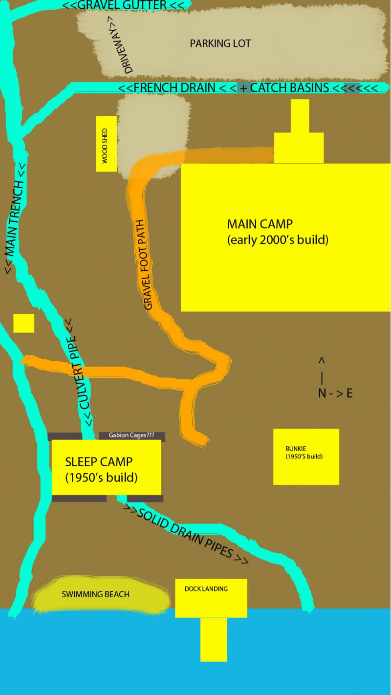

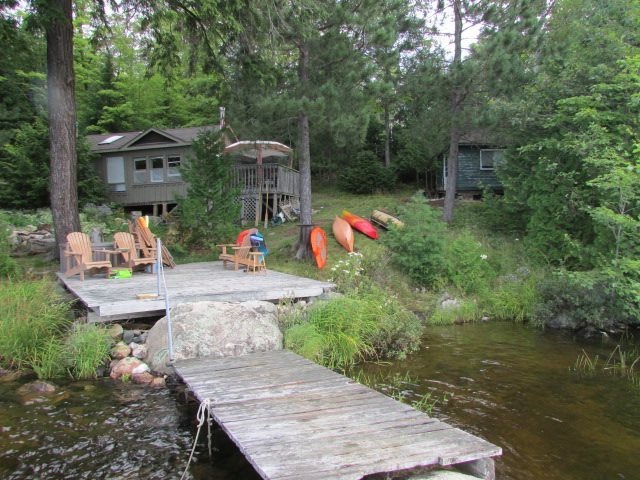

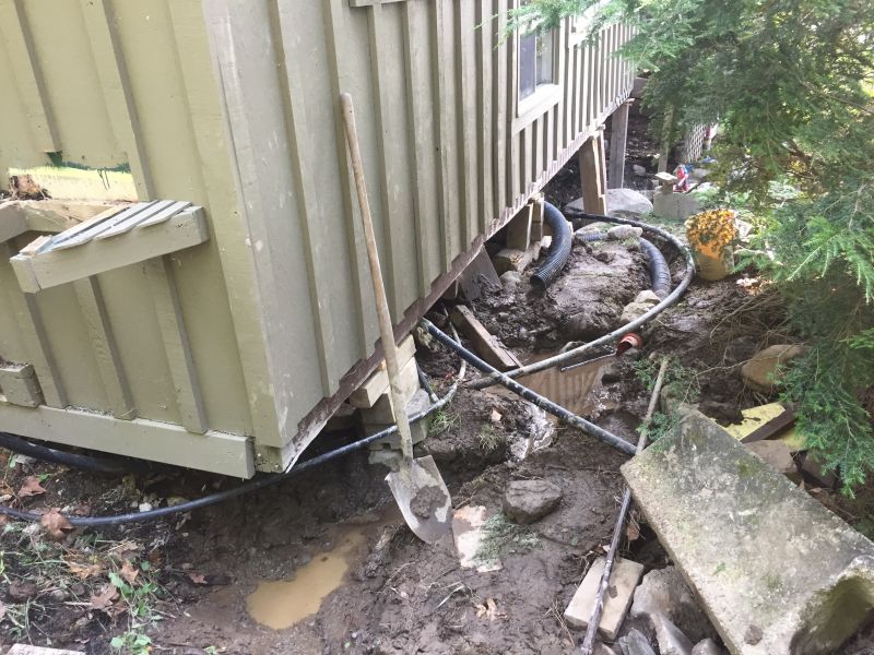

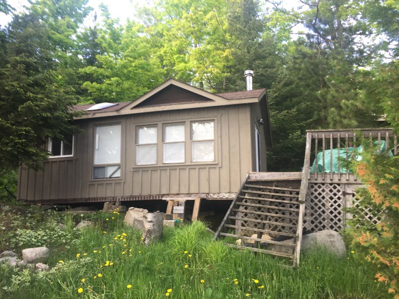

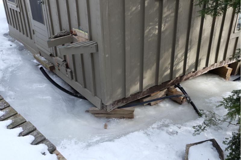

As you'll see in my very crude birds eye property drawing and a few other pictures attached, we inherited some serious drainage issues and resultant frost heave with the placement of the Sleep Camp, which was the first structure built on this property in the 50/60's. It's still in usable condition, feels worth trying to rescue. Unfortunately, it's right in the middle of where all the water from up the hill wants to drain out to our lake.. The original large concrete pilings it stood on have been long churned out by the frost heave, so every year we have been re-supporting it with whatever is lying around.. very messy.
SO. We are going to make every effort to control the water as it makes its way down to the lake. French Drain + Catch Basins along southern edge of the parking lot, as we have experienced some water pooling up there. And with a small backhoe rental, we'll dig a trench above and west of the sleep camp to install culvert pipes / french drains and do whatever possible to dry up this area.
My main question to the group is, what type of foundation should we replace this with??? I was wondering about building some Gabion Cages around the base, but I suppose, even with drying the area up.. we will still have to contend with some frost heave. Difficult to install much under the existing structure though.. I would be so grateful for any ideas and recommendations you may have. Thank you!

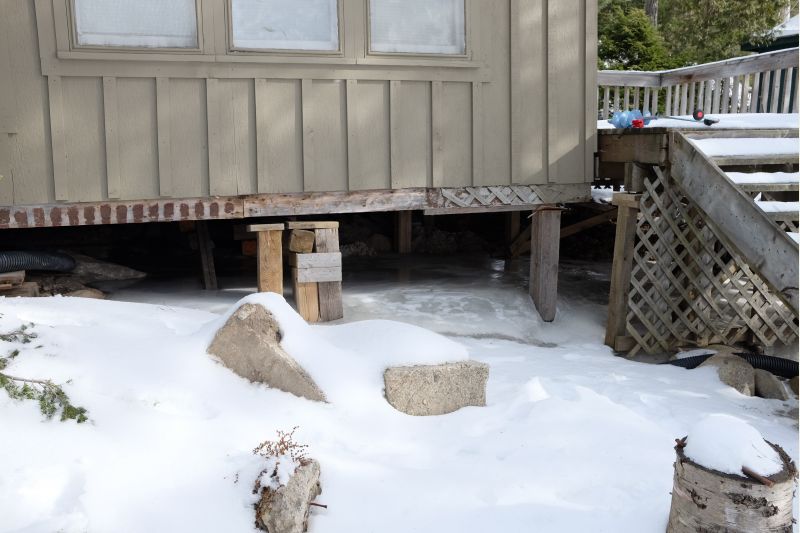

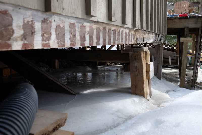

Here are a few more pics of just how bad things can get in the winter, as water piles up and freezes around our cabin supports.
