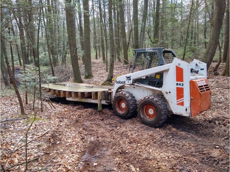

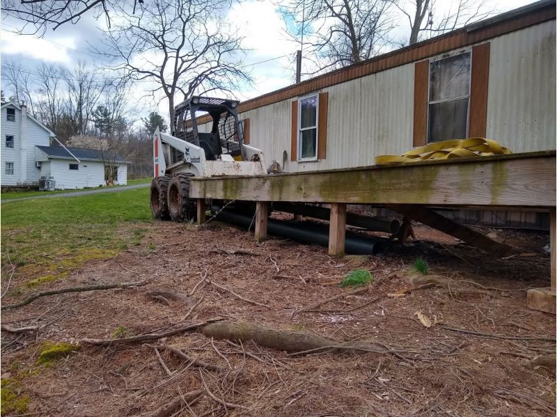

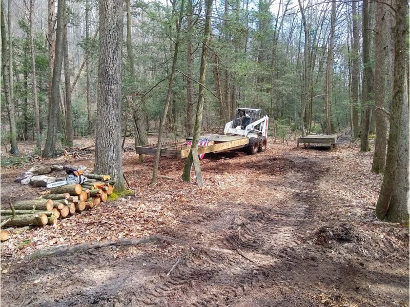

 There is an abandoned single wide trailer that was used while our sister in law built their house with a 12x16 deck.  We are currently trying to get rid of this trailer (if anyone wants a free trailer let me know!)  and a perfect first step was getting rid of the deck, so I decided to attempt to move it down to the build site and use it as a platform.   I couldn't get the full size deck down our trails without removing a lot of trees, so I cut it in half.  Luckily the way it was built made this pretty easy as I didn't have to cut any joists or beams, just disconnect the joists from the beam running along the center.

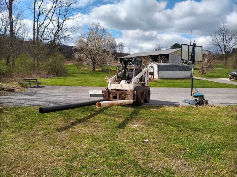

 So we got it disconnected and I used the forks for the bobcat, along with some PVC piping to extend the forks, and a chain and come a long setup to secure it and move it down to the build site.  Redneck 101!

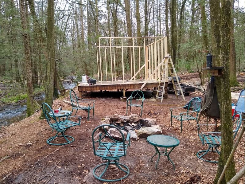

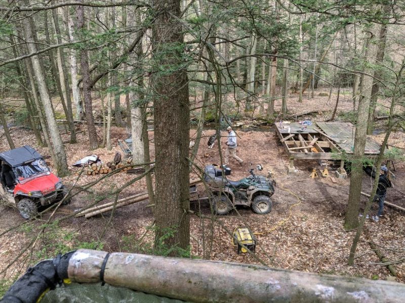

 I went back and forth on how to handle the foundation, and we decided that we were going to keep this build simple with the goal of having it completed by the end of the quarantine.....So i just buried blocks and set the 4x4 posts on them.  I am going to attach it to the ground with a mobile home strapping setup.  I do realize we will need to re-level this occasionally.
 So after getting it down to the build site, reconnected, set on blocks and leveled.  I started to reinforce the structure as it wasn't the best built deck I've ever seen and there was some rot, especially in the deck boards from leaves laying on it for years.
 So that is where i'm currently at, next up is replacing the deck boards and framing it.  We have acquired some large billboard tarps, and plan to temporarily use them for the roofing and siding while we finish the inside.  I have access to a sawmill so we are going to be cutting lumber for rough edge horizontal lapped siding, and i'm currently scrounging up enough metal to put on the roof.  But for now we are going with a hybrid tent/cabin that we will eventually close off more formally.
 The deck is 12x16, we are going to make the "cabin" 12x12 with a 4x12 covered deck overlooking the stream.  We are going to frame and finish the front wall overlooking the deck/stream with a door and 2 windows immediately.

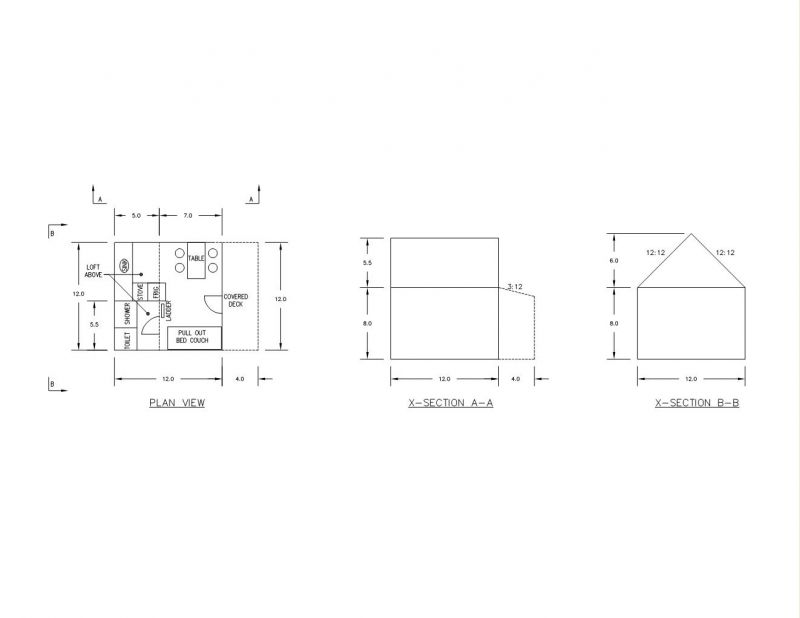

 Here are some pics of our progress, along with a sketch of the plan/structure.

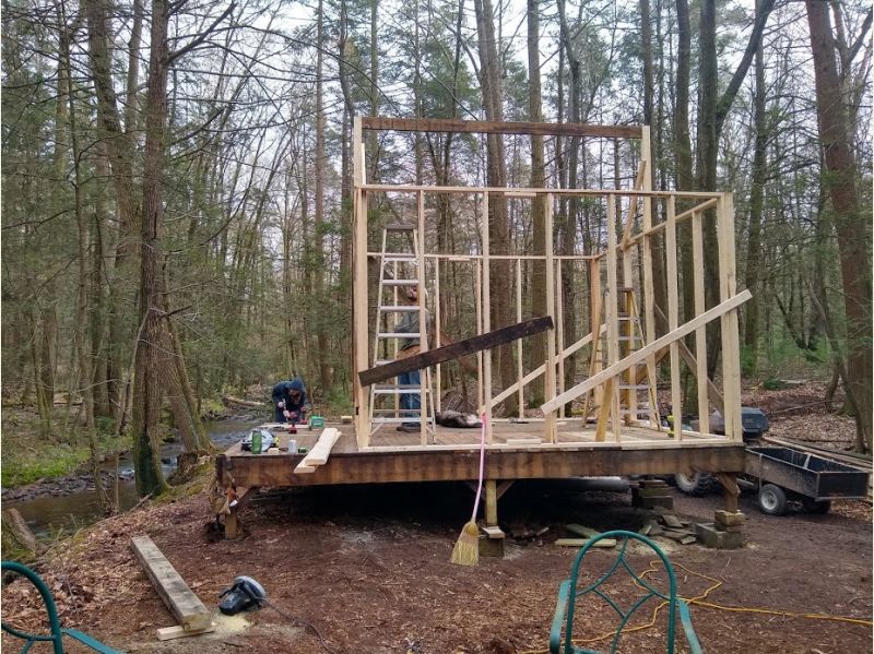

 I worked on the mini-cabin Monday and Wednesday evening after work (I am lucky to be able to work from home).  Monday I shimmed the posts to get everything as level as possible, and then put in a lot of nails in the posts and joists to make sure this thing isn't going to fall down.
 Wednesday I put 45* braces between the posts and the rim board, it really tightened the structure up.  I'm also 3/8" from being perfectly square, corner to corner, i'll take it on this project especially after moving that deck!  Then we started installing deck boards, ended up being a few short.

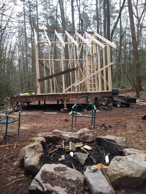

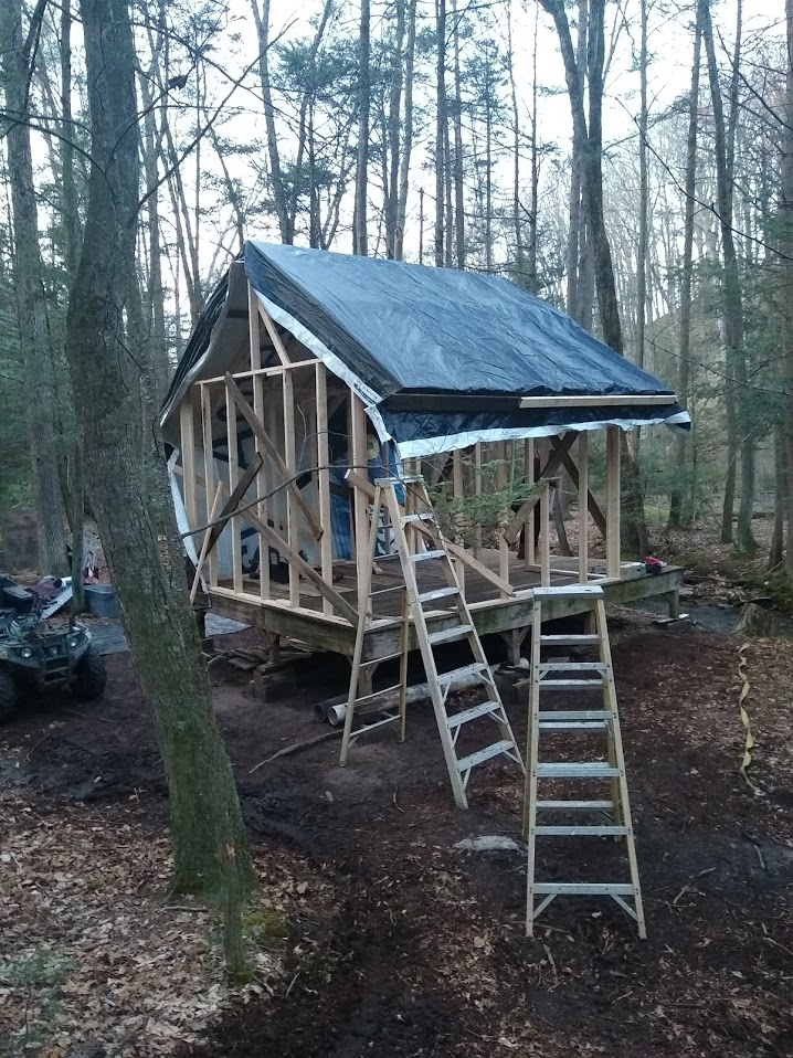

 Well I made good progress on Saturday, but sunday was a washout....My brother didn't get there until 1030 on saturday and left around 5.  I was up at 530 and working by 7, and stopped work to relax around the campfire around 730..
 Got the walls up, ridge set and rafters installed....then braced everything up and ran out of time/energy....
 Worked on it Monday and Tuesday evenings, adding supports, collar ties, nailing everything, installed stairs and doing some interior layout design...Just making it secure and safe...
