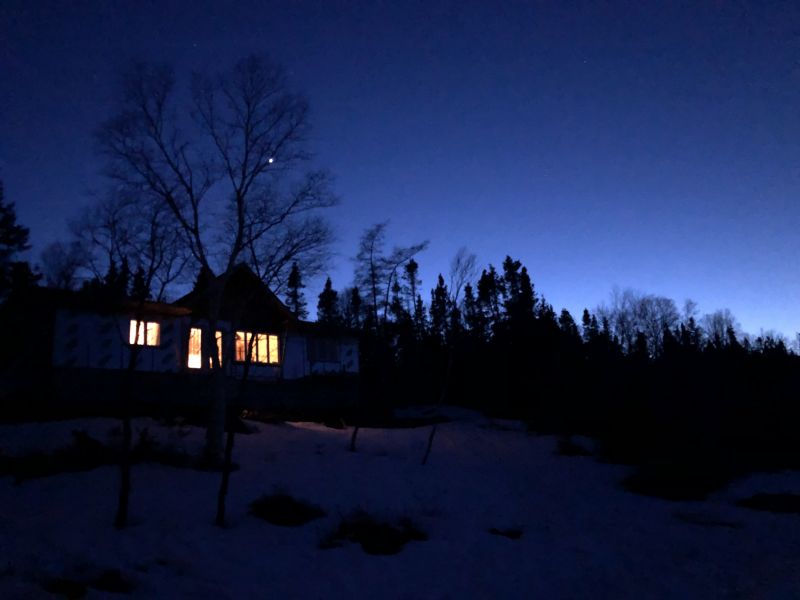

Shot of the cabin at night
Cabinnight
Cabinnight

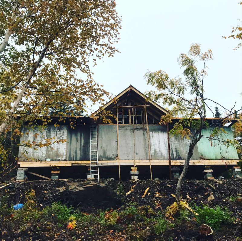

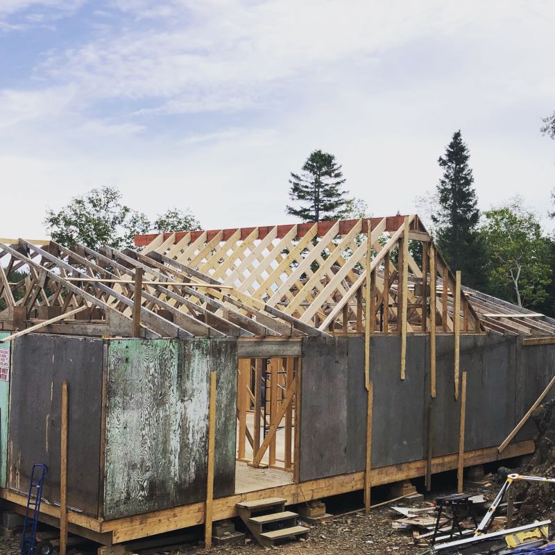

Shot of the recycled walls and roof framing started and front shot!
Roof framing
Roof framing
Front build
Front build

That's not a cabin that's going to be a cottage/home. I started looking at the website. Are your pads just on dirt/rock or are you on bed rock there? Also I think you mentioned you only went with just 2x6 floor joists?
Newfoundlandcabin
# Posted: 21 May 2020 09:00pm
We made 8-12” deep concrete pads poured on site with rebar drove down as far as we could. But yes, it’s all on bed rock. The front of the cabin has a bit of built up land but it’s all rock from the outcropping behind the cabin. I rolled it in with the excavator over and over. Hopefully it doesn’t shift.
The joists are all 2x6. Mostly from logs we cut. They are all spanned based on span tables I found on this site or online. Nothing for than I think 7 feet. All 16” OC. If I had more $ I would have went 2x8. So far so good lol. I’ll post some more photos soon.
