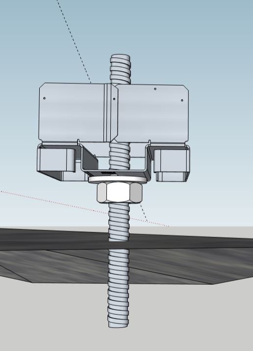

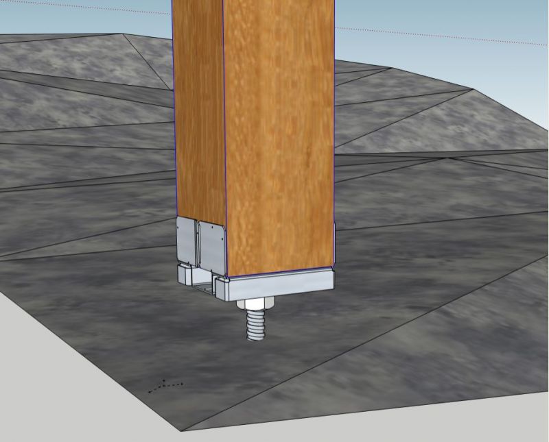

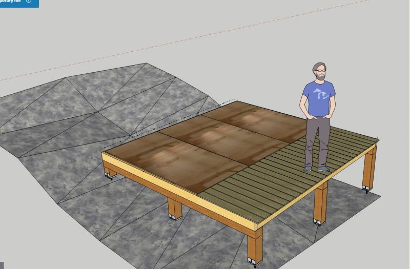

Hi everyone, I plan to build a 8X12' cabin in norther Quebec (Canada). The site is on a private lot owned by my parents. The ground is a uneven bedrock so I thought the best way to have a solid foundation would be to anchor the cabin right to the rock with 1' threaded bars and pressure treated 6X6.
I'm going to drill 9-1'' holes of about 6'' deep, then insert the 2' bar with some high-strength epoxy adhesive. Then, I'm planning on drilling a 1'' by 1' hole at the bottom of my 6X6, cut at different length, and mount them on my rods with some nuts/washer and metal plate. I'm hoping I will be able to do some adjustment/levelling on my base structure this way.

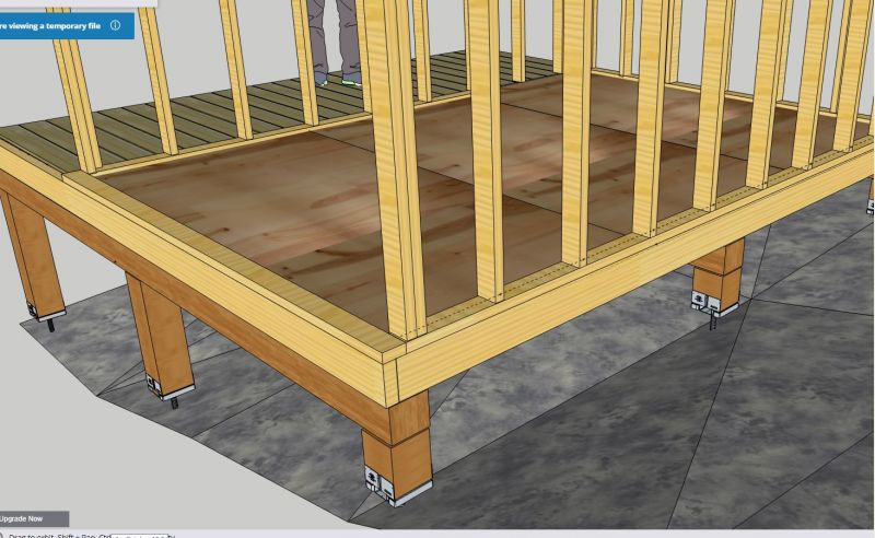

Base structure = 12X12' Cabin = 12X8' with a loft![Anchor Anchor](https://www.small-cabin.com/forum/shared_files/uploaded/9775/134873_1.jpg) Anchor

WinterSon Your set-up seems ideal. If the 1" is tight you could drop down a size on the threaded rod to 7/8", or just hammer the thing in a bit, I don't forsee that being a problem. I don't see the hole for the rod being likely to decay quickly, maybe if the metal is at the dew point and condensing water you could just stick some sort of gasket on the end of the post so that the portion of the rod in the cavity is not exposed to outside air, but I doubt there will be enough air circulation to allow much moisture to condense out in that space and wick to the post. Other thoughts would be to fill the cavity with spray foam or something compressible like that to remove any voids.

This is exactly what we did. I believe we used 5/8 rod. Have a look at our YouTube channel, the build and stair videos show how we anchored our cabin. My advice is use a Hilti hammer drill. https://www.youtube.com/user/OntarioLakeside/videos
Ontario lakeside
# Posted: 28 May 2020 23:47
By the way, five years in and the structure is dead level. Best foundation ever!
