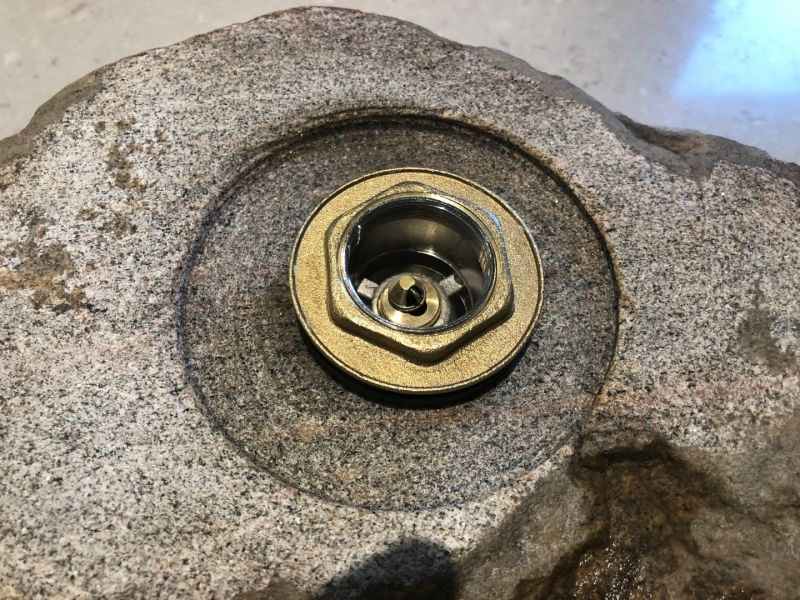

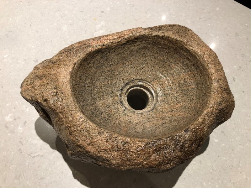

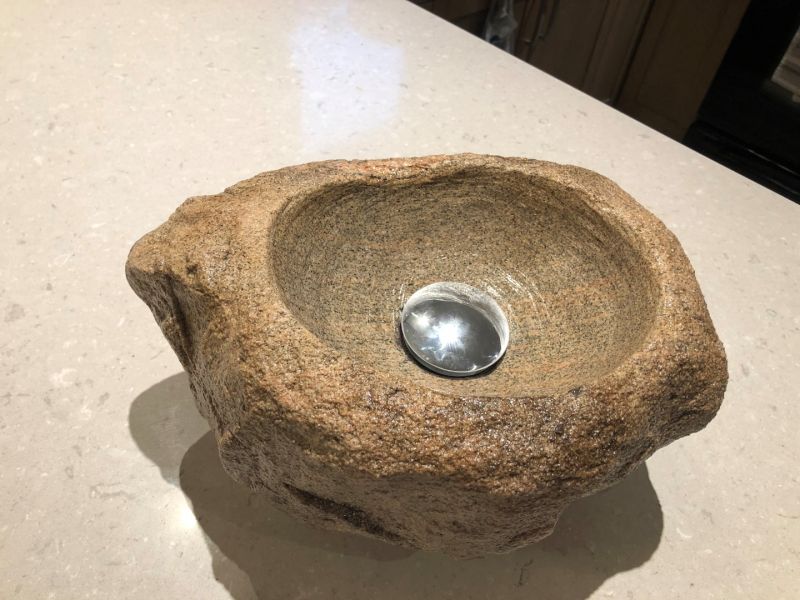

I'm building a very tiny bathroom in my cabin and was having a lot of difficulty find a sink that was small enough and wasn't crazy expensive. So I found a nice rock on the property and pulled out my angle grinder. I did have to buy a couple of somewhat pricey bits. So my "free" sink isn't exactly free. Now I'm set up to make other things. I'm working on a couple of granite book ends now. The sink only took me a couple of hours. I sprayed it with some clear acrylic enamel. I think it turned out pretty nice. Can't wait to install it this weekend.
Finished Sink
Finished Sink
Drain Hole - Top
Drain Hole - Top
Bottom
Bottom

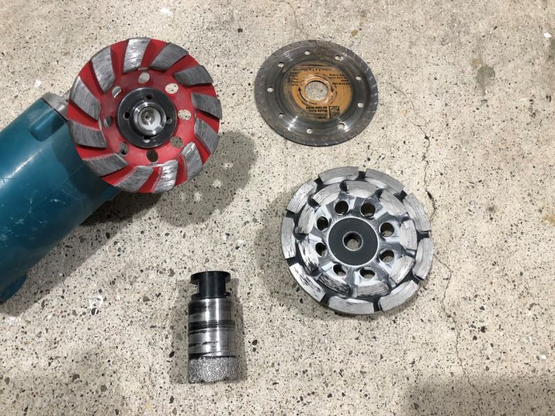

Nice! Got a photo of the bits you used?
Make a matching soap dish.
KelVarnsen
# Posted: 27 Jul 2020 08:32pm - Edited by: KelVarnsen
Here is a picture of the bits. I'm still waiting on some polishing pads in various grits. They are on the slow boat from China. The sink pics are just the rough grind. Once I clear coated it I thought it looked alright. Don't know if I'll ever get around to polishing it now. We'll see when the pads come in.
Links (Canadian): Hole bit, Grinding Disk 1, Grinding Disk 2.
Angle Grinder Bits
Angle Grinder Bits

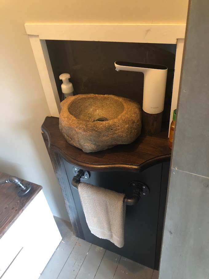

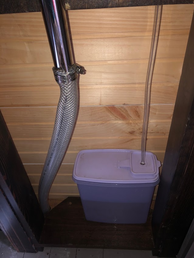

I just remembered that I started this thread and thought I'd follow up with a couple of pics of the final product. I thought it might be a good setup for someone's outhouse. The water pump is just a USB rechargeable pump that pulls from a reservoir. We mostly use the sink for tooth brushing. The water just drains under the cottage.
Final Product
Final Product
Plumbing
Plumbing

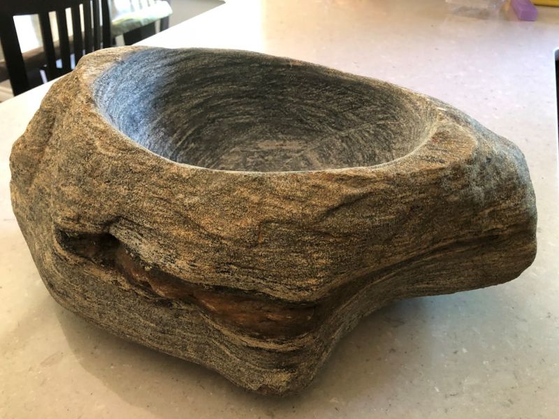

This is actually version 2 of my sink. The rock that picked out the first time turned out to be a bit too big. The first one was a black granite and seemed to be a much harder rock. It took me 4 hours of grinding. The orangish one was a lot quicker to grind and only took about 2 hours. I used the thin bit to cut slots and then a chisel to knock out the bulk of the material.
Sink Version 1
Sink Version 1
