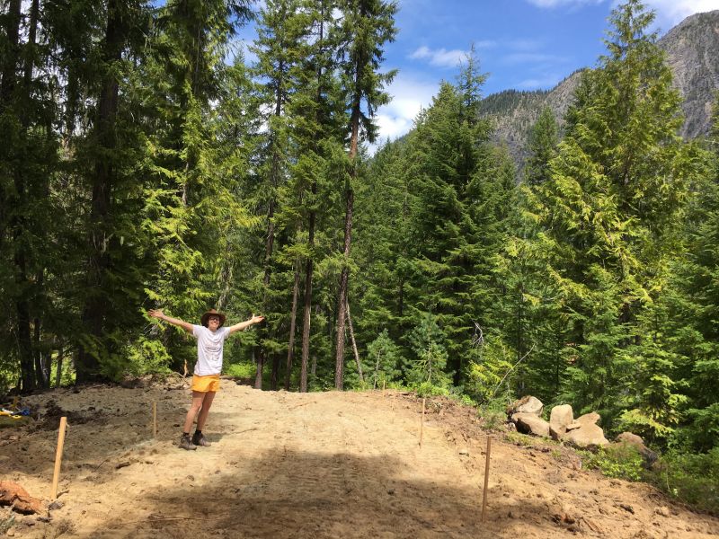

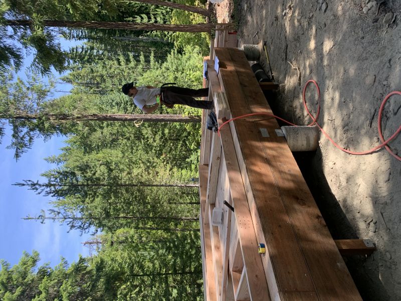

willywilly2020
# Posted: 1 Aug 2020 05:30pm

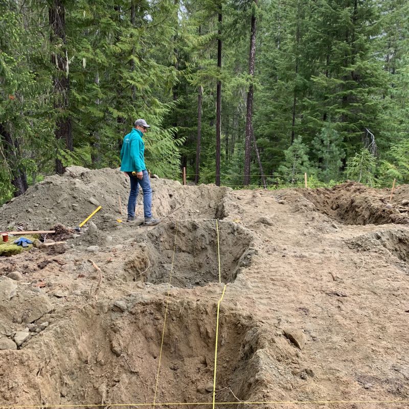

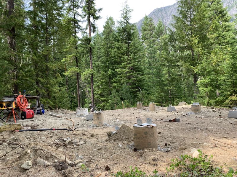

Here’s the site and foundation

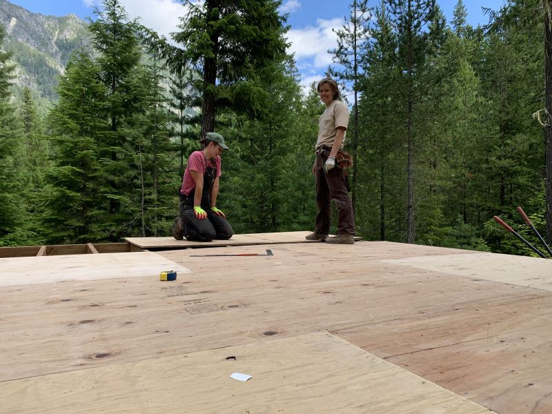

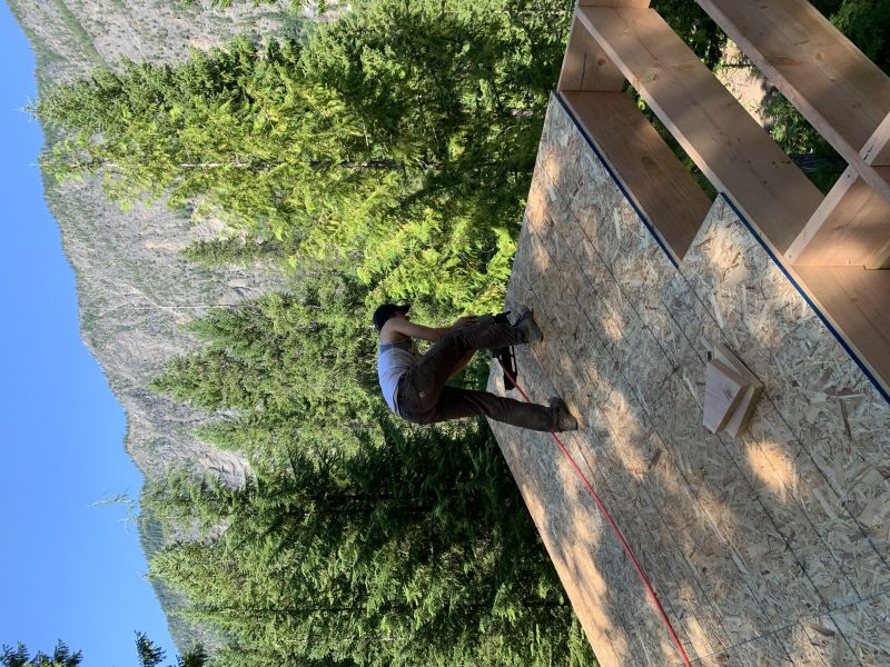

willywilly2020
# Posted: 1 Aug 2020 05:33pm

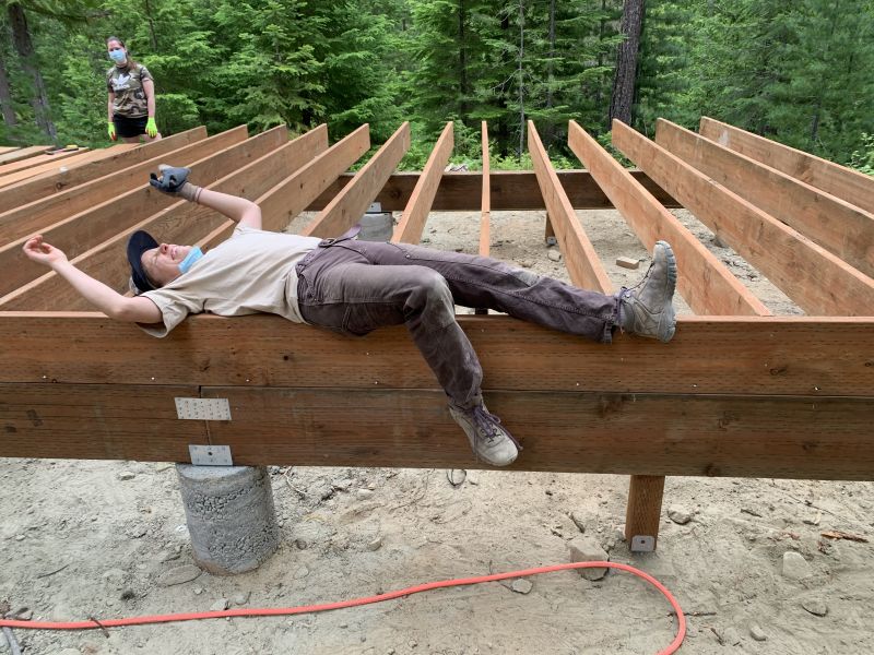

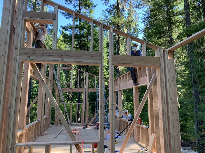

Framing build week - me and my friend Maggie framed most of cabin and roof in about 5 days. Called over some “nearby” neighbors to raise the walls!

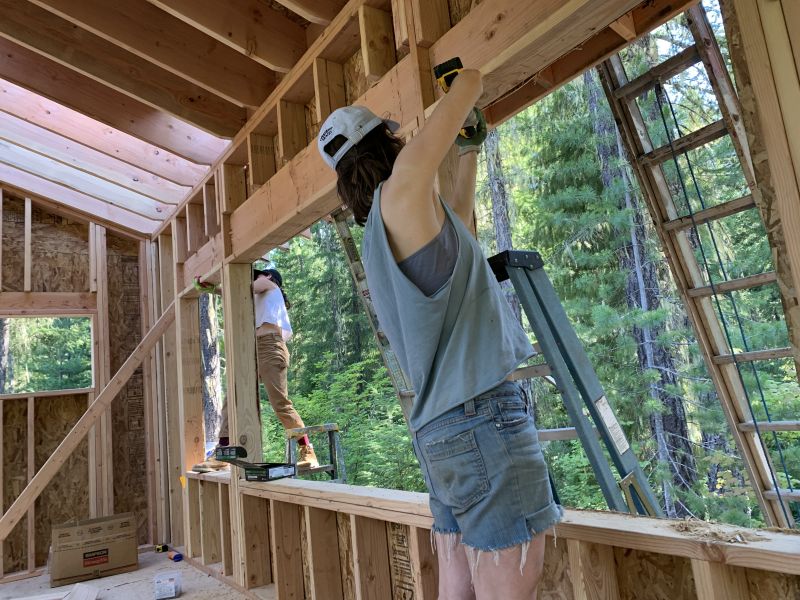

willywilly2020
# Posted: 1 Aug 2020 05:38pm
Rafters took a whole day to get up and a long river soak to recover from!

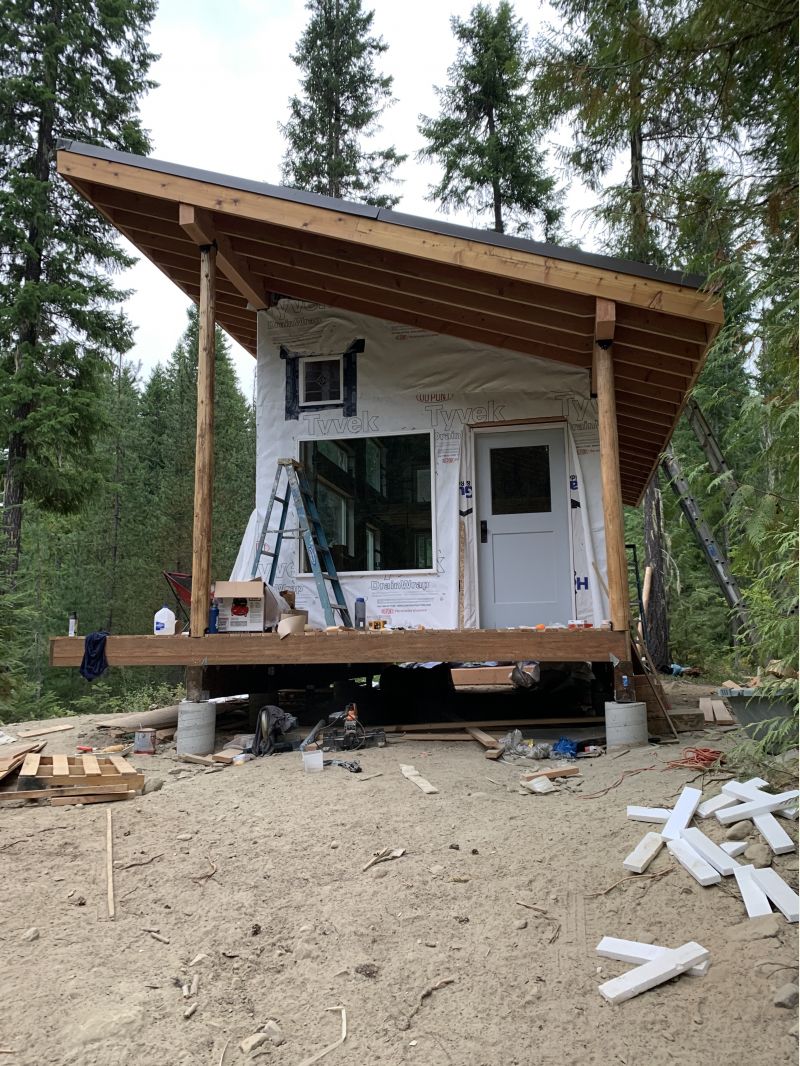

willywilly2020
# Posted: 1 Aug 2020 05:42pm

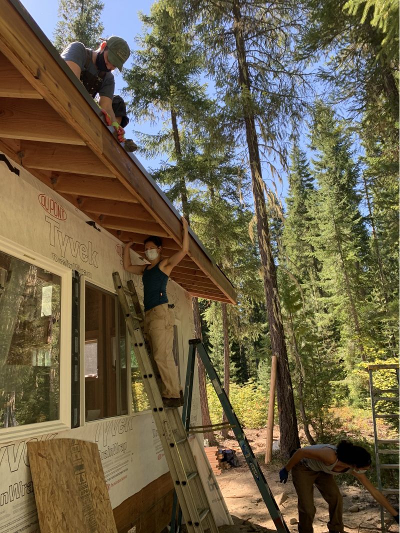

Sheathed it all up, wrapped it with a little help from my family, stuck the windows in, and managed to tar the roof on the hottest day yet!

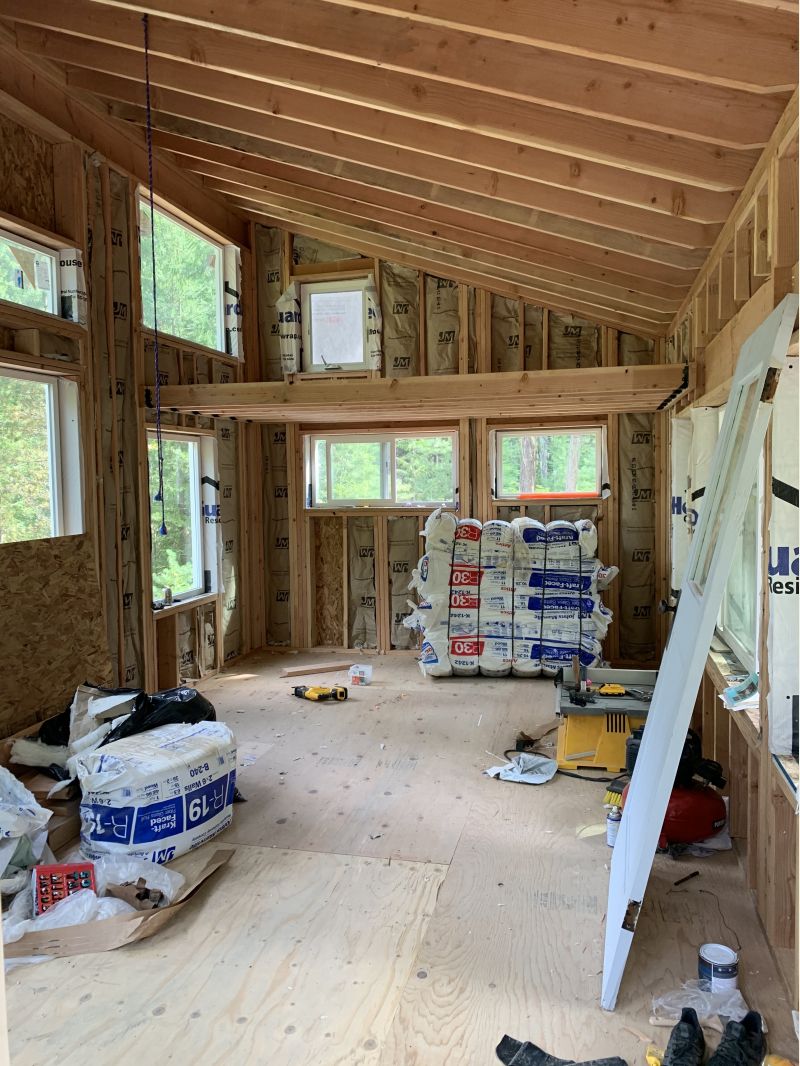

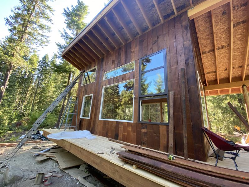

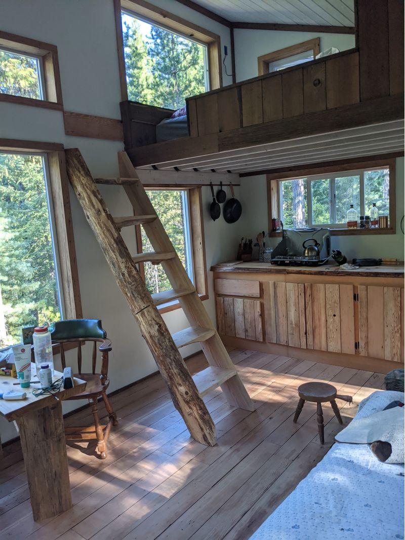

After a couple week break I spent a long weekend at camp - put on the fascia and roof, partially insulated the inside, constructed the loft framing, hung the front door (poorly), installed the final stained glass window, and drilled the ventilation holes in the frieze blocks.
willywilly2020

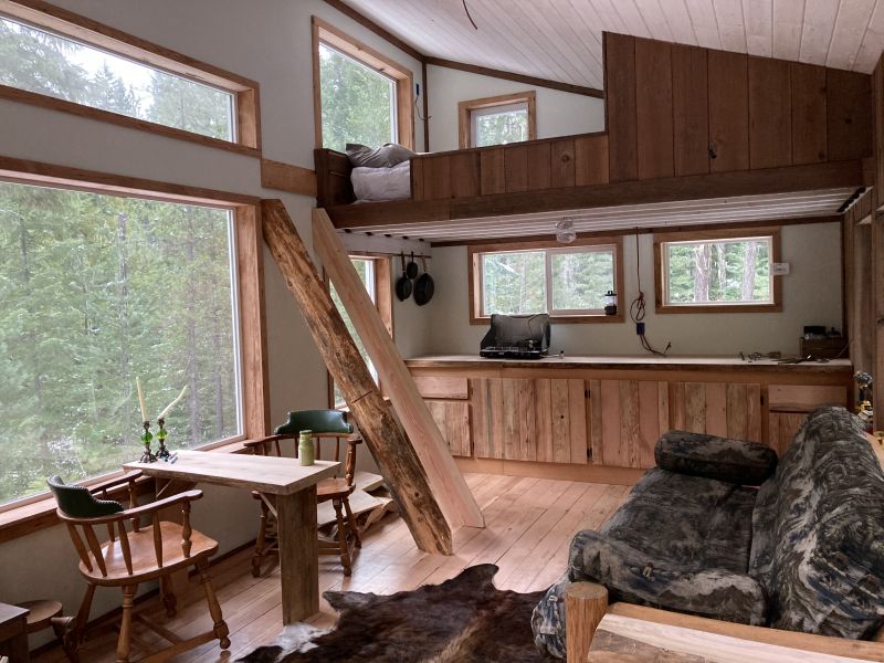

# Posted: 20 Aug 2020 02:59pm
Here's the loft! Headed back for another long weekend to install siding, trim, and finish those damn ventilation holes (my hole saw mandel broke).

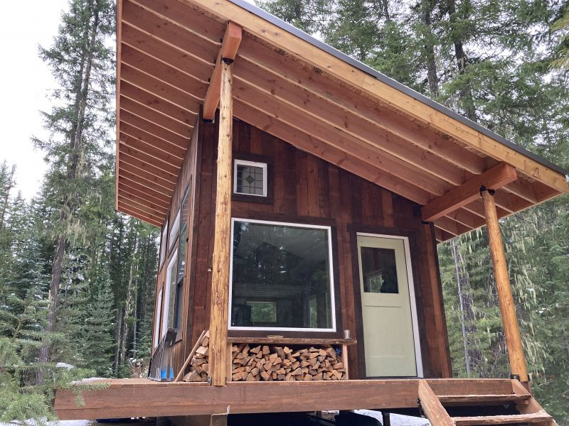

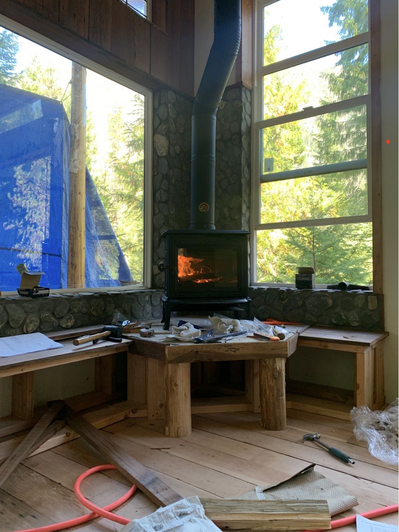

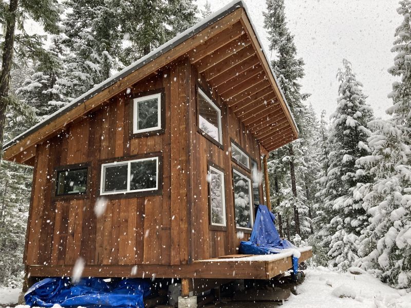

# Posted: 24 Oct 2020 07:30pm
Wow it's been a while friends. Hard times with all the wildfire smoke this summer, but things are finally getting wrapped up. Headed out this next week to clean up job site, build some cabinets and stairs, and bring my nicely seasoned firewood into the storage area on my porch and under the stove.

Wow! I like the way this is turning-turned out. Did you end beefing up a the roof rafters for the 4/12 roof?
willywilly2020
# Posted: 24 Oct 2020 09:41pm
Thanks! I used 2x12s for my roof rafters.

willywilly2020

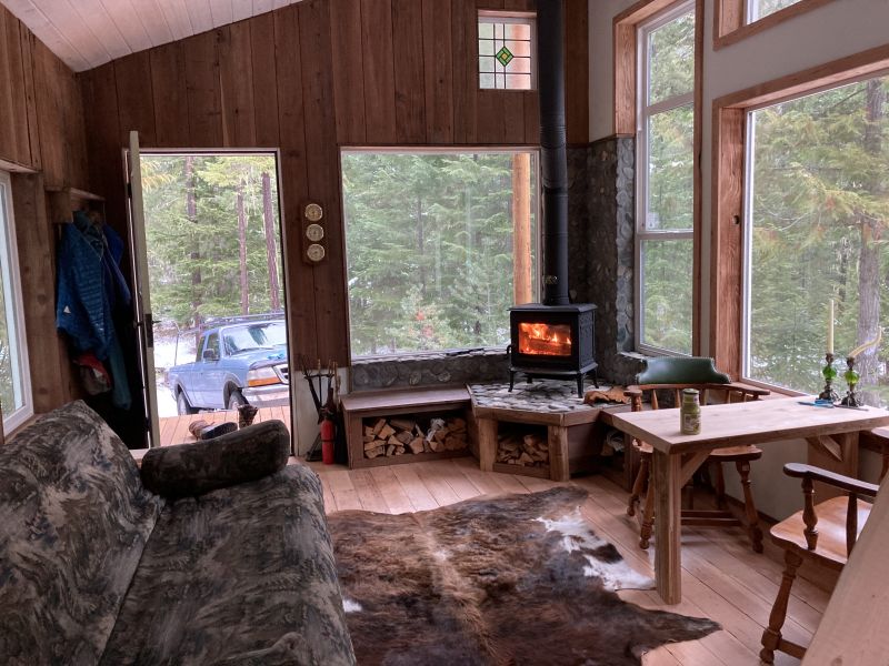

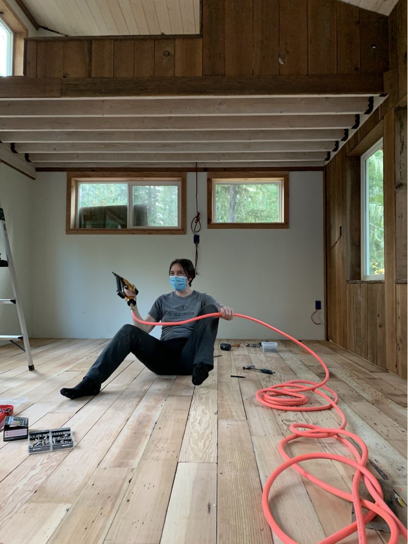

# Posted: 17 Nov 2020 12:43pm
Back from a last trip to the cabin before it becomes ski only access. Great timing as we got about 7 inches before I hightailed it out of there.
Wrapped up building my cabinets/countertop, whipped together a table and some random furniture from scrap wood from my pals at the local backwoods mill. Hauled all my firewood from where I chopped it in the spring and stored it in every cranny I had! Brought up my big cowskin from where it was gathering dust.
The scrap wood for my stairs was more wet than I realized (should have measured moisture levels before snagged it from the mill's discard pile) so I've stickered the steps and will probably install around christmas.
Ran out of time to build: outhouse, shed.
To install in the winter: my solar panels/set-up, stairs.

Quoting: rpe
What's the story with the piers?
A sorrowful tale to be sure. I have two 25' beams under the cabin (20' of those is the cabin, 5' of deck). Armed with some advice, I originally poured 8 beefy, deep sonotubes w/bell footings at 0', 10', 20', 25' of each beam. However I just wasn't sitting well with it. I looked over some of the span tables, and realized I should have had them closer together. I added four concrete pier pads (not near as beefy) and 4x4s under the beams and beefed up my beam size to help me sleep better at night.
rpe
# Posted: 18 Nov 2020 08:43am
What's the soil like in your area? Is it well drained? I'd keep a close eye on those pier pads you added in case they frost jack the building up off the sonotubes. I've experienced heaving of about 4" vertically in a single winter with very wet clay. Fortunately, the building re-settled on the bed-rock mounted piers in the spring, and the offending pad supports were replaced.
willywilly2020
# Posted: 18 Nov 2020 05:15pm
It's very dry/rocky, the location drains well, and I'm up on a little hill. I'll keep an eye on that frost jack though, yikes.

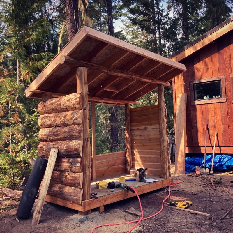

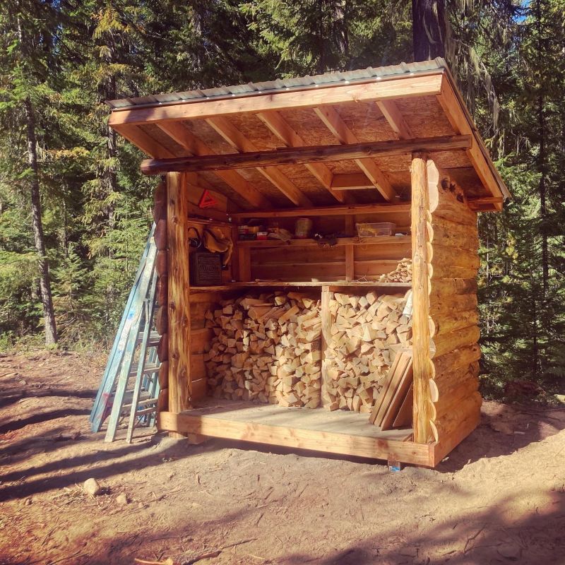

# Posted: 7 Oct 2021 03:21pm
Moved further away from the cabin this year (4.75 hrs vs 2.75 hrs) so I haven't been out as much. Had a couple great trips this year, built a set of stairs in the cabin and a woodshed (and filled it!). Also picked a bunch of mushrooms in the woods - delight!
