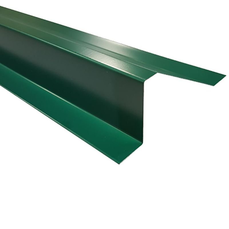

# Posted: 31 Aug 2020 06:19am - Edited by: Nobadays
So... just bought some snow guard from the local metal roofing manufacturer to use as a ladder to access the chimney. The owner at the company claims he sells a lot of this for that purpose. Looks a little sketchy to me but he claims it makes great steps to climb up the roof on. I'm thinking about screwing down a D ring at the ridge and leaving a fixed rope. I have a pair of Gibbs Ascenders that with a harness would catch me in case of a fall. Hopefully I don't have to climb up there in the winter but want to be prepared.

# Posted: 31 Aug 2020 06:53am
Never seen that profile for metal roofing before. I would think it should work well for what your doing with it. I would screw the hell out of it.

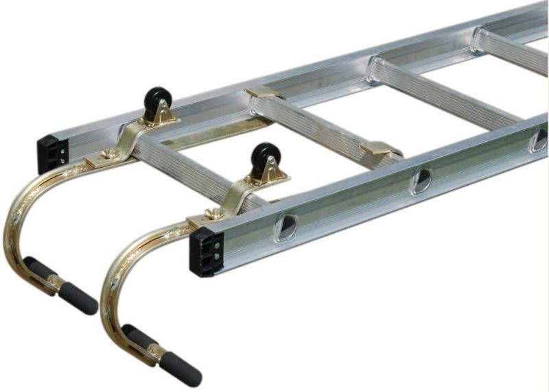

# Posted: 31 Aug 2020 08:48am - Edited by: toyota_mdt_tech
Less holes you put into your roof, the better. They make a wheel and hook hit made for a ladder, hook on kit, roll it up the roof till wheels come to ridge, then flip ladder over, hooks grab over ridge. Now climb up ladder. Stepping on metal with grit on shoes will damage metal roof finish too. You can add rubber cushions on ladder to soften contact when its flipped over.
Ladder Hooks
Those steps will also hold snow on the roof, metal allows it to slide off.
# Posted: 31 Aug 2020 09:49am
they work great. I have use aluinum angle material as well. The snow guard can be bought in same color as the roof. They are screwed to the ribs using the self tapping metal to metal screws; short so they just penetrate the rib and have a neoprene washer.
I use snow guards around the eve edge where sliding snow might fall on someone or cause equipment damage.

Toyota, thanks! I have ladder hooks but not a ladder long enough to reach the peak and extend down where I can reach it easily... close, but takes a bit of a stretch to reach the bottom rung then climb up onto the ladder. At 65 and one armed... first I can't put the ladder up myself and second, I'm not leaping for a rung on a snowy roof.
ICC... good to hear! The Amish guy that owns Skyline Metal near swears the the snow guard makes great steps, sounds like he is right. I may put some anti slip strips on them just for added security. I got 2.5" screws with the metal and plan to span/ attach to three ribs.

# Posted: 31 Aug 2020 06:18pm
I think the 17' of single wall is also part of your problem. Cooling smoke allows creosote to drop out and a cold chimney dosnt draft.
A ladder with a wheel kit may work on a 12/12 pitch but I wouldnt chance it with a 3/12.
# Posted: 31 Aug 2020 08:30pm
Quoting: Brettny A ladder with a wheel kit may work on a 12/12 pitch but I wouldnt chance it with a 3/12. Your reply Heck, I wouldnt even use it for a 3/12 pitch, I would just walk up it.

# Posted: 1 Sep 2020 06:07am
Toyota even a 3/12 metal roof can be slick. At least mine is. I had to stand on the screw heads and any thing put down would nearly slide off. This is with no moisture involved.
