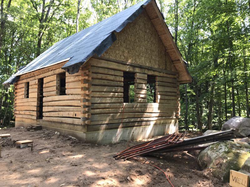

Started building a log cabin offsite in April.
Finished log work. Numbered each log, brought to my lot and have it waterproofed on the roof. Just cut the key ways for windows and ready to start building two 6x24 covered porches.

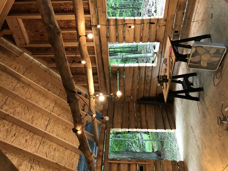

What a cool build. What is the spacing on your roof rafters?
Lumberrick
# Posted: 2 Sep 2020 09:07am
24” 2x10 sawed all my own lumber. Logs are white cedar I cut off my own land. I have all the flooring made, and all the tounge and groove for the ceiling made. It’s all black ash. Dovetail joints in the corners.

Lumberrick
# Posted: 4 Sep 2020 08:48pm
I'm using Permachink with grip strip backer rod. I have the key way in. And, the window and door bucks are installed.

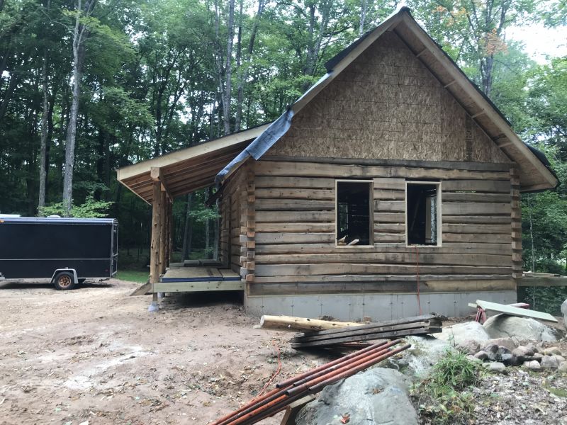

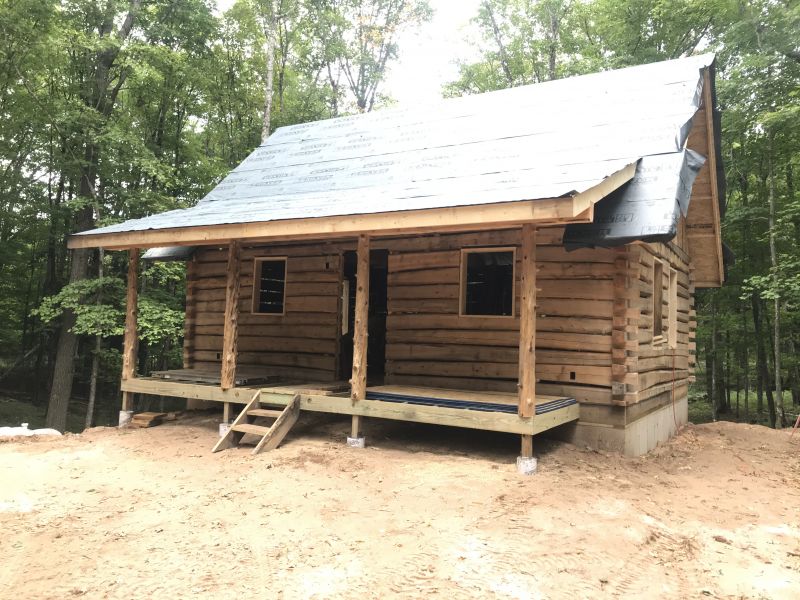

Lumberrick
# Posted: 9 Sep 2020 09:15pm
Just finished the front porch. Working on the back porch which is identical.

Lumberrick
# Posted: 11 Sep 2020 07:27pm
It’s a scratch build. White cedar from my own property. But, I was inspired by the show barn wood builders. Except I can’t leave after the log work is done like they do. I actually have to finish it.
# Posted: 13 Sep 2020 07:04am
Nice porch! I like the generous over hangs. That will pay off huge in maintenance.
