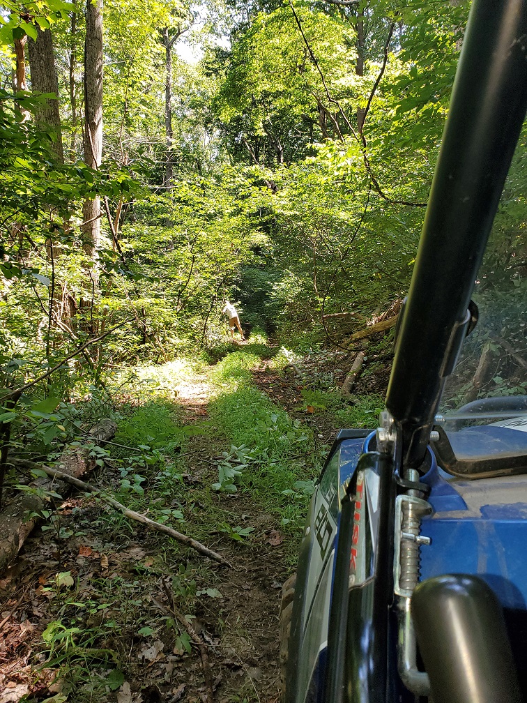

Sooner than later I'll get this picture posting figured out. Spent a couple hours Monday with my son doing trail cleanup and preparation. The property has network of old logging roads we will use to get materials up to the top. Terrain is steep enough access will be ATV only. I'm gathering parts for a removable rack system to go on my RZR for hauling materials. I also have a small rough terrain trailer I can pull with the RZR as well.
My son will be the powerhouse of this build , he loves his dad and loves the outdoors so he's pretty into it so far. Fingers crossed that he stays interested , he turns 18 in October so.....
Ol Slim
# Posted: 9 Sep 2020 01:25pm
Monday
Joonya Clearing The Way

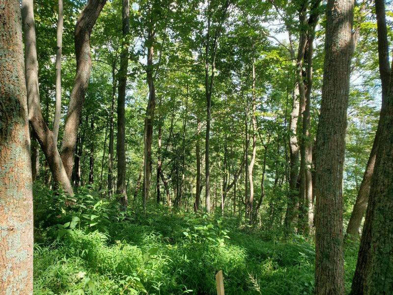

Site Pics
Me Overlooking Site
Me Overlooking Site
View Left
View Left
View Straight/Right
View Straight/Right

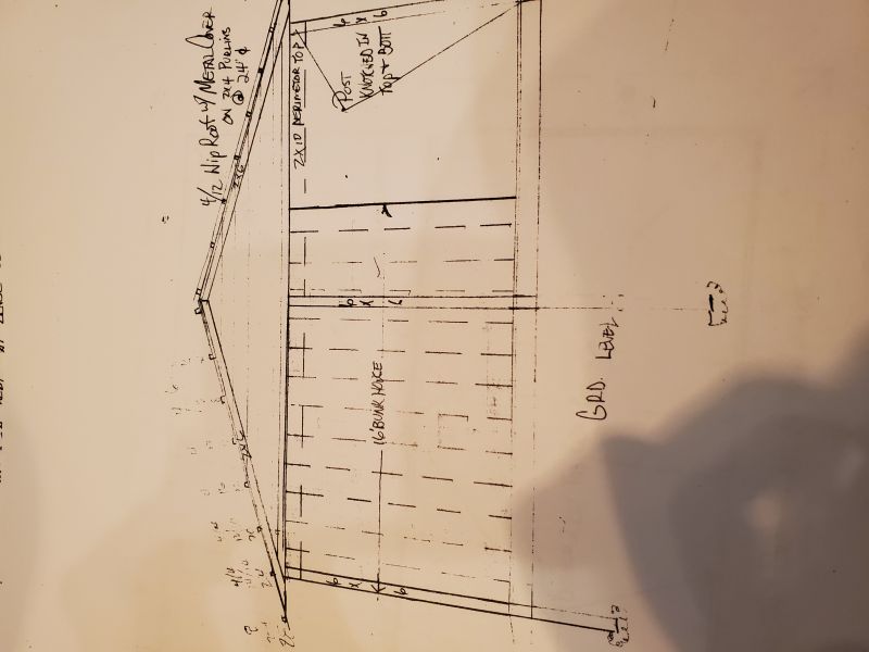

My uncle got me some rough sketches of my thoughts on the layout.
Overall
Overall
Side View
Side View

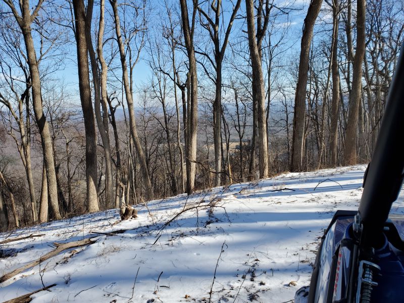

# Posted: 10 Jan 2021 05:24pm
I decided to stay off the build site during hunting season to keep from disturbing any of my uncles hunts. I've been anxious to get back to the site , spent the las few months studying up , planning and hoping for some relief in lumber prices by spring. Myself , my uncle and joonya rode up to the build site yesterday. I'm very pleased with trail conditions getting in. No major cleanup necessary . We retrieved all my uncles game cameras and one of his tree stands. Wintertime view from the build site was amazing as always.We had some snow on Friday which only amounted to a dusting at the bottom of the mountain , however by the time we reached the top there was a few inches of accumulation. Awesome day in the woods. Hopefully I be able to begin to accumulate some lumber soon and actually break ground.....

# Posted: 10 Jan 2021 06:26pm - Edited by: gcrank1
Goodonya!
We have some views like that, and similar flora, in WI but not where our 16x24 cabin is.
I see the attraction
Our cabin was built in 2012 of likely green cut local sawmill odd size boards. We have some wide gaps! The roof is metal, imo that is better than our prev cabin with typical asphalt shingles.
The cabin boards were not coated with anything and have actually held up pretty well. We have a fairly generous eve on two sides, more would help.
If you can get some seasoned wood to start with and some fresh cut at the same time it may be ready later when you need it; ie, plan ahead for your wood. I want/need to make some changes so Im looking for the mill that the prev owner used.
Btw, sawmill wood and lumber yard wood does not look the same.....it wont match.
Both our cabins have had a similar fault, the trees were not cut back far enough in the initial ground prep. They continue to grow, and age, stuff falls out of them, they die and there is the fire danger..... cut back farther than you may like, you could well be glad later.
Take the time and effort to ensure the deck is solid straight, level and square or the 'issues' will multiply as you 'go up'.
