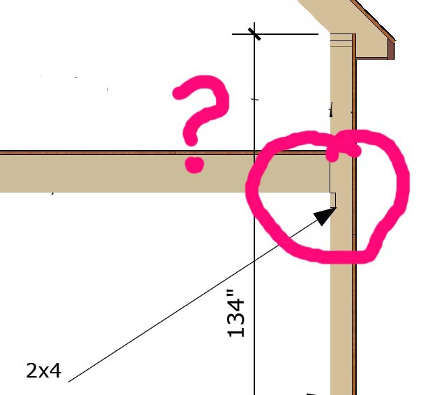

thanks for the link, i will most likely be using these plans when I build my cabin. my only question is why did they sink the 2X4 in the 2X6 walls down the length of the wall? would that really offer you that much more support to the wall? it looks like more work than its worth, but i'm no expert.

Quoting: northernspirit why did they sink the 2X4 in the 2X6 walls down the length of the wall?
Which 2x4 do you refer to? On what plan page?

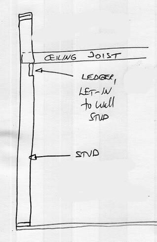

I could be wrong but I think you may be referencing the 2x4 that is inset as shown on page 2 just under the loft floor joists. I attached an image with the piece circled in red. Is this what you wonder about?
If so that is a ledger board. It is inset into precisely cut notches to help support the loft joists. The joists rest on the board edge and are also face nailed to the wall stud.
The cuts are easiest made before the wall is framed. Clamp all the studs together on the floor. Mark and cut them as they lay there stacked together. Cut with a skilsaw and clean with a chisel or use guides and a hd router. Care must be taken in layout to try to avoid having the notch at a large knot or stud defect. this 2x4 or some other one???

thanks for your replies, MtnDon that is the spot I was talking about. but what EvoQ says about the blocking makes more sense to me only because the ledger as you say does not appear to stick out from the wall. how would this add a spot for the joists to rest if its flush with the wall?

The joists extend into the wall cavity.
Assume the wall studs are a full 12 feet apart as measured on their outside edges/faces. The floor joists are a full 12 feet in length. It rests on the 2x4 inset ledger and extends over the wall stud right to the exterior sheathing. Then the joist is nailed through into the wall stud.
The ledger is inset as that makes a more solid support than simply replying on the nails to provide support. This can only be done with 2x6 studs not 2x4 wall studs. (In years gone by it was commonplace enough to find 1x4 or 1x6 inset into 2x4.)
The ledger is not meant to stick out from the wall as that would not be as strong and would present a problem when paneling, drywalling, etc the interior.

If it was meant to be blocking it would be on the exterior face of the wall. Blocking is not inset; it is simply short lengths of 2x4 inserted horizontally between studs where necessary.

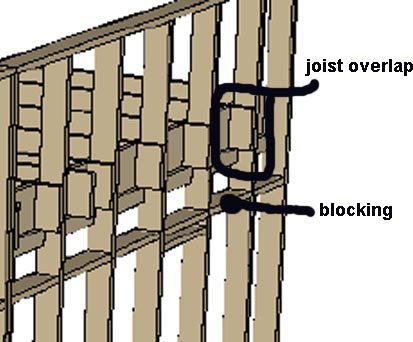

# Posted: 8 Jan 2013 12:54pm
Reply Quote
page 16 from plans detail joist ends and blocking

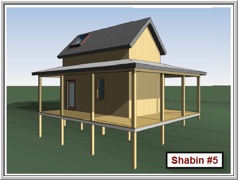

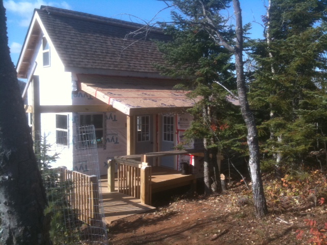

The shabin is very similar in design. In our case the footprint is roughly 11 x 20. We have a 6 foot deck that wraps three sides. Our location is two miles inland from Lake Superior (snow depth range 2-4 feet). The roof over the deck has a pitch of 17 degress (approx 4x12). We chose to build will all rafters being 16" on center. The rafter material is 2x8.
The drawing is from the original plan. Due to our terrain and a 25' hight limit, I adjusted the planned 8' ceiling to 7.5' on the mail level and also shaved 6 inches from the loft knee wall. Long story short, the total hight from the main floor to the top of the knee wall is within 1" of the free plan. You will notice in the photo that the lower roof is still separte from the upper roof just closer than indicate on the drawing. Also I extented the lower roof 24 inches past the deck edge (similar to what you would need for an 8' deck).
One of the projects this summer is to finish the roof over the deck.
