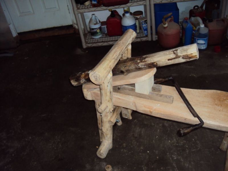

I use hand tools; they work fine. Shaving horse, drawknife, and chisel for the tennon. Auger bit for the hole. Often, you can find these tools for not much at an antique/junk shop. Just sharpen them up and you are off.

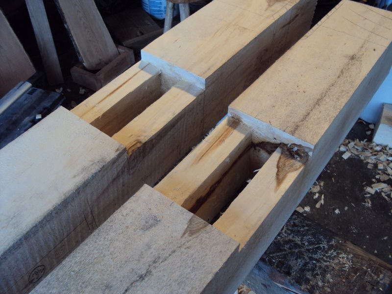

For a bed frame, I would prefer to make the base a little beefer. I would likely opt for some type of thru mortise to support the bed portion (Thru mortise pictured below on a beam. You can adapt this technique for a log). Again, you only need hand tools. Shaving Horse
