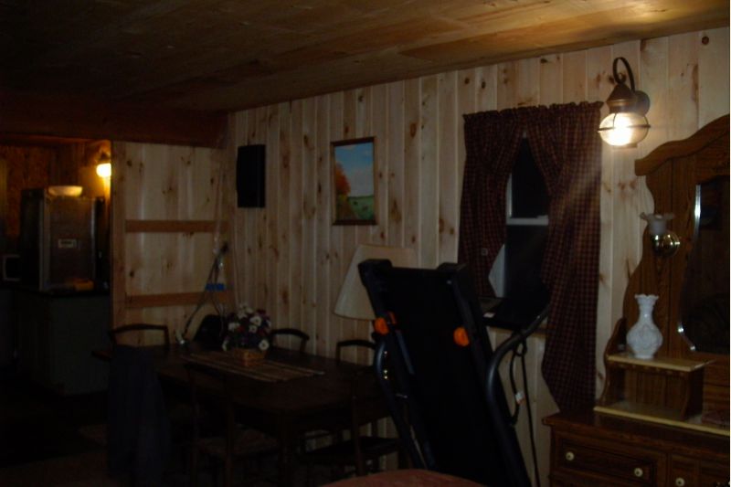

# Posted: 5 Jul 2013 05:09pm
You tell me the light on the left is a 13 watt CFL 12 volt.Give off a pretty good 40 watts of light but is yellowing badly with age.The one on the right is a 201 LED 13 watt,12 volt.Gives me about 80 watts of nice light.I'm very happy with this bulb,although very pricey.
