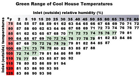

Swamp, or evaporative coolers work best when the humidity is no more than 10%. We had one for 20 years on the house roof. Couple of problems or issues though. They don't work worth a crap when the humidity goes up. Monsoon (rainy) season here in NM is July - August. Just when the temperatures are the hottest it rains and the coolers do next to nothing. Not only do they only drop the temperature about 10 degrees from the outdoor temperature, they raise the indoor humidity which is the opposite of what you need. We've had reefer air for almost 10 years now. It costs more to operate but it works.
So if it never really rained here in the summer it would be mucg better for swamp cooler use. There's a cooling chart I've attached below. It shows outdoors temp and humidity and how many degrees maximum you can expect.

cooling effect
cooling effect

I see now why they are used primarily in extreme climates, like Iran or Arizona, where the humidity is so low
