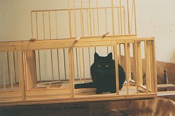

I tend to work out framing with drawings but nothing beats modelling for easy at home learning how. Some sticks, hot glue and brads and you can build it all on the kitchen table for a dry run.
