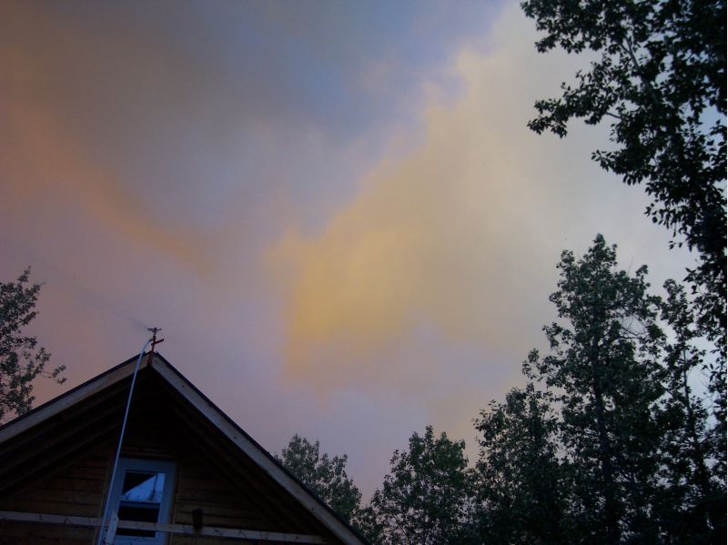

# Posted: 14 Jul 2015 11:42
I agree you always have to be ready. People in B.C and Saskatchewan are finding out the hard way how to perpare.
This is our place from 2009

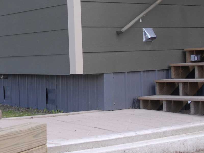

I was watching a show called "Cottage Life Television" and they had an episode on fire safety at the cabin. One thing I didn't think of was the danger of fire going under a cabin and burning it out from the bottom up. Since so many people build their cabins on piers or skids, creating a solid fire barrier around the perimeter of the cabin right down to the ground is something most people overlook. usually they close the space in using lath or wire mesh to keep out animals, but a grass fire would burn right through it and set the underside of the floor on fire.
# Posted: 8 Sep 2015 21:37 - Edited by: MtnDon
Quoting: rockies
We added roofing metal skirting; same as our roof except for color. The underside of the cantilever is also sheeted in heavy gauge aluminum. Siding, trim all cement fiber board. Very fine mesh S/S vent screen.
cement fiber board and steel.
