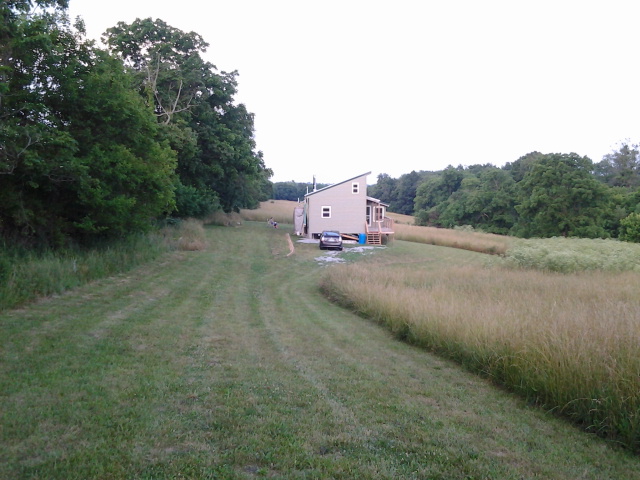

Love this site for the discussions and quality of info. Here's a picture of the place in the rolling farm land outside of Louisville, KY Bret

ps-bret. nice cabin set up. that looks amazing.
