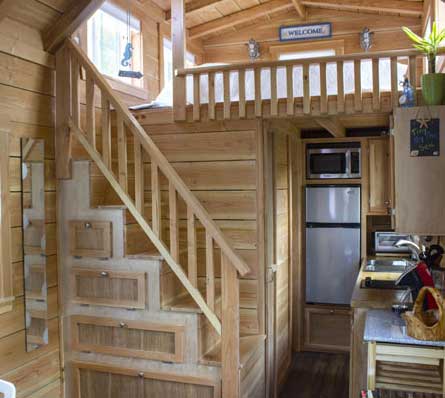

I saw this little stairway on another site. thought you might be interested so I clipped the pic.
one thing when you're doing these builds I've always thought, is it's important to have a splurge. ya. you could build that staircase over a long period of time for 1/4 the cost. or you could buy it. put it up in 3 days. and have a focal point that everyone will talk about and remember.
finishing my chalet I used three kinds of exterior finish. and now, when I hear what friends and family say about the camp, that is what they all talk about.
which makes me laugh. i mean the solar. nobody cares. the composting this that and the other thing. nope. showers. kitchen. kayaking. gardens. birds. wild harvest. maybe a word or two here or there. but put up some funky siding...

# Posted: 5 Nov 2015 10:48am
That has to be in one of those tiny houses. Cute.

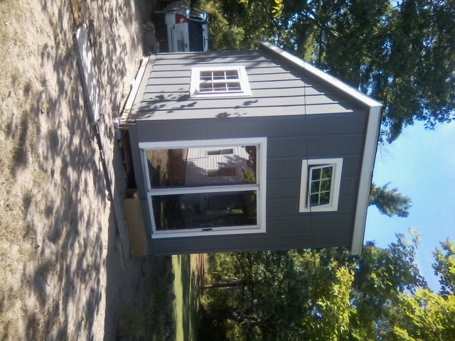

3 2x8x12's and a half days work in a little 9x12 no inspector bunky . I believe they have a 8 in. tread and a 10 in. rise . I.M.O. much better than a loft ladder .
# Posted: 6 Nov 2015 09:46am
wish there was a like button. Just that looks really good. the pic is small tho. Is that a little landing? neat.
# Posted: 6 Nov 2015 10:30am
Actually it is two 1\4 round treads that complete the turn . Pic was taken with my first digital camera 15 years ago hence the small size . Sold the place shortly after. Built this one recently it has a loft ladder, not a fan .
