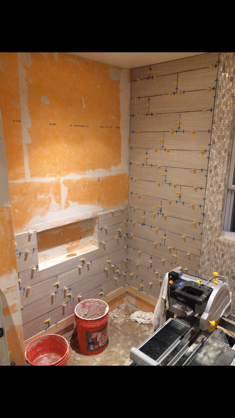

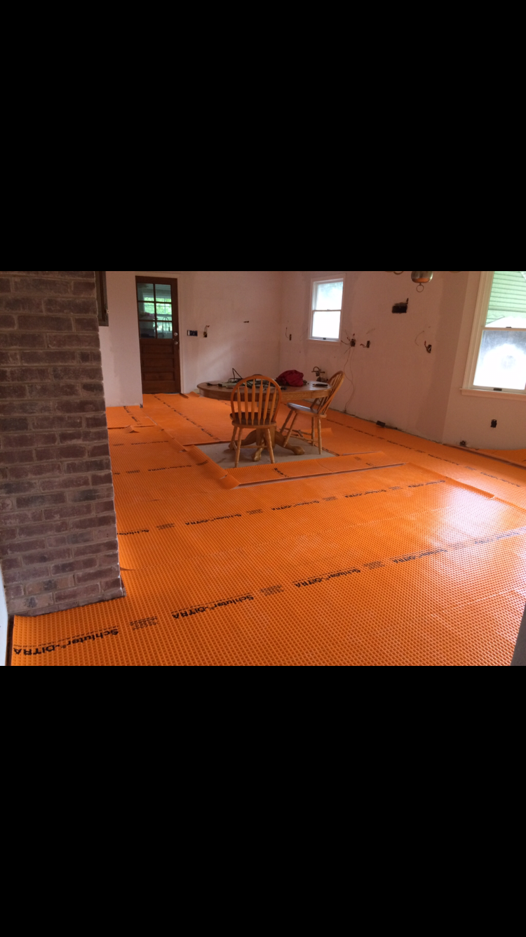

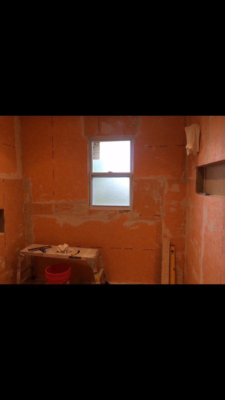

I used Kerdi in my shower and Ditra in my kitchen. Stuff is pricey, but top notch and provides a lot of piece of mind. The worse thing you want to do is try to save a few hundred on waterproofing, only to have it fail and have to rip out thousands in tile. image.png
