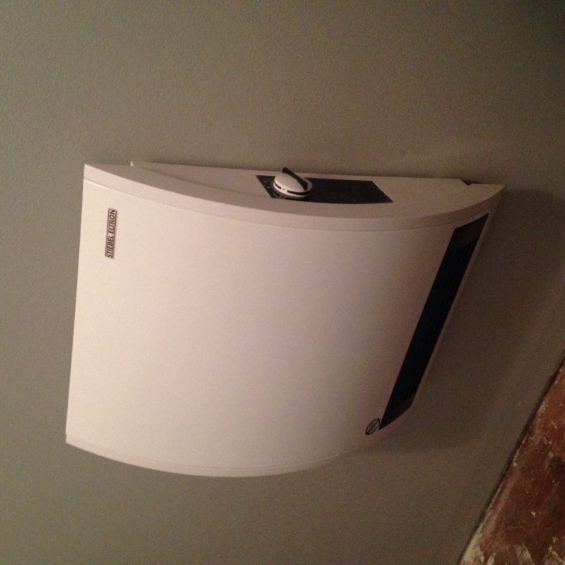

# Posted: 23 Apr 2016 12:11pm
  We recently went on-grid, but only heat the Shabin when on-site (wood stove). However we now keep the bathroom heated 24x7 so that we can store beverages, paint, keep the ports-potty from freezing, etc. This wall heater has worked well for us. Holds the room at 50 when away. With the blower it takes only a few minutes to warm the room up to 65 and the floor is warmed up as well.
