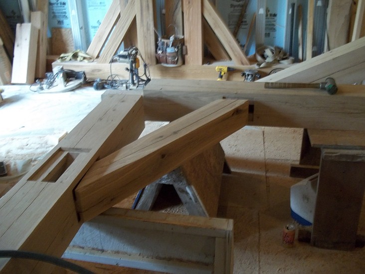

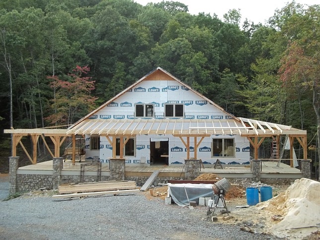

Attached are some pics of mixed oak timbers I logged on the house site, the rocks came from the surrounding field edges. notice I housed the braces, the wood had dried about a year at that point and I knew the brace joint would change angle and not look as nice, pretty common trick to hide that.

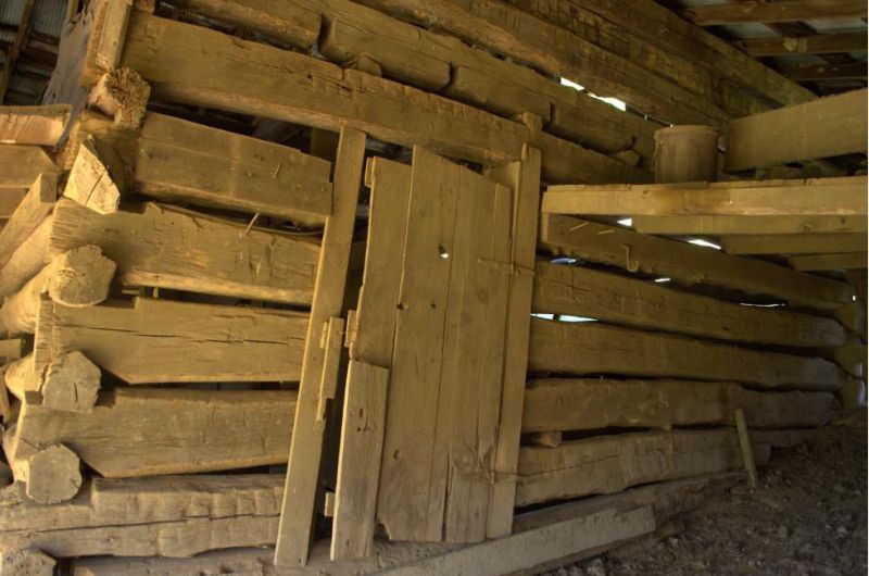

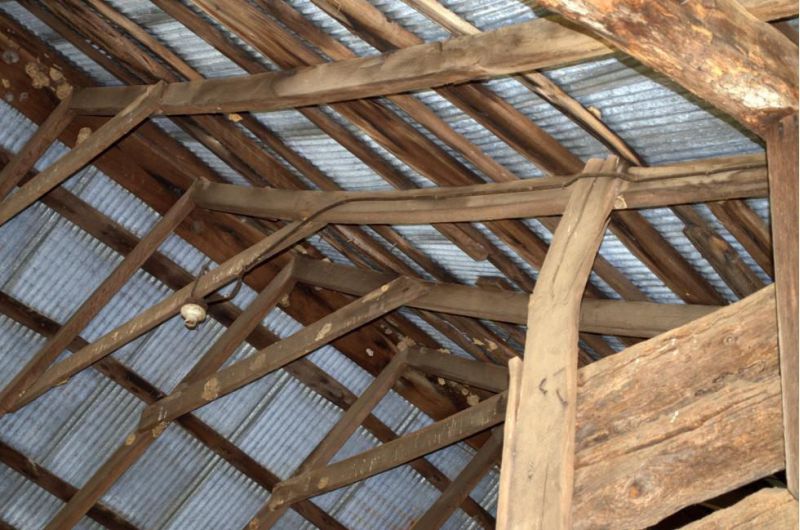

edit, attached also is from a building I recently surveyed. I call this an Appalachian saddle notch. notice the notched poplar floor joist log. Then notice something you'll see frequently on this style. The door and window bucks are typically pegged in tight with 1" pegs, these had substantial nails instead.... the tight buck holds up the logs above it while look at the corner stack, the logs shrank and settled, bowing that header log over the non settling door bucks. Over time it can bow an 8x12 white oak timber. Pier and beam, uh think about this...
If you can see well enough up to the top plate log, notice it is rolling outward driven by the rafter thrust. The final pic is around the gable corner, the rolling plate log to the right. They tried to prop the rafters with that board, that broke and drifted down. The red oak and chestnut rafters are undersized and tied way too high, see how doing that puts a serious bending stress in the rafter and doesn't really stop the feet from splaying and pushing out on the plate log... anyway more stuff to think about.

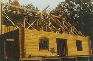

pic 1 looking over the windlass at about a ton of timberframe, about 24'tall x 26' wide 8x8's and 8x10's

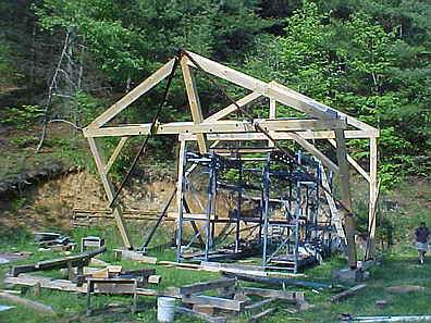

pic2 is taking a break midway on the windup, the better half of the wench crew is heading for the truck.

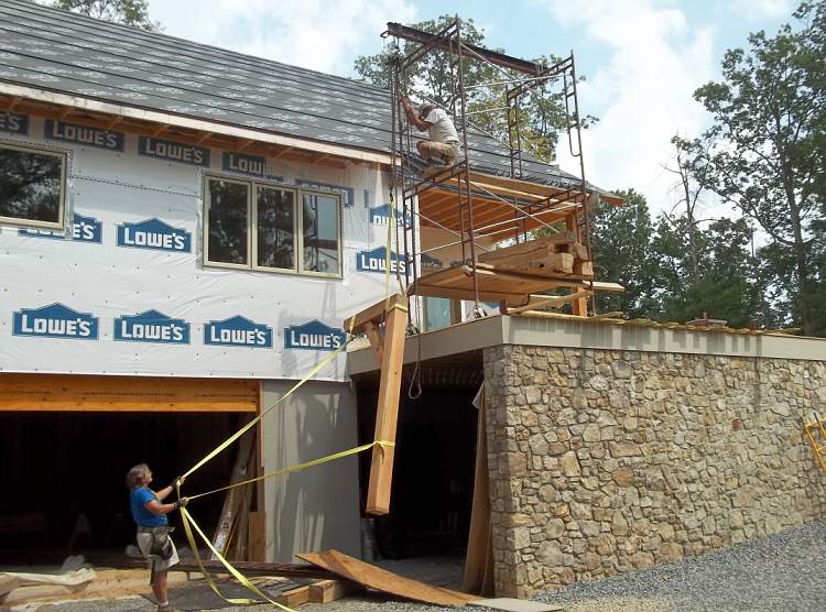

pic 3 is a block and tackle hanging from a jib lifting cypress 4x10 rafters. we used the line of cross braced pumpjacks to lift the 6x12 ridgebeam. The logs there are milled 6x6 cypress, the 2 of us lifted them into place by hand, they had been in a kiln... for about 5 minutes.

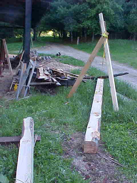

pic4 "walking the dog", a lashed pair of legs with a rope down to the log, snug when tipped back a bit. As you push the bipod forward it lifts and slides the log forward. Rigged correctly and with a place to stand, you can move the world with this. That's our old black and tan at the far end of the mill keeping an eye on things, I sure miss him.
