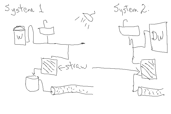

# Posted: 18 Jan 2017 07:34pm
Perhaps you could make up a drawing showing how you built the system and where it's located in relation to the cabin?
You mention "toilet flushing" but then also say "bucket with "humanure". Do you have a composting toilet or have rigged up something that is a combination of regular toilet and bucket catchment?

# Posted: 19 Jan 2017 09:55pm - Edited by: creeky
First. I'm one guy f/t and a girlfriend p/t. For system 1 I use a 1/3 straw bale as a filter for grey water. One washing machine, one sink, one shower.
The grey water goes through the straw into a barrel. I use this water for plants and flushing an envirolet toilet. The remaining water (most of it) goes to a perforated pipe where it flows into bushes. There has never been any smell come from this area. It is a tree line.
The second system, in my kitchen: one sink, one dishwasher. The water goes to the straw, is filtered then runs to a short piece of perf pipe. Which distributes the water to a large maple tree. I've never seen any sign of excess moisture. Maples are thirsty I guess. I, and guests, have walked by this area daily. No one has ever noticed...
As for shower water, with its, um, additions, the straw will help with that.
Oh. Yes, I have two facilities. One is the envirolet. Which is a plastic clivus muldrum. I would build my own if I was doing it again. The second. In the winter I keep a composting bucket toilet in the winter bedroom. I use bokashi mixed in with the pine horse bedding for topping. It is 100% girlfriend approved. No smell at all.
Traveling. So hope this fine art work will do. Best to all.
