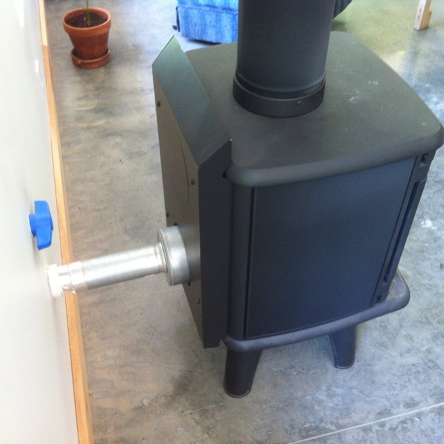

1. A study on the major cause of wood stove smoke in the house found poorly designed installations of wood stoves. They measured the smoke inside the house. All the people suffering from smoke inhalation had wood stove smoke coming back into the house - mainly from wind. So why try to filter the inside air - you are still breathing the smoke? Duh.
The standard for chimney pipes exiting the house is two feet above the peak of the roof. That's a minimum.
Smart folks will either buy a stove with an external air point on the stove or drill a hole and make one. If your stove is pulling inside air only, you are pulling cold air and smoke in from around doors, windows, and other house frame boundary leaks. Kinda defeats the heating capability doesn't it? Moreover, it helps pull in the smoke.
So here is a recommended wood stove installation to minimize smoke in the house.
Find the prevailing wind direction. The chimney exit needs to be on the downwind side of the house. Either roof exit or wall exit.
For either exit, the chimney needs to be two feet above the peak of the roof for code. So make it four feet above the peak to help keep the smoke out.
Seal the chimney pipe joints with 3M Hi-Temp metal tape.
Install double chimney pipe from the wood stove to the roof to help keep a good draw during low burn times. If not you risk back-draft in early AM hours.
Buy of make an external air kit. You may have to drill a hole in the front side of the stove. Two inch minimum. Bottom is worse, back is okay (typical from manufacturer), middle side towards front is best. You need a control valve. No PVC until in the wall. Hose clamp metal screen on the outside exit to keep bugs out.
Make sure your stove door seal is not worn out. There may be a recommended replacement interval.
So drawing inside air, upwind chimney pipe exits, and too short chimney pipe will almost guarantee you are breathing your wood stove exhaust.

This stove was in an airtight house in the northeast U.S. When the owner used the cook stove exhaust fan, it drew smoke from the wood stove. So they retrofitted an external air intake to the wood stove.
