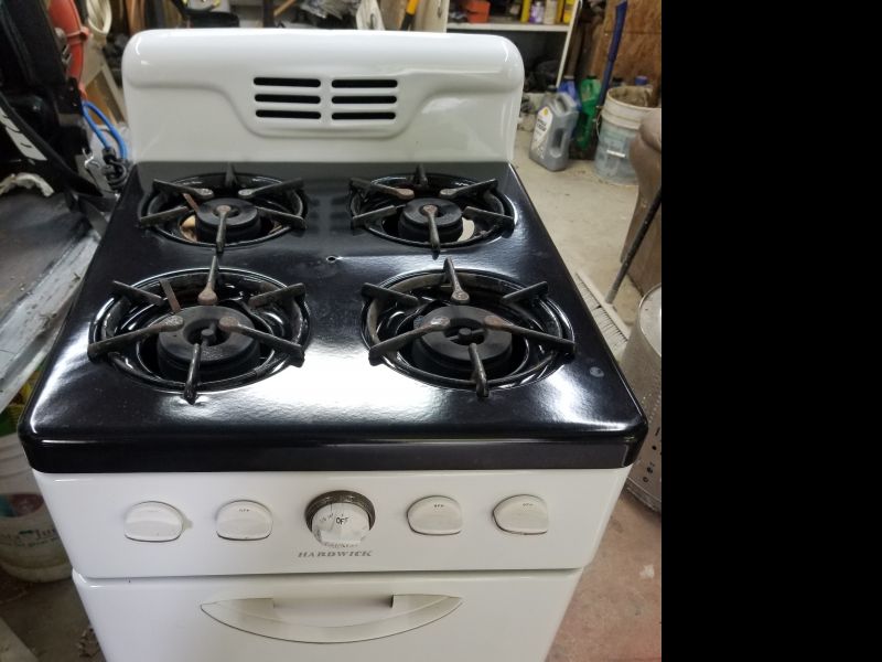

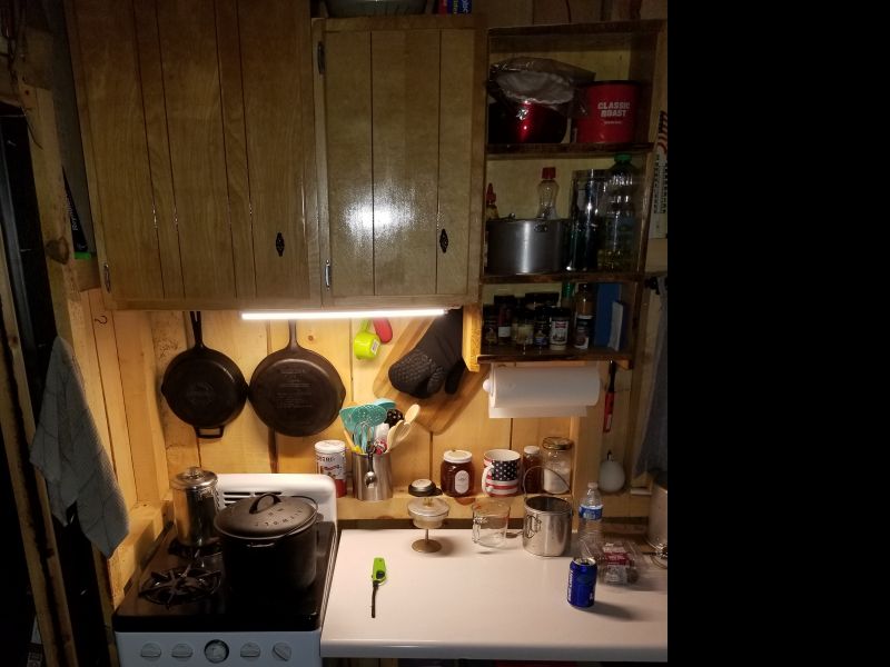

I looked for the perfect stove for many months on marketplace. Then one day I found it. A 1950s-60s apartment sized gas stove with 4 burners. There's not even a plug on the thing. Paid $50 for it in 2019.
# Posted: 23 Mar 2026 08:28am
Nice Bret. NG or LP?
# Posted: 23 Mar 2026 08:39am
Even I would have a hard time turning that down!
# Posted: 23 Mar 2026 10:22am
Sorry i forgot these forums like vertical pictures only. It's propane.
