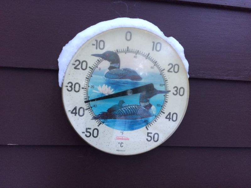

I've attached a picture of my thermometer from a trip last winter (after it had warmed up a couple of degrees). Hence my concern about freezing.
Thermometer
Thermometer
