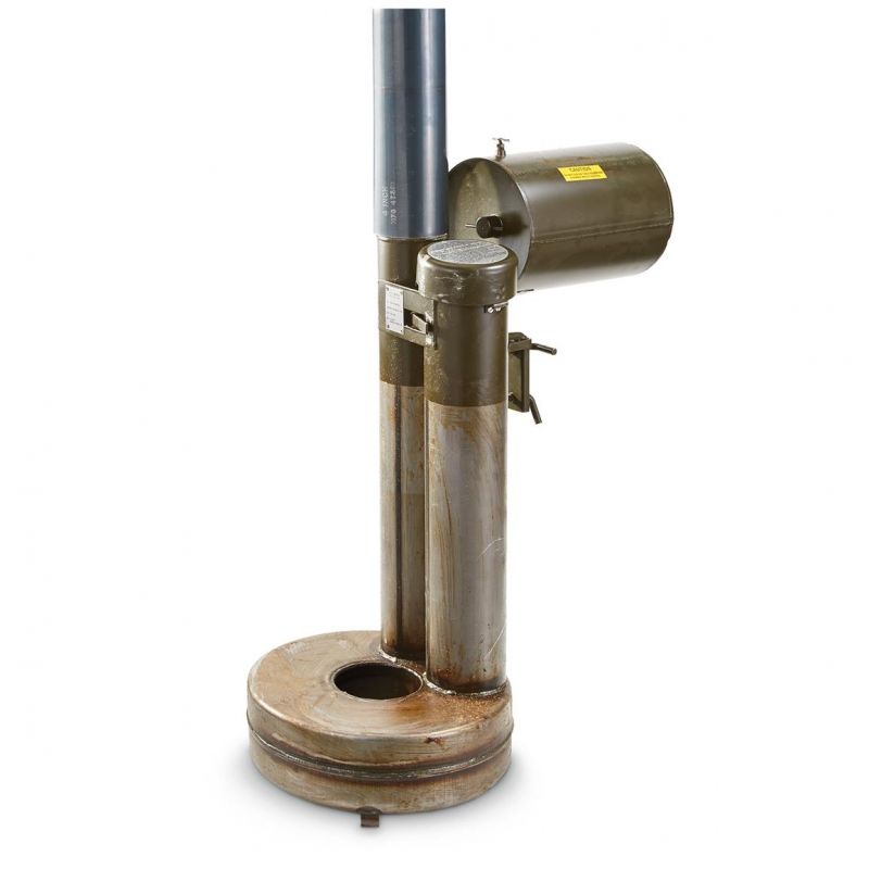

How about an M67.
AKfisher
# Posted: 14 Apr 2017 07:09pm
I have and tried the M67 Immersion heater.... It will work and get the tub hot but... It is like sitting next to a "whomping" fire ball.... It is very dirty as well. The smoke stack/carbon ash will rain down on the water. I would much rather have wood ash and a wood fire.

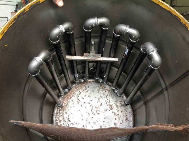

From what I have read the Snorkel stove is the most efficient means of heating a hot tub. Yes the water will stratify but this could be solved with a circulation pump. I have a hot tub with a 25' coil of 5/8" copper tubing in a barrel stove. It circulates with a 12v pump. It works but takes all day to heat water from a well. (cold). It uses a ton of wood to get it hot. Granted we only have pine/spruce but it does go through it! Once hot it holds the heat well so not a big deal to keep it hot. I also built a heater for my brother using blackpipe in a barrel stove but it doesn't seem quite as efficient.

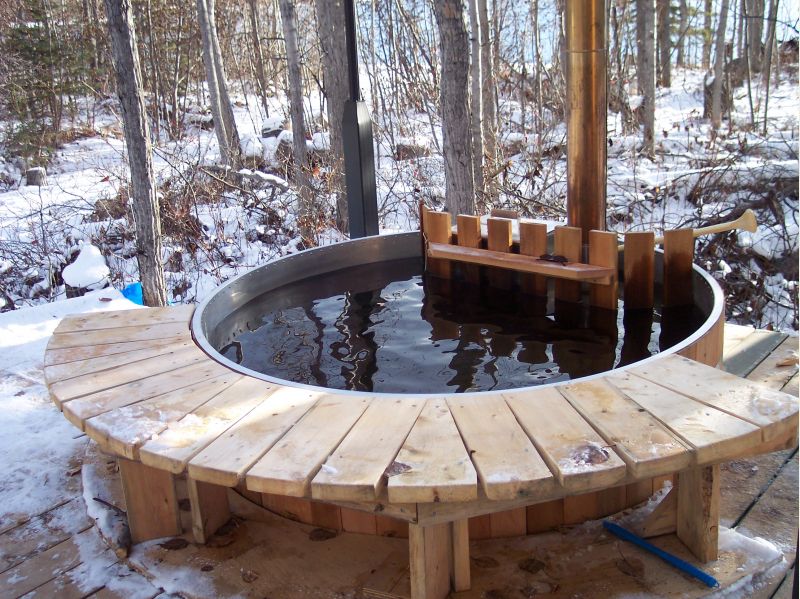

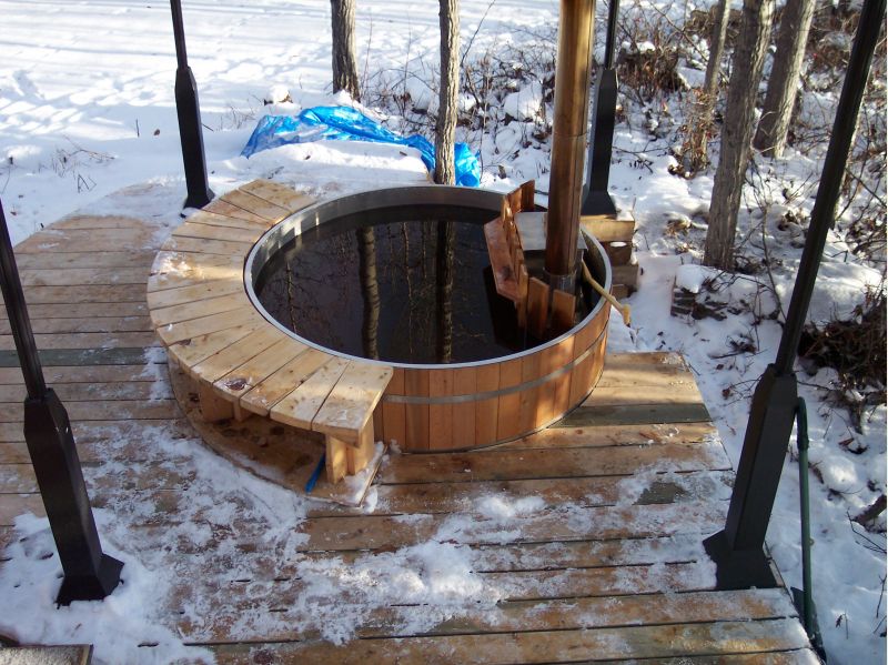

Here is our tub. We have been using it for almost 10 years. They seem efficient. When looking at the stove design you will notice 2 tubes that go through the stove right under the chimney. A lot of the heating will come from these tubes. The tub also came with a special shovel for cleaning out the ash. It is easy with little mess. I recommend to anybody. Ours is from Alumitubs.
