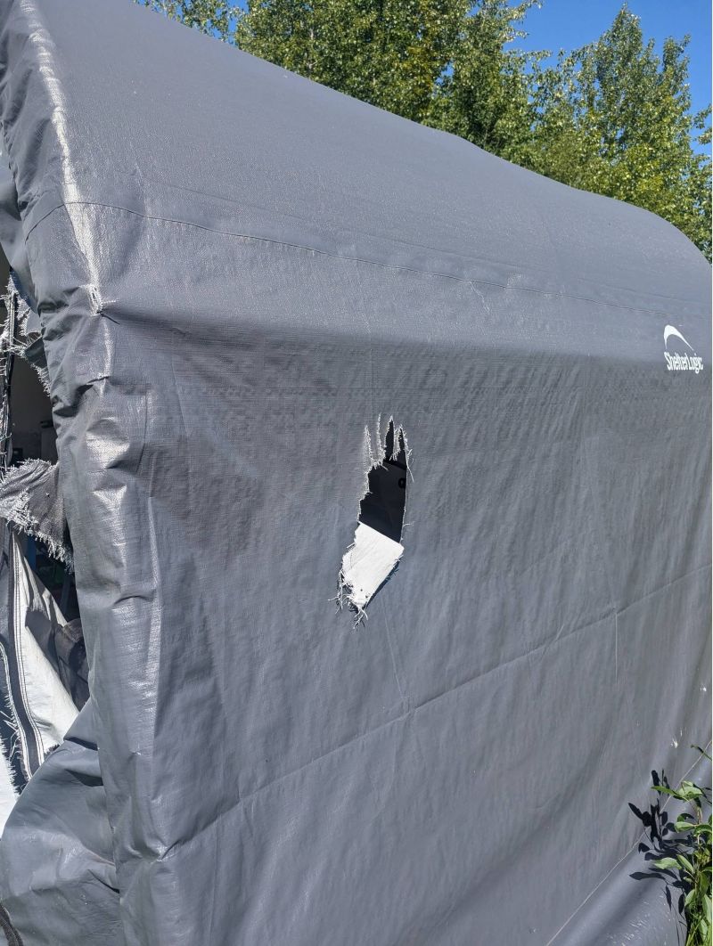

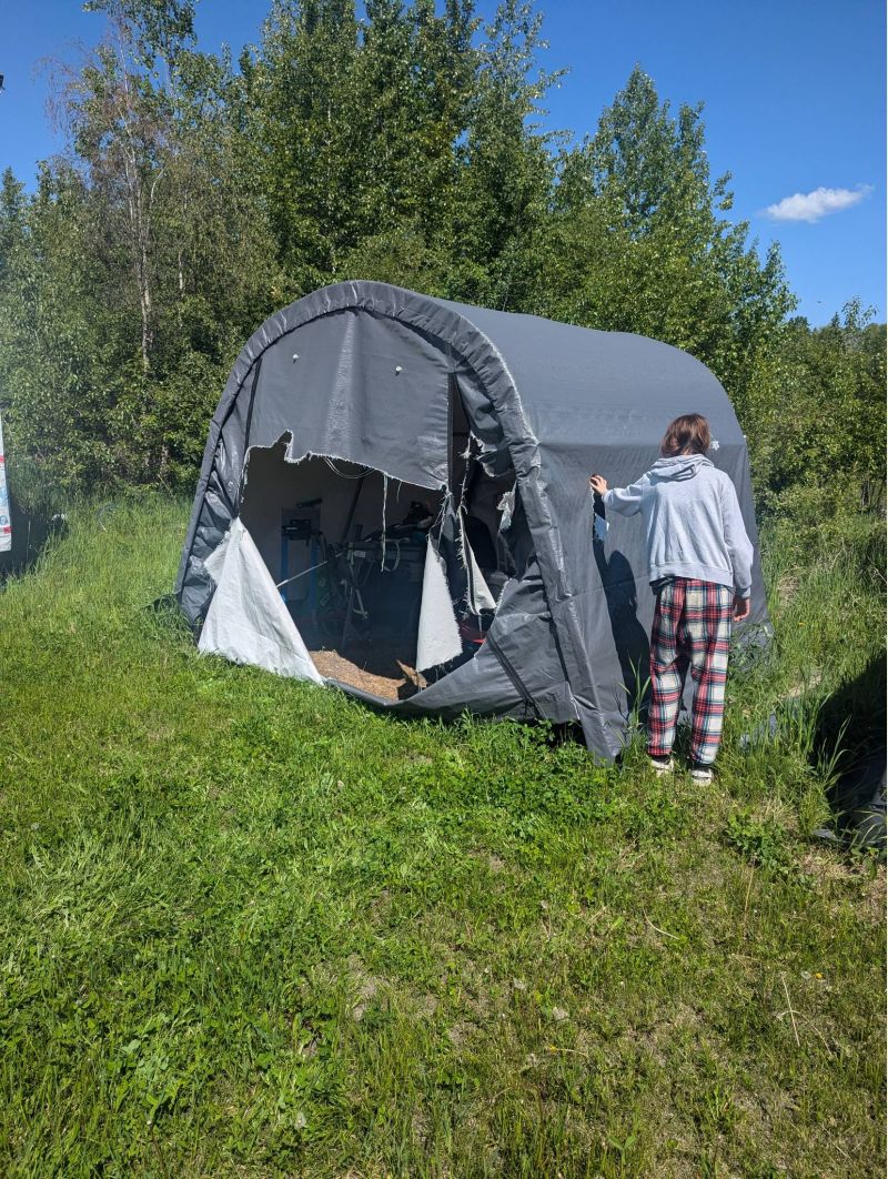

I have 2 of the domed ones that I put up last year. They are just 1 year old and the fabric already started to disintegrate. If you rub it between your fingers small amounts of plastic come off and the gray turns white. At the absolute most, it may last 3 years.
On another note, a bear was very curious and tore the hell out of one of them.

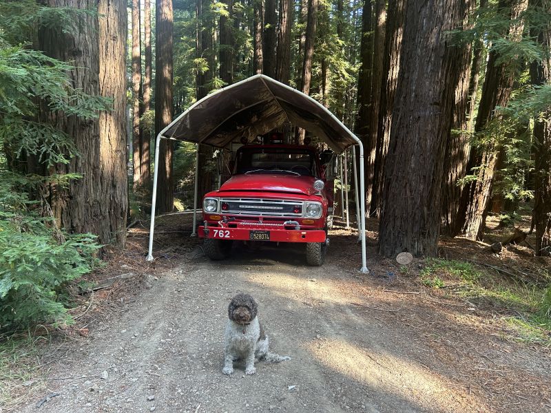

Not a garage but the my canopy top is in great shape, except where a branch went through it last winter. Luckily missed my fire truck parked underneath. Might get a shot of duct tape next winter, $150 for a new top looks like. Or maybe just a tarp.

If you search "awning repair tape" on Amazon you will find a tape much more suited to repairing shelters. It has adhesive meant to stand up in the outdoors, plus its reinforced with fiberglass. Best of all, its only about $9 for a roll. (my solution after Yogi had his way with mine)

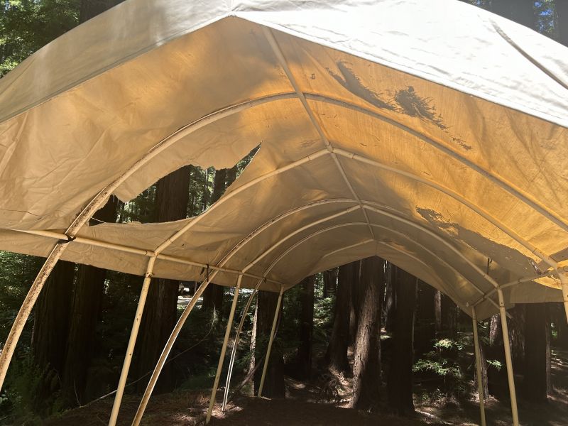

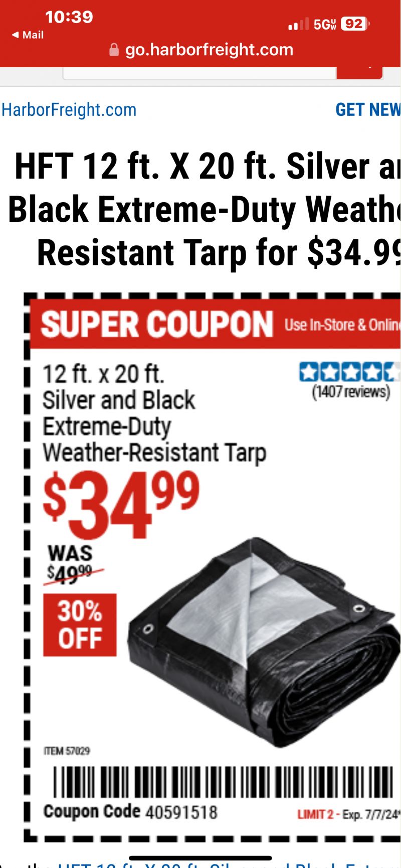

After a better look at my old canopy top, the vinyl was hard and crisply all over. HF had this heavy duty (12 mill) tarp on sale, 20 bucks off, so I grabbed one.
Question is, silver side top or bottom? Silver on outside reflects the heat, silver inside keeps inside warm. Probably minuscule difference making me no difference, just which way will make it last longer.
# Posted: 9 Jul 2024 03:03pm
Imo you want to reject as much sunlight as you can to slow the deterioration.
That is what Ive done and it has worked well for years.

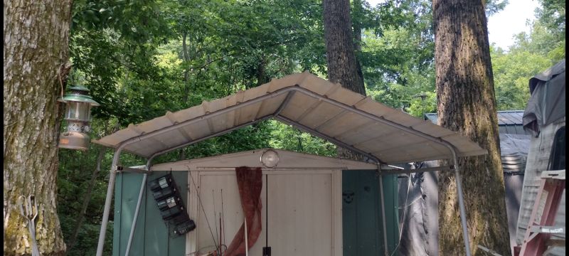

I might get one, then put 10 foot sheet metal panels on top.
# Posted: 13 Jul 2024 05:11pm
I did that with an old cast off frame that I had.
# Posted: 13 Jul 2024 05:32pm
The frame on my cheapie fabric one is pretty substantial. Ive had in mind to put tin on too when the fabric fails. But for our snow loads Id like more 'rafters'. Pretty sure there are some frames around our countryside with failed fabric, I should find one that matches mine and do some frame improvement.

Thanks Darz but I just ended up using the HF tarp pictured above. Funny thing was it fit perfectly, side and end rails, just zip tied it on! Friend talked me into black side out, doesn’t matter much, limited sun.
That metal panel top looks great. I have some new Fiberglas panels laying around. Tempting, but this was so easy..
