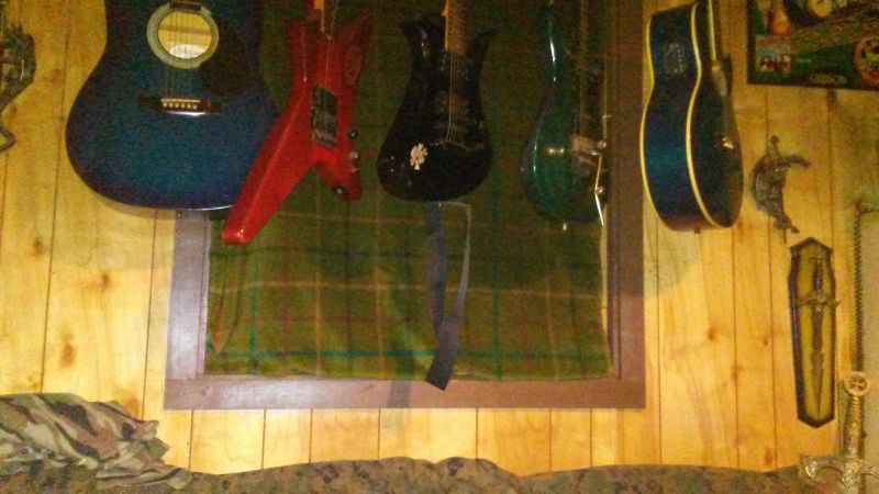

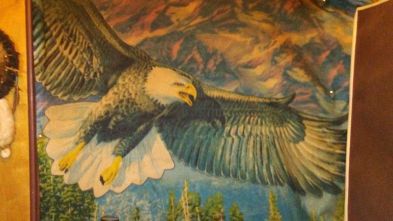

We get those cheap fleece blanket/snuggy things. And use thumbtacks to attach them to the window frames. Its not a high tech solution. But works well for about $2 bucks per window.
