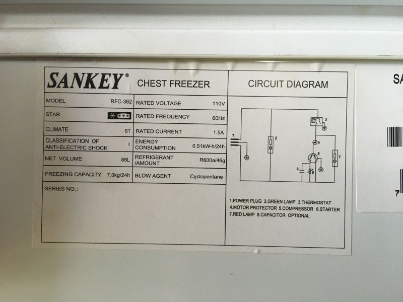

Hey people, forgive me of this is not the right place.
Very new to this and trying to get my freezer running off 300watts of panels. My inverter 500wts keeps beeping after a second. What am I doing wrong or do I have enough solar?
Freezer specs below.
Freezer specs
Freezer specs
