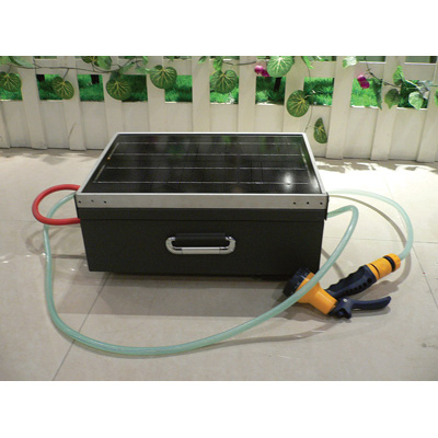

I just got a new NT catalog in the mail and found this nifty little item that some might find useful. It says it's a new item.
URL
Almost a 50 foot lift; 3 hour battery; not bad.

I think for that amount of money you can do a lot better. If you need a lot of lift you won't get 0.76 gpm at 50ft., probably only at 1ft.
Here is what I'm going to use for my shower setup. It will also be used to fill up my water barrel in my pickup from the spring.
$80 - SHURflo 4008-101-E65 3.0 Revolution Water Pump
$11 - SHURflo 255-313 Classic Series Twist-On Strainer
$70 - HQRP 12W Mono-crystalline Solar Panel
or
$80 - Sunforce 52022 5 Watt Solar Trickle Charger - Pack of 2
$80 - 12v RV/Marine Battery
For the same $250 I have a much higher rated pump, many times the power storage and the same charging ability.
I will use quick disconnect hose fittings so I can take the pump, mounted in an open box frame, with me down to the spring and connect it to my truck battery to fill the 55 gal barrel I use to transport water up to my shed.
Once back at the shed I can use it to transfer water, the half barrel of water that won't siphon, into my permanent water storage.
I can then hook the pump up to the Eccotemp L5 hot water heater in my shower setup.
I'm not knocking Northern Tool. I have one of their Northstar generators and really like it. I just think in this case you can easily roll your own solution and come out way ahead.
