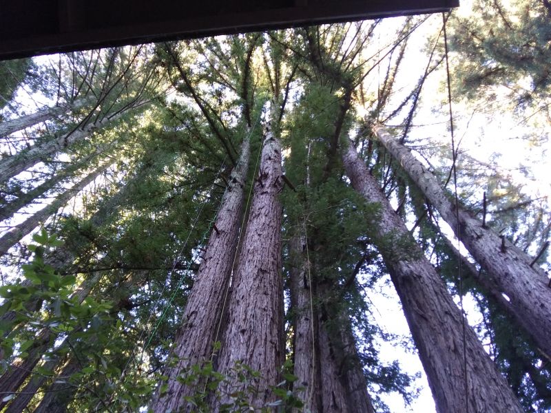

Took your advice and hoisted a wire up a tree this morning, at least 50' (can't see where it's hooked to the green rope). Helps AM in a big way, FM too a bit I think. Just have to run it into the cabin now.

Congrats on raising an antenna! You’ve got a nice vertical antenna. If it were horizontal it would favor from “broadside” directions, vertical isn’t picky about direction.
Keep in mind this antenna can pick up a static charge on windy snowy or stormy day. It can give you a zap! You might use a wire with alligator clip to connect to your outdoor wire, leaving disconnected when you are away.
FM might prefer a simple “dipole” antenna either indoors or outdoors, outdoors above roof level will give better reception. This will favor the “broadside” directions for reception. Turn to maximize your favorite stations.
