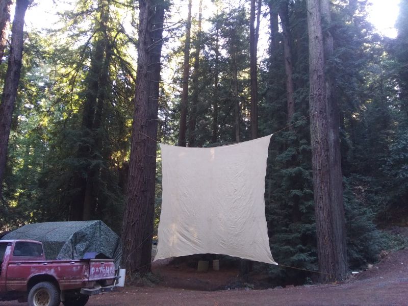

Btw, my new screen, a sun shade thing 20x20, shows a perfect picture. Looks like I'm tanning a dinosaur hide. Got it on pulleys, up and down in minutes.

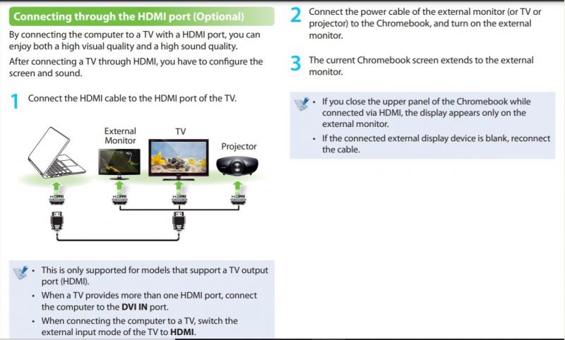

I agree. Here is the manual page on using HDMI on my Chromebook. No setting changes, but it does say 'on models that support HDMI'. I'm guessing since mine has the port, it's supported?
I'm going to try it on a TV and see if that works. Be a couple days.

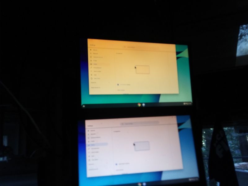

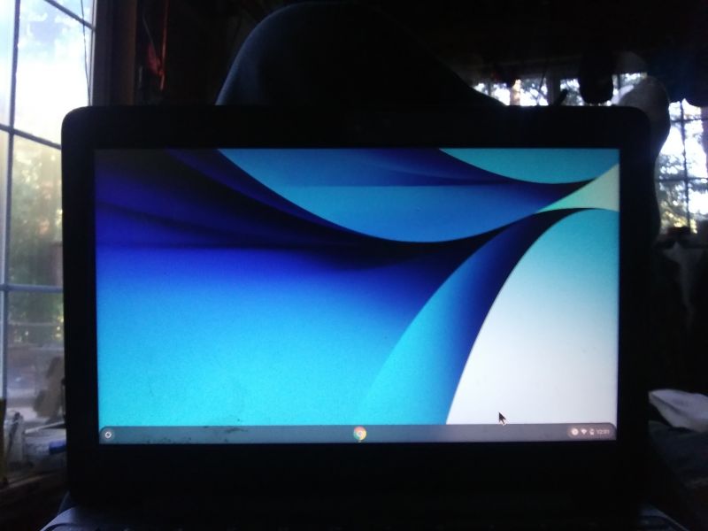

Progress. I plugged the CB into the cabin TV, which has an HDMI port. A screen popped up to select which display and to mirror the CB. I checked that and it worked. So at least I know the CB is capable. I even played the movie off the thumb drive.
Another thing.. The image in the second photo is the wallpaper from the CB, I never noticed it before because it usually just has the Chrome screen. That image is also appearing on the projector, but I do not get the pop up window to select second screen or window. I can try changing the screen size but I am getting that wallpaper..

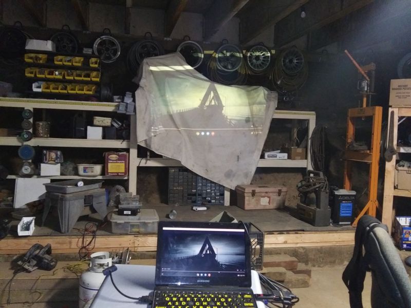

Success! I hooked up the projector in the shop this morning, I knew I had seen that CB home screen come up before..

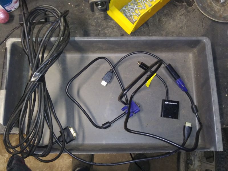

Tried the HDMI to DVI cable again, the one that works with my friend's Apple. Nothing. When he used his Apple though, he had another cable that went from his C usb to my cable, that had a usb port in it that the thumbdrive movie plugged into.
Anyway I got nothing again. The I pulled out some of the other cables and adapters I had tried the other day (I got a box of cables and stuff with the FM transmitter I bought). There were a couple of HDMI to RGB (or is that VGA?) adapters. I plugged the first one to an HDMI cable, nothing. Tried the second one, the CB got the pop up screen to mirror the display! Hit that and boom, there it is. Even plugged in the thumb drive with the movie and that worked! Still don't know why that HDMI to DVI cable doesn't connect, no biggie now.
