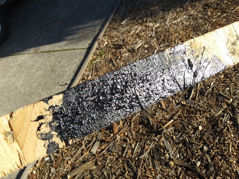

I have a gallon of truck bed coating. Used it on my steel car trailer, it's super strong and adheres well, has a nice non skid texture. The can says for metal, nothing about wood. I tested it on a piece, seems fine, but I don't want it peeling off later.

We've used rhino bed liner on wood before. It held up well.
I also used the dollar general version of spray on flex steel on my portable camp kitchen box made out of marine grade plywood. It stays outside nearly 24/7/365.
It also is holding up well. It's like $5 bucks a can at DG.
I would say use the bed liner you have.

The bed liner prob says it's not for wood because wood moves.
I have non PT 2x6 on the center of my car trailer for about 6+yrs now. I would use motor oil for a free/cheap outdoor finish. Its pretty easy to apply with a HVLP gun and thinned with diesel.

My can of bed liner doesn't say not for wood, just says 'for metal'. Did some searching, found out I'm one of many curious about this. Used a lot on boat decks. Most advice says some bed liners do say OK for wood, some don't.

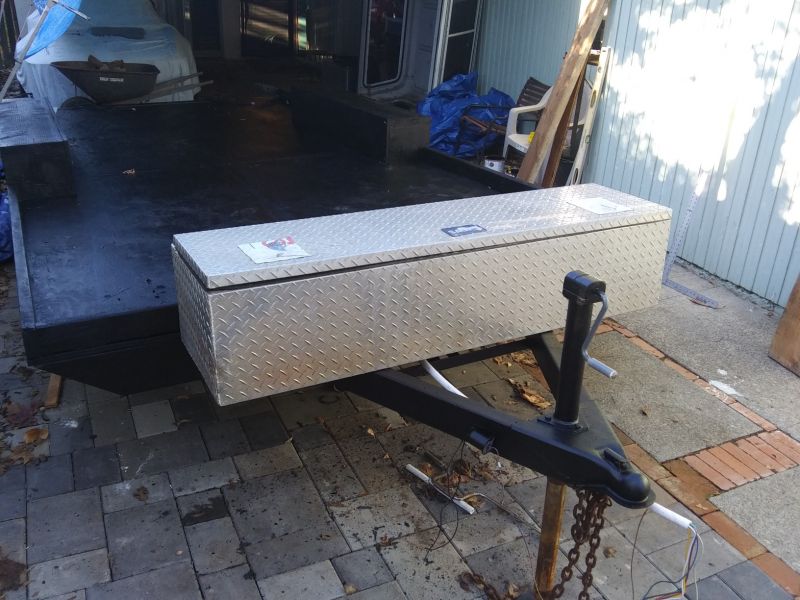

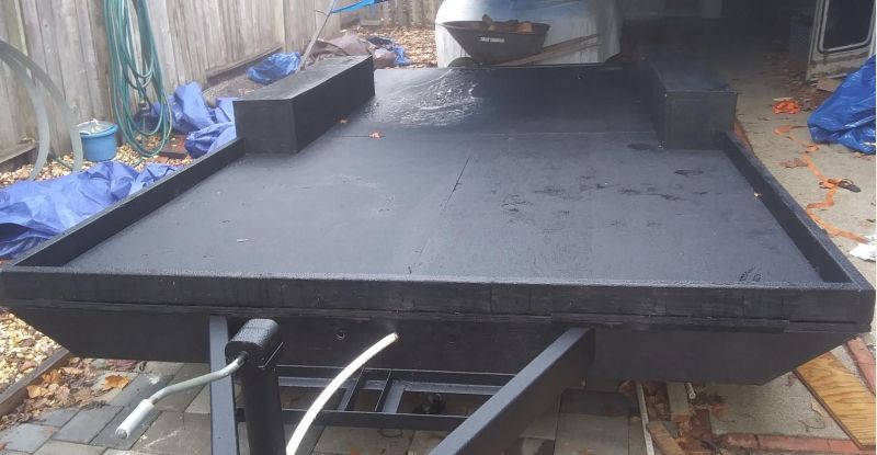

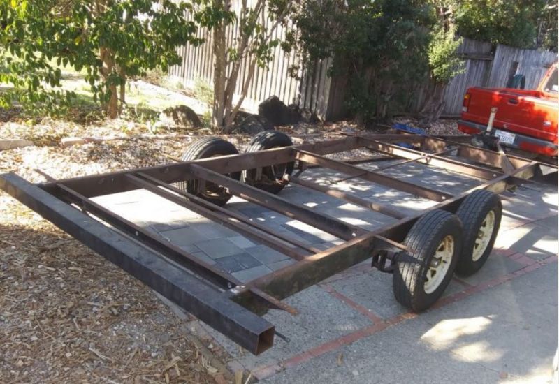

Well I went with the bed liner. Just a trailer frame I picked up locally for $200, mainly because it has good brakes, brand new tires and a title. Put about $100 into it (had the wood already) I really should stay off the classifieds more..

In the meantime.. I've had this box kicking around at the cabin, was storing kindling in it. My first thought was to mount it at the front of the trailer deck but now I don't see why it can't go in front.
