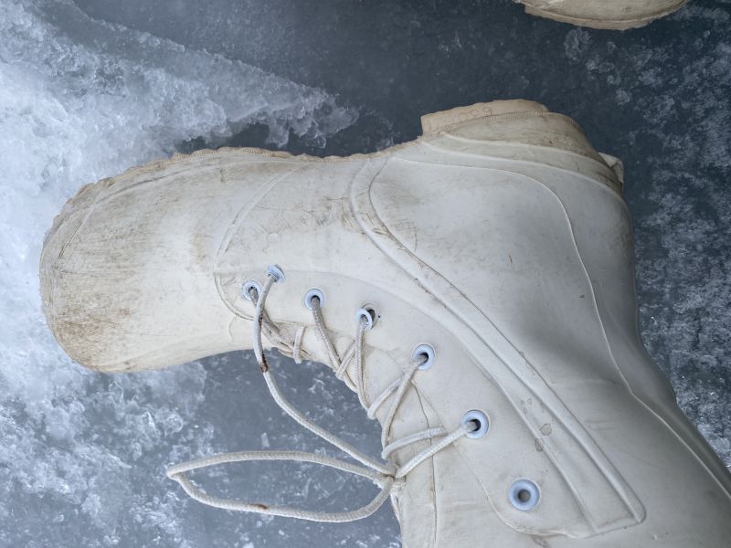

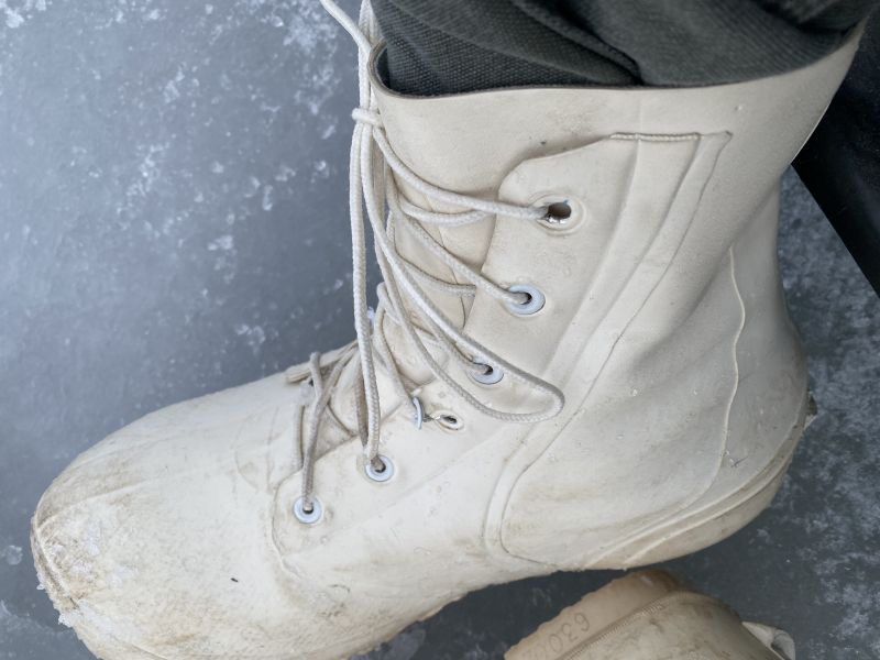

I broke down and bought a brand new pair of the white military boots known as bunny boots. I've had them 2-3 years now and maybe wear them 1-2 days out of the year at most. From pretty much day 1 of wearing them, the eyelets have failed. There's probably a total of 6 or 7 of them that have separated from the boot.
Well i went ice fishing this weekend and wore these. Unfortunately while securing them on, 2 more eyelets popped out and when 1 of them did i actually pulled the lace through the boot tearing it.
So what are my options? Do they make a "heavy duty" eyelet kit i can get on amazon? Instead of eyelets, can i get the d-ring style that can either utilize the old eyelet hole or for the bad ones i can punch a new hole? I've always felt like i could never tighten these boots properly...i know they are new and still stiff, but i should be able to tighten them better.

Above the instep area stop running thru the holes, just run the lace behind the boot from each side and wrap on up toward the top and tie in a bow. You may have to put on longer laces. To keep the laces at the top you might have to use the top holes each side.
This is kind of a modified mukluc lacing and lots easier/faster than using all those holes.
This lets you get the part around your foot snugged down but dont overdo that, you want that foot to breath, and the top just needs to be pulled in enough to not flop around.

I think you can replace the eyelets with grommets. Maybe get a grommet kit, and make sure you measure and test it on fabric first. I'm not sure if it's too thick or not but it's worth a try.

I have this exact same problem! I tried the grommet kit and it failed horribly. The rubber is just too thick to get a good seal around the metal. If you had a tool to pinch the grommet instead of hammer it, it may be easier, but steel grommets would be ideal.
I like the idea of wrapping the laces and just using the top two holes to hold the laces up, I suppose by inserting the laces backwards through them so no tension is put on the rubber eyelets.
If that fails, I may try and rubber cement some heavy duty velcro to each side and use that for the top section.

Bring your boots to a real shoemaker ,a real hockey repair store or a leather goods repair place ,they have the good stuff and can do the job right ,about $1.00 per rivet .
