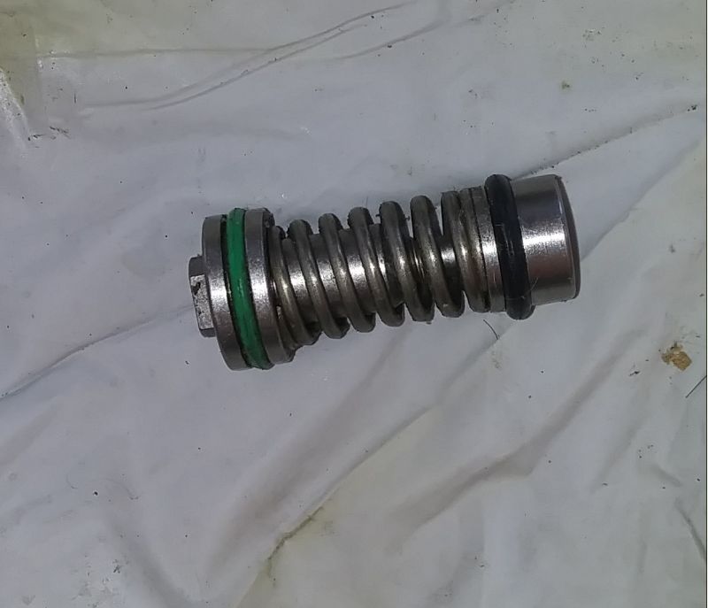

You have a stuck "unloader valve" common deal, on the pump you will see a cap with a spring under it, and a relief valve, it gets hung up, usually from corrosion from water setting. You can buy an unloader valve kit. My pump is a generac with a honda engine, but my unloader valve kit I got was made by Briggs and Stratton. Anyway, when you winterize it, just pull it apart and lube everything in there before storing it. They make a fog kit for them also.
Lots of styles:
Mine was this one:

I've had that valve out a dozen times, changed the O-rings. It's not a valve per se, slides in a bore to open holes to the wand and back to pump. Run out of things to try.

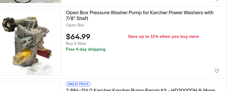

New pumps for $70 on Ebay, cheap enough, I just don't need another pressure washer and that Honda engine looks pretty tempting. I think I'll just push it in the shed and wait until some need comes up.

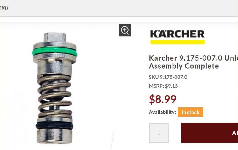

It's a Karcher, and is what they call it. The only other parts in it are the rubber inlet valves.
The way I understand it is the inlet pressure pushes the unloader valve open to recirculate, and when the trigger is opened, relieving pressure, the spring closes the valve, sending the water to the wand.

I used to own a Karcher service centre. That was a very common problem, you will find that if you take the nozzle off and run it for a few seconds then replace the nozzle it will work until you release the trigger again. A good waterproof grease will get it working for a little while. They actually made a repair kit for them that replaced the part the unloader (karcher calls it a spill valve) valve slides in. It worked a bit better but wasn't worth the money.

Paulz, OK, looks like it is the unloader according to them. A good silicone based grease to keep it lubed. When my would fail, I would hold the nozzle open, throttle down the engine and it would pressure up, while keeping the trigger pulled, then throttle engine back up, would work, but each time I let off, had to throttle engine back down. I now store it cleaned and lubed. Briggs and Stratton actually makes a fogger kit for this, in an aerosol can for storage

Thanks guys. Al, good to know it was a common issue. Well I tried greasing the valve up real good, slides right in, tired with and without the nozzle, varying the throttle.. nothing worked. Funny that it did kick in the very first time I tried it, so I know it's capable of working. Leaving the valve out would just allow the water to recirculate I believe, as it does when the trigger is off and not spraying.
I see the new pumps they sell on Ebay have a different, probably later design, looks like they would bolt up. For now though I think I'll just push it in the corner in case mine takes a dump. And if not, that Honda looks pretty tempting to replace the old iron Briggs in the log splitter.

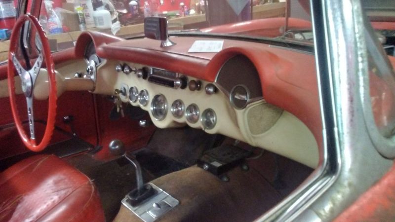

I'm back at the cabin, didn't bring the washer but here's what I've been playing with out here. Rebuilt the trans, waiting on a new throwout bearing.
# Posted: 17 Jun 2021 08:03am
Wow, what year and do I see dual quads?
3 or 4 spd? 327?
# Posted: 17 Jun 2021 10:09am
Scookums
# Posted: 17 Jun 2021 12:42pm
It's a '56. 265 3spd, top of the line for the year. Got it last year, incredibly, not a mile from my cabin. In a barn since 1974. Been slowly getting it back on the road. I have driven it twice, briefly.
