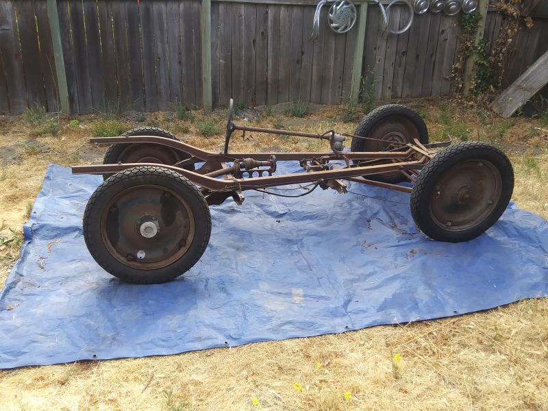

I have this 1930s mini car chassis sitting around. Wheelbase is 75", pretty light, I can lift either end. Steering works, brakes work, rear differential works..
I'd like something to power it around my yard, hopefully even up the hill to the cabin. Alternate energy would be cool. Steam, diesel, Wankel, electric.. don't know. But I know we are a creative bunch around here.
Any ideas?

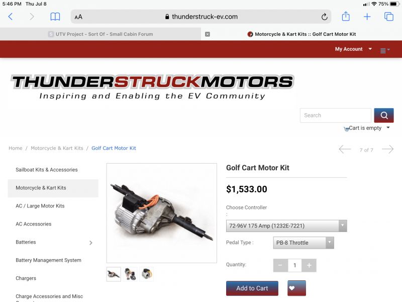

Try this golf cart ev conversion
Ev conversion
Ev conversion

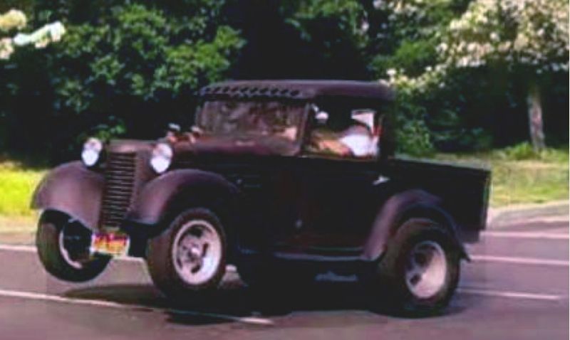

I've done a few wheelies in my Bantam (same frame as above, reinforced) but it's really not strong enough for that treatment and I have other things to do besides fix it.
