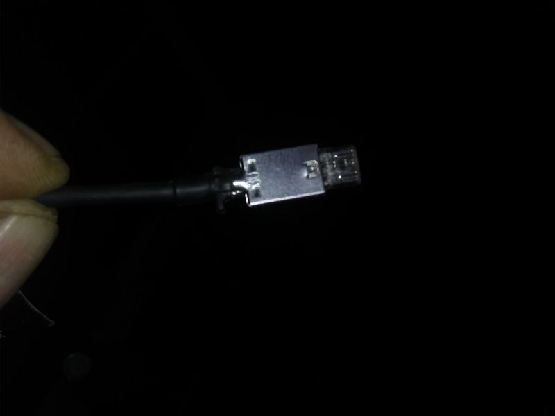

Here's the unit. The good news is, by unplugging everything else one by one, I narrowed it down to a tablet, also plugged in to the same USB hub. Replaced that USB cable, no more static. Here's the old cable, pretty sure the whole end was covered in plastic, maybe it got too hot for some reason. Anyway, good to go, I should have tried it before asking but thanks for the input.

Thanks, and since you mention it..
Upon further pondering: This tablet, a Kindle, I use solely to stream video, my TV if you will. I use an earbud at night. The max volume setting is too low for me, so I downloaded a 'volume booster' app. That works, but every time I turn on the tablet I have to load the booster app, and constantly play with the volume. So instead I got this external amp, which has a convenient volume knob, just like the old days.
Anyway, the volume booster app did have some warning about damaging the tablet, I'm wondering if using it created enough extra heat to damage the old charging cable. Just a guess.
