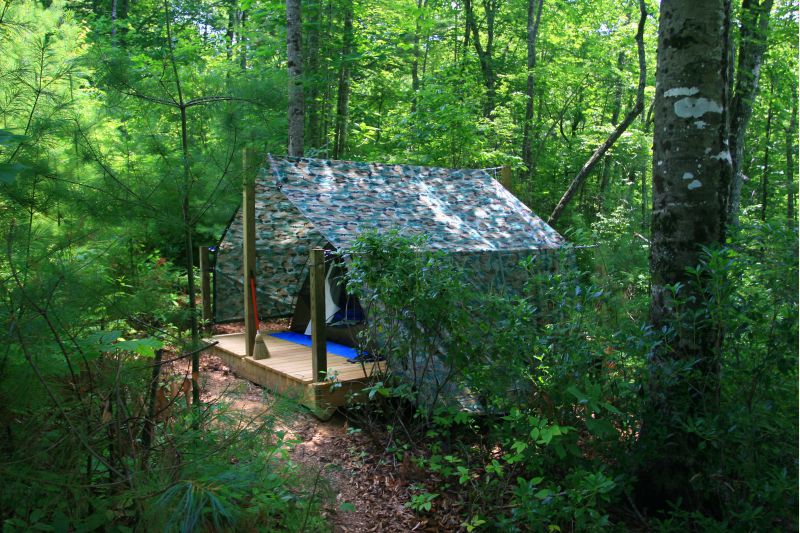

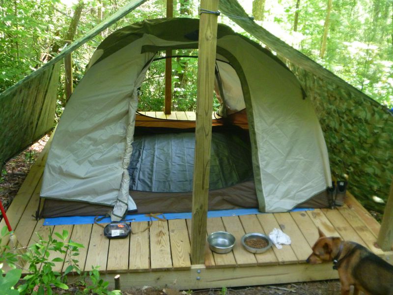

# Posted: 2 Aug 2014 03:13am

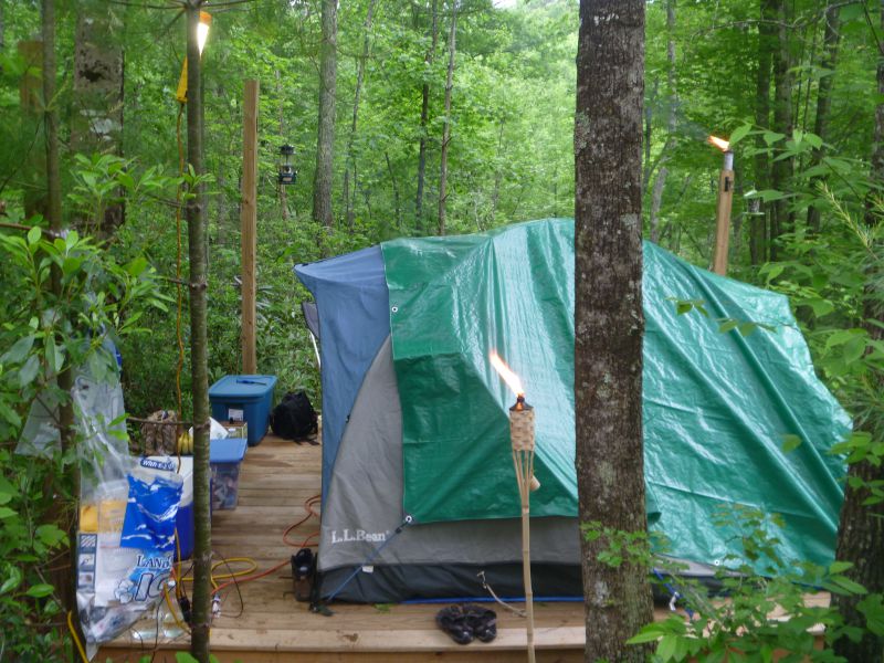

My wife and I own some land in the mountains of Western North Carolina. We love to camp but there wasn't a good level area to pitch a tent. Last year (2013) I decided to build a 12x12 platform. It worked pretty good except our 4 person dome tent was about 8x8 leaving a small area around the tent for cooking, storage containers, the cooler etc. This year I returned and built a seperate 10X12 and outfitted it so we could pitch the tent on it, throw a tarp over it for extra weather protection and use the 12x12 for cooking and lounging when we aren't hiking or exploring the area.
The original 12X12 with tent and chairs

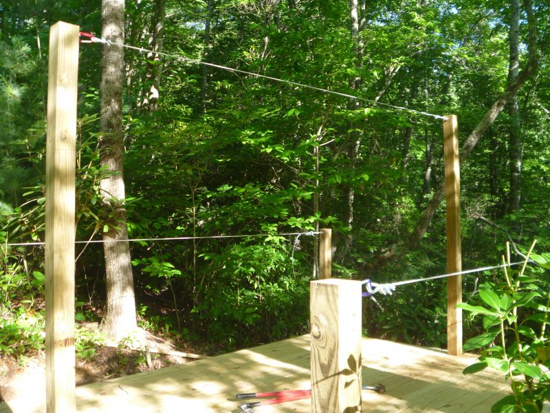

The new 10x12 under construction
10x12 with cables to support the tarp
10x12 with tent and tarp

^Doug, looks great. Love that last photo.

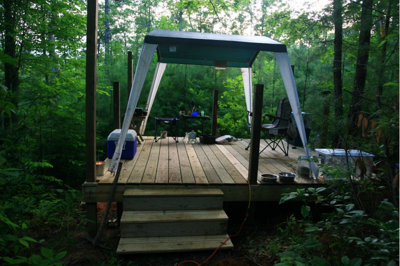

We love it. It's just the wife and I and our two dogs and the 4 person tent gives us plenty of room for our other things like clothes and hiking gear. We even carry along a small DVD player and watch movies at night. For electricity I hook a 12V-110V power inverter to the truck battery, run a 50' extension cord to the camping area. You can't run any big appliances with it but you can use it to power a fluorescent light, DVD player and recharge your cell phone, camera batteries, etc. I have run it all night without running down the battery on the truck but usually turn it off before going to bed.
Just last month I spent a couple of weeks there and got rained on several times to include two days where it rained non stop for about 36 hours. I stayed very dry without a drop of water getting inside the tent. It has made our land much more useable for us. Below I've uploaded some more photos...
The view of the 12X12 from the tent platform.
The 10x12 with the tent and tarp

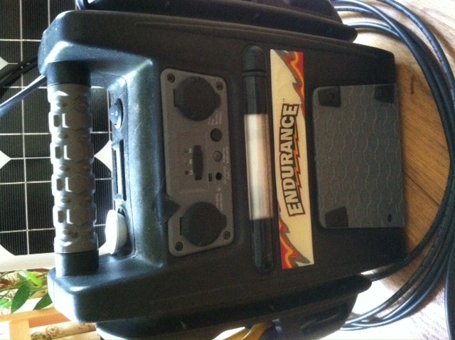

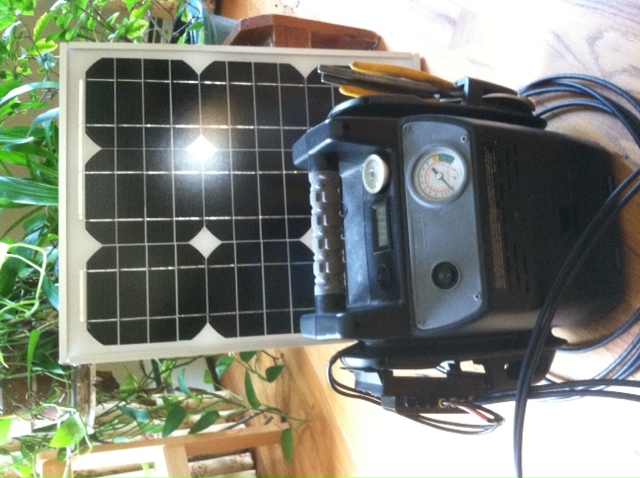

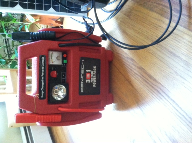

I'd be afraid of a dead battery unless help is close by. I picked up a free power pack/car jumper at a recycling center which had it's jumper cables cut off and replaced the 22ah battery, added a digital voltmeter, led bulb, 12v switch and a sunsaver 6 charger controller and wiring to hook it up to a inexpensive 30w solar panel. It already had two 12 volt sockets and a usb port. This will power a dog fence during the day and a pop-up at night and to charge stuff. Very happy with it so far using it in the pop-up and camping.
With a coupon I bought a harbor freight power pack for less than $40 and like it very much...just the battery I bought for the recycled one cost more. You would be able to use the harbor freight one the same way or just bring it along in case your truck doesn't start or a larger one that's capable of starting it if this one isn't.
Recycled power pack w/30w panel
Recycled power pack 12v plugs & USB port
Added LED, voltmeter and switch
$39 Harbor Freight Power Pack
ChuckDynasty
# Posted: 3 Aug 2014 04:22pm
Sorry the images weren't CC on my computer. Here w/sunsaver 6
